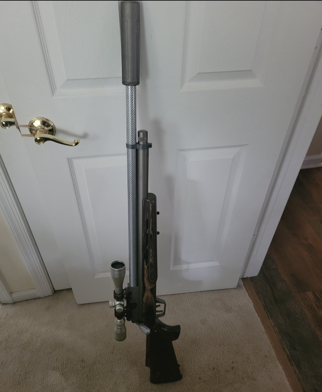

I have a lothar walther barrel and i shoot slugs out of mine and that stock is made for an mrod

Here is the proof

I love it when someone is proven wrong and no answer lol

I just dont understand how someone buy a gun and dont do any research about it first i new everything about the mrod before i bought it what kits were offered what kind of stock were sold and that i could irder it with a lothar walther barrel even the extra large bolt handle to the stailess steel carbon fiber shroud i mean everything evenbthe slugs i was gonna use and your still trying to figure out shot strings well good luck hope all works out for you anything else i can help with let me know
That stock has too low of a comb, it is pretty, but it is too low for a proper cheek weld and eye alignment on that rifle with that scope hiked up high like that. Your posts are so full of horse manure that the entertainment value alone is worth the nonsense endured not to mention the spelling or lack of.
