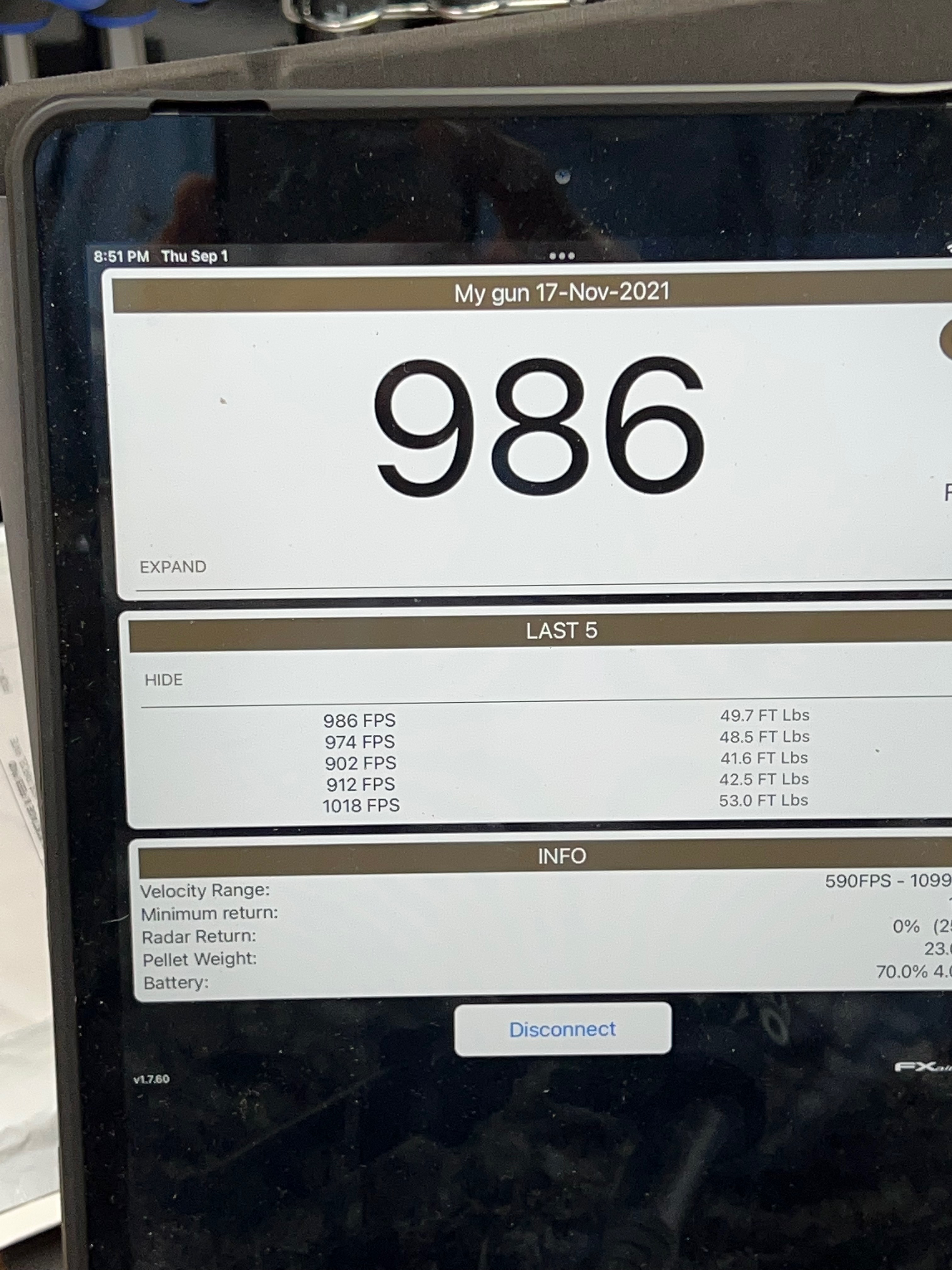

Well i reset the reg and brought the reg up to 105 because when i went above 110 all hell broke loose and everything is fine i can shoot from 610 fps to 920 fpsThat explanation was going to be my suggestion, except when I read your OP, it sounded like you shot over 200 shots without issue until it crashed. If you crank up the regulator, you also wil likely need to crank up the Hammer Spring to compensate for the extra pressure you just gave it.
I curious as to the kind of hell, exactly, that was unleashed above 110 bar?Well i reset the reg and brought the reg up to 105 because when i went above 110 all hell broke loose and everything is fine i can shoot from 610 fps to 920 fps
When I raised the bar to 120 I could only get 700 FPS when I went higher FPS went even lowerI curious as to the kind of hell, exactly, that was unleashed above 110 bar?
