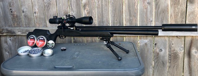

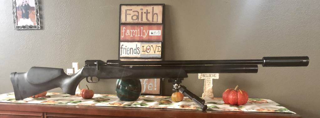

I really like the Streamline. Installed a Huma set to 132 bar, a Power Plenum and custom ported level 1 & 2. Very versatile platform.
Here are the results. He’s gonna be stoked.

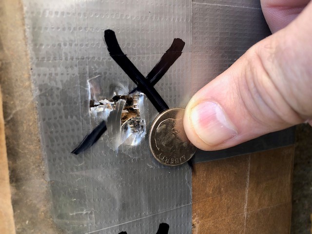

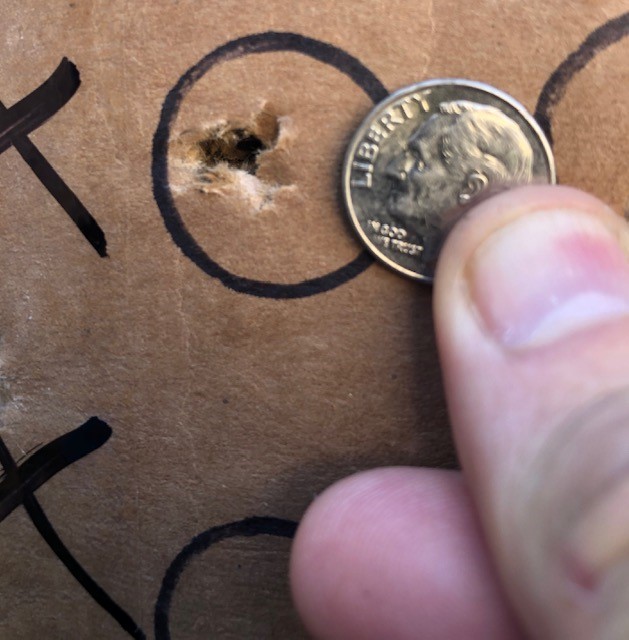

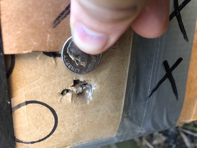

#3 ~ 33.95gr King Heavies - 885 fps 59 FPE
#2 ~ 25.39gr Kings - 895 fps 45 FPE
#1 ~ 20.06gr H&N FTTÂ - 845 fps 32 FPE or 16.54 gr GTO - 920 fps 31 FPE
