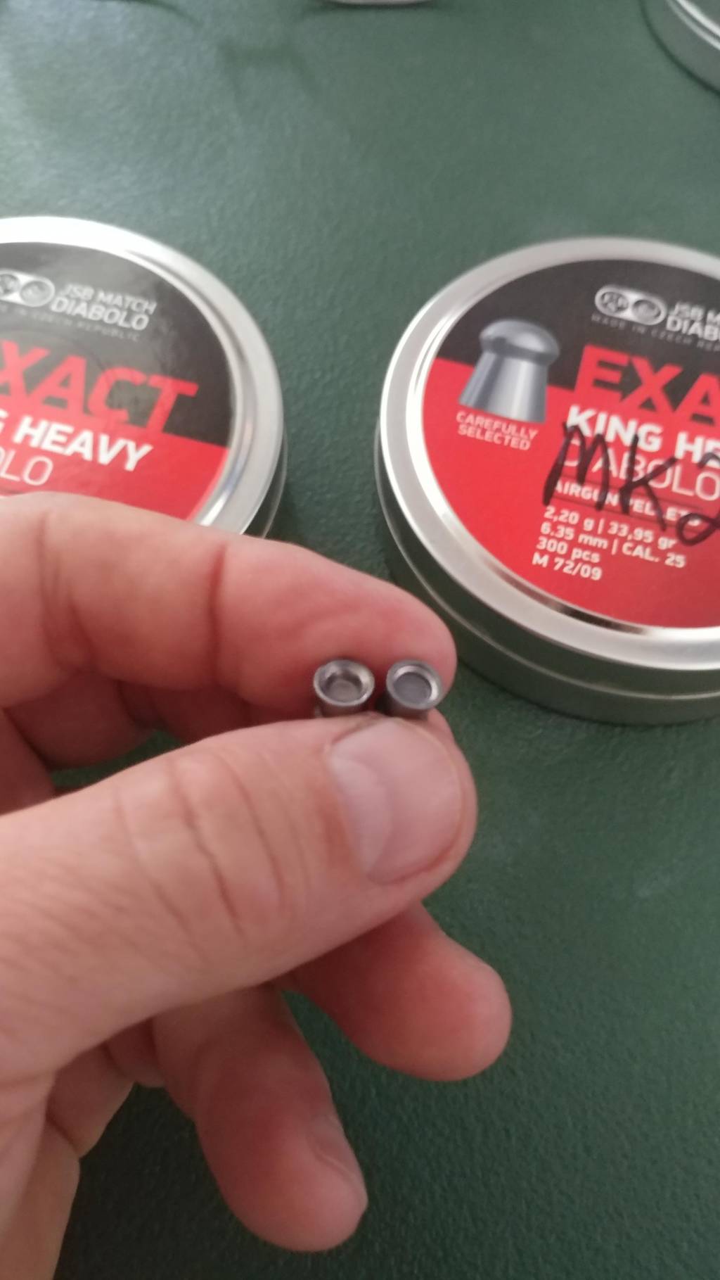

Last year, I purchased several tins of each(.25 JSB King Heavy AND .25 JSB King Heavy MKII)from 2 different large airgun companies. They ALL had the MKII pellets(shallow cavity/thick skirt) inside the tins, no matter what they were marked! Not that one is BETTER than the other, but they shoot markedly different. No one seems to know the difference or care?
I just examined mine and I have seven 300ct. tins with a red sticker on the back with what might be the lot number. These are all King Heavy as marked on the lid. I have three 300ct. marked King Heavy, but are MK 2. These tins have a white label with a bar code on the back. The MK 2 300ct. tins have the white label with a different bar code. I have two 150ct. tins of King Heavy with a bar code that are King Heavy.
.25 JSB King Heavy on left(deep cavity/thin skirt)
.25 JSB King Heavy MKII on right(shallow cavity/thick skirt)
Thanks Phil. It’s super obvious when you hold them side by side and even more obvious when you shoot them. Yesterday i shot the .25 Cricket2 with Mk2 885 FPS at 50 yards and couldn’t keep it inside a quarter. Shot a magazine of King Heavy Mk1 and it stacked all ten easily inside a dime. Night and day. lol...
