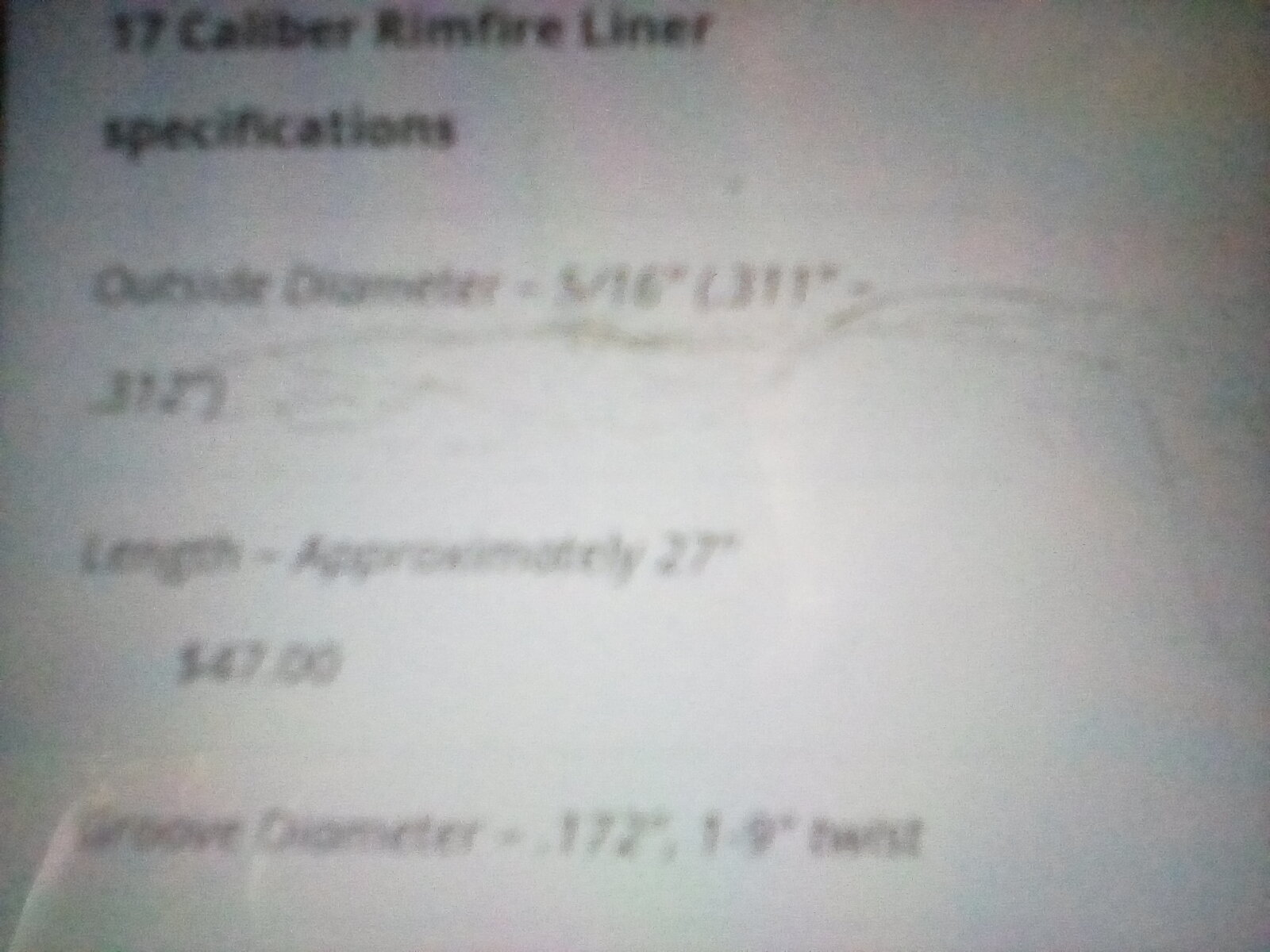

Check out Redman Gun Barrel liners...They have .172 liner with 9 twist standard..25 inch finished price $50.00..They have 9 twist .223 barrels also...$50.00... They barrels are sold through brownells too...only .223 16 twist for$38.00 and $10.00 shipping.... Two barrels for$100.00 dollars cheaper than airgun slugs . I think you could sleeve pretty easy with 12 mil outside and 8 mil inside carbon fiber sleeve... Put factory 12 mil Airforce bushing on top of sleeve...
