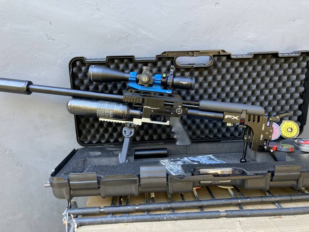

Put the gun together today, shifted from .30 caliber to .25 caliber, 700mm Slug A liner with FX Power Plenum upgrade to Impact X. Installed Ernest dual transfer port, FX Slug Power pin probe set to push slug in as far as possible. Increased reg pressure to 120 bar. Took up all tension when power wheel on MAX. Valve adjust on 3rd line.
Shooting NSA 36.2 grain slugs at 960 FPS with power wheel on "MAX". Shooting JSB Heavy 34 grain pellets at 905 FPS with power wheel on "3". Looks like I can easily go much higher than the current 75 FPE setting, but gun isn't stressed at all and is still easy to shoot, feels like its just coasting... Will take out this weekend to tune for accuracy and try other weight NSA slugs. I have the 38.5 and 43.5 to try yet. More to follow...
My goal is to basically have an air powered .22 LR that I can reach out and “touch” the ground squirrels east of San Diego at up to 250, maybe 300 yards...
PS., thanks to @biohazardman and @justweld and everyone above for their tuning recommendations
PPS. If you look at the photo right side you can see the slug magazine inserts that @orion makes and sells here on AGN and on his own web site. Mine are yellow and red, and they work great.
https://www.airgunnation.com/topic/wts-fx-impact-magazine-replacement-feeder-to-fix-slug-issue/
