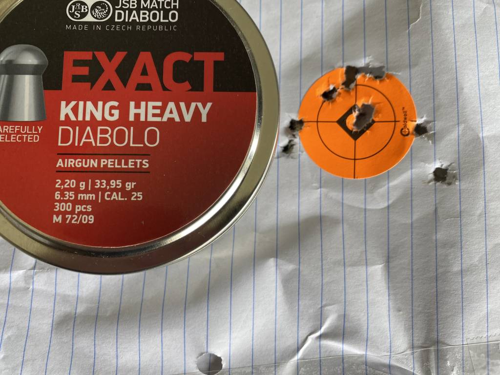

The King Heavy shoot well for me @ 100 yards (10shots). I have not tried the MK2 version in my 700mm impact. Which version shoots best out of your STX?

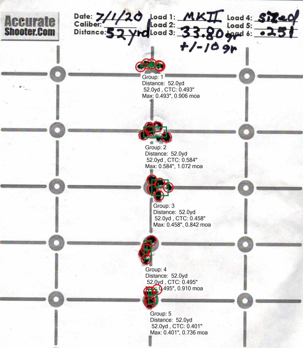

I’ve been looking at this for months. A while back JSB screwed up and put Mk1 in Mk2 tins, which made it even more confusing.
The Mk1s have a significantly deeper cavity, thinner skirt and skirt is slightly larger in diameter. The Mk2 has a shallower cavity and thicker skirt. The FX brand heavies are Mk2.
From what I can gather, the .25 Pellet A liner was designed to shoot the Mi2 which is why the FX pellets are Mk2. In my .25 Impact with Slug A liner the gun like the Mk1s better which is also what Ted discovered in his video.
I may have forgot which one had the thicker skirts. I ran out of MKIs a good while ago and only have been shooting the MKIIs. I wonder now which ones are better overall. I don't see a detectable difference between my STX and my Superior in .25 cal. shooting JSBs. Only when shooting slugs does the Superior shine more.
I know in .30 cal my STX standard shoots JSBs a lot better than the Slug A does.
