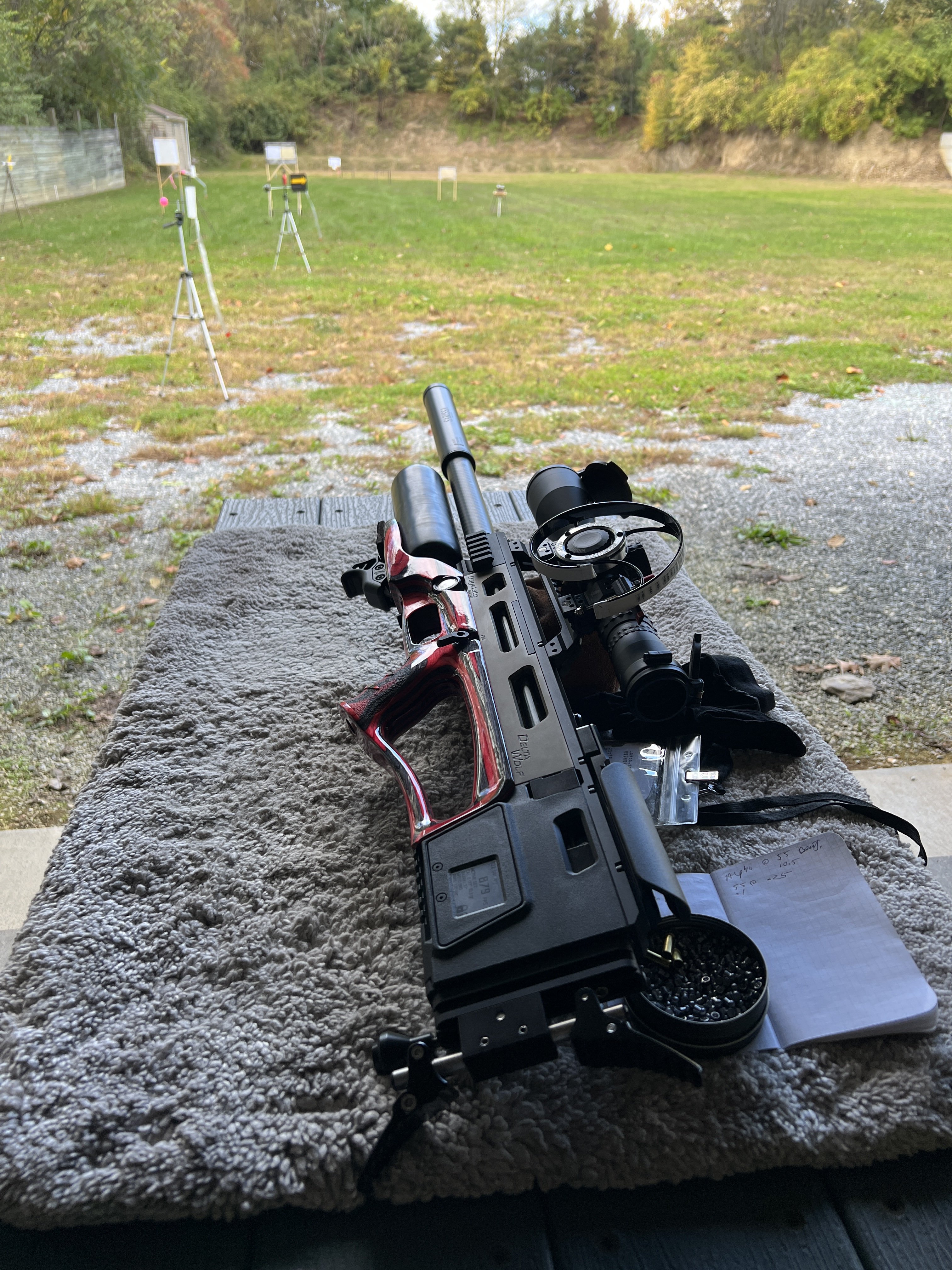

This STO .30 high flow moderator on my Alphawolf .177 shooting 10.3’s at 890 is fffft quiet but same mod on the same gun pushing a 44.75 @ 890 is gonna make a good crack
