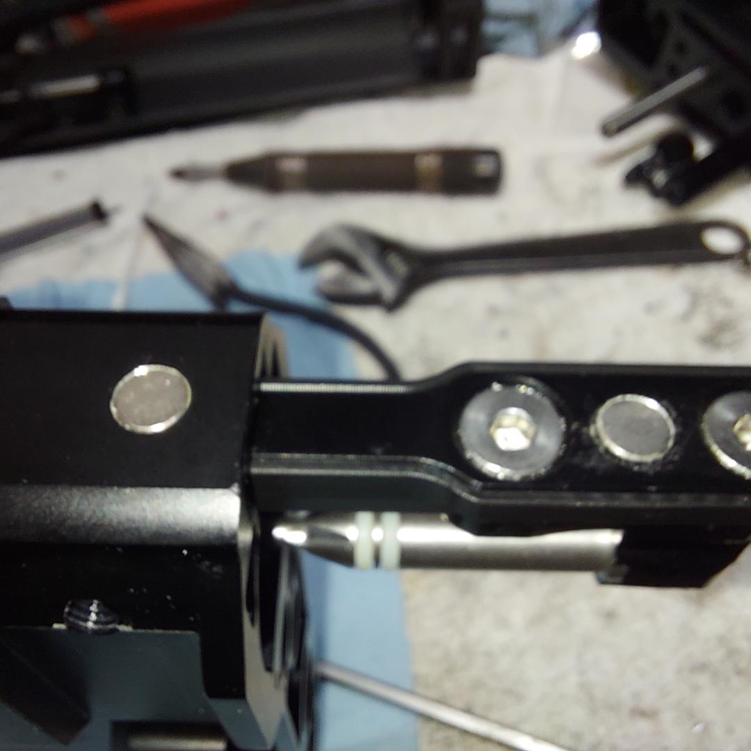

Skout has been great about addressing and correcting issues. I’d say by now most issues are updated in the latest production runs. My last wish is to have something that holds the cocking arm back when cocking like a magnet or ball detent. That’s a big deal for PRS but not for most other things
Showed you "How Too" on that one ... It is not that difficult to do the simple modification ;)
Reactions: Centercut
Yes, gotcha. That was another hint to Skout to institute an improvement to the Epoch. Do I need a bottoming drill for that?
I just spot drilled at @ .220" and using a 1/4" ( .250" ) 4 flute end mill by hand, made the hole @ .120" deep creating a corner/shoulder to hold the depth of magnet which was CA glued into place. Assembled the magnets don't touch, but pass over one another very close.

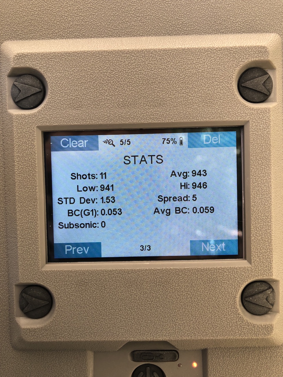

I did some trial and error this past week with the Gold Skout. I had been close to 960 fps but slowed it down a bit to the low 940s. Better consistency and down range accuracy. It likes the .25 Heavy Daystate Rangemaster pellets the best.
HP right around 1800 psi, LP at 170 ish. Dwell at 25 microseconds.

Good to know. I still need to try much lower like 860 to 880 fps to see how it does at that speed. I normally do that but everyone that has competed with the .25 was saying 960 ish so I started there.
I noticed at 940 ish my groups tightened up compared to 960+ and actually shot a 230 ish EBR card is swirly winds.
Reactions: Smok3y
