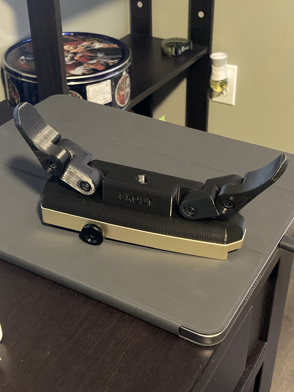

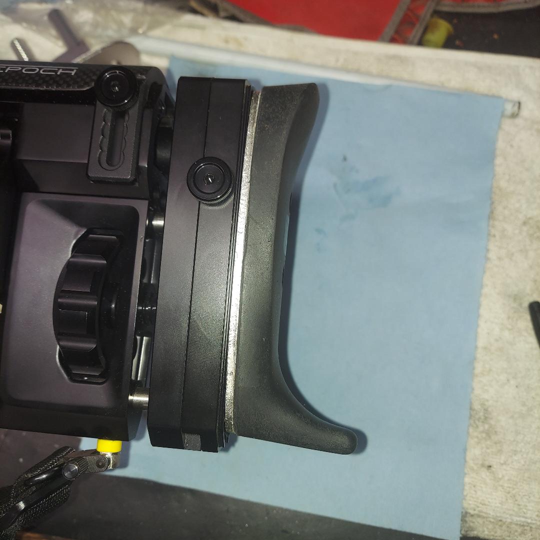

I worked with Andy @NAIAD001 to get a decent butt piece for my Skout so that I could “get it off the bench” and shoot EFT. I sent the factory butt pad and mounting piece to him, and he did an excellent job. Perfect fit. It allows the same adjustments as the factory butt pad. I removed the wing extensions since I like a tight fit on my shoulder. Last photo shows the butt hook with wing extensions.
HIGHLY RECOMMENDED! Great job Andy!!!
Butt hook without wing extensions
Butt hook on Skout Epoch
Butt hook and adaptor plate with wing extensions.

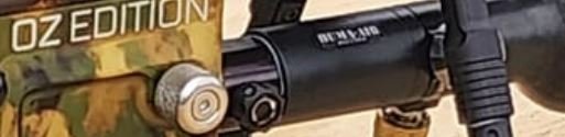

" Yes I bought a bottle reg from huma air so I set that to 2900psi to give the skout reg a little less pressure"
FB
FB OP .25^ (posted nice groups at 50 and 100 M)
I’ve heard of that, but it’s helping the symptoms, not the cause. Not a huge fan of bandaids.
