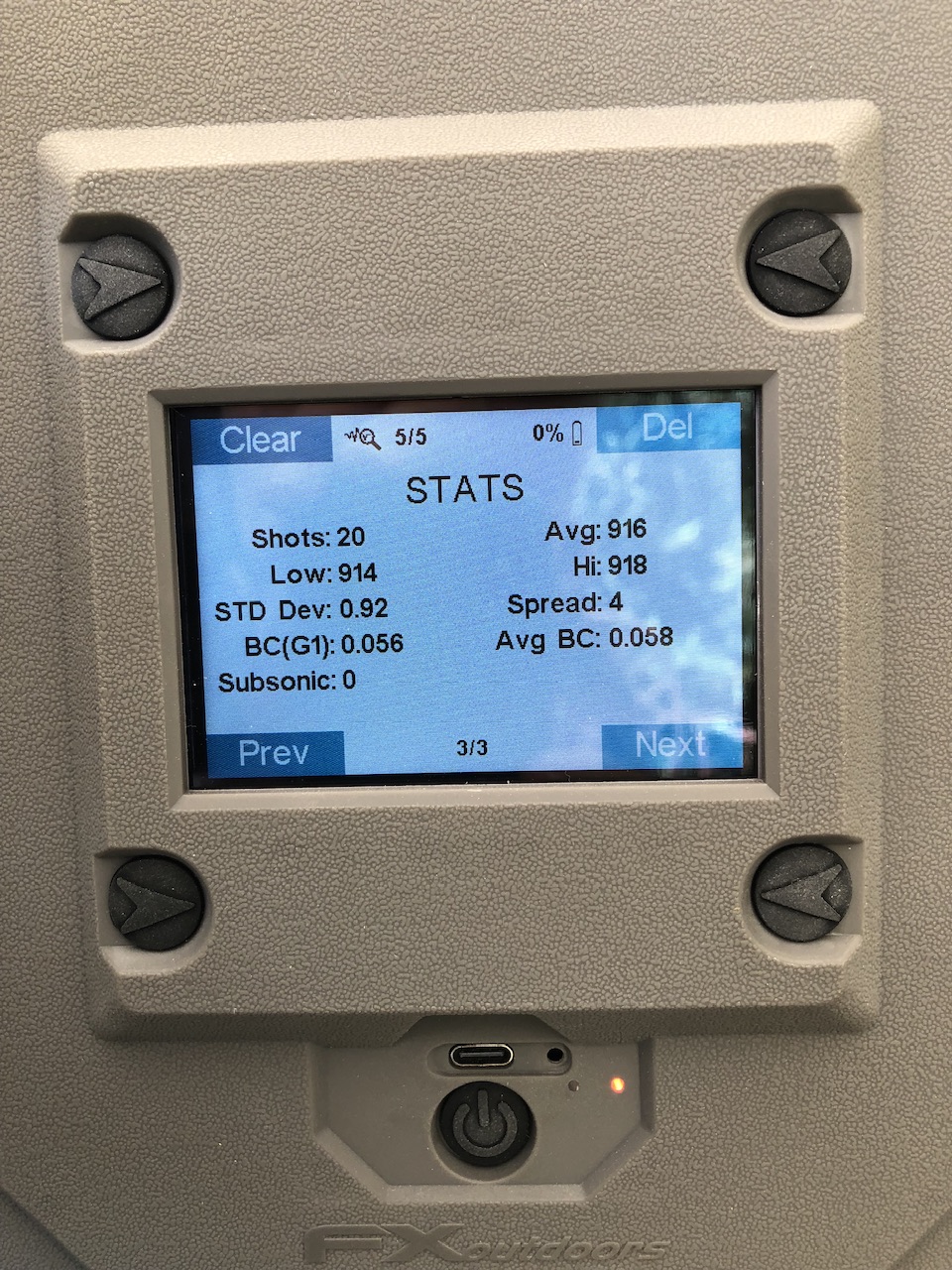

.25 JTS 34 grain at 916 fps. ES and SD looking very good. Accuracy was hard to tell today since it was very windy and swirling direction by the second. Will give the shooting for score a try when winds are not so crazy….
Is that with the long or short barrel? My SD with the long barrel is 2-3 I believe, with original o-rings in regs.
