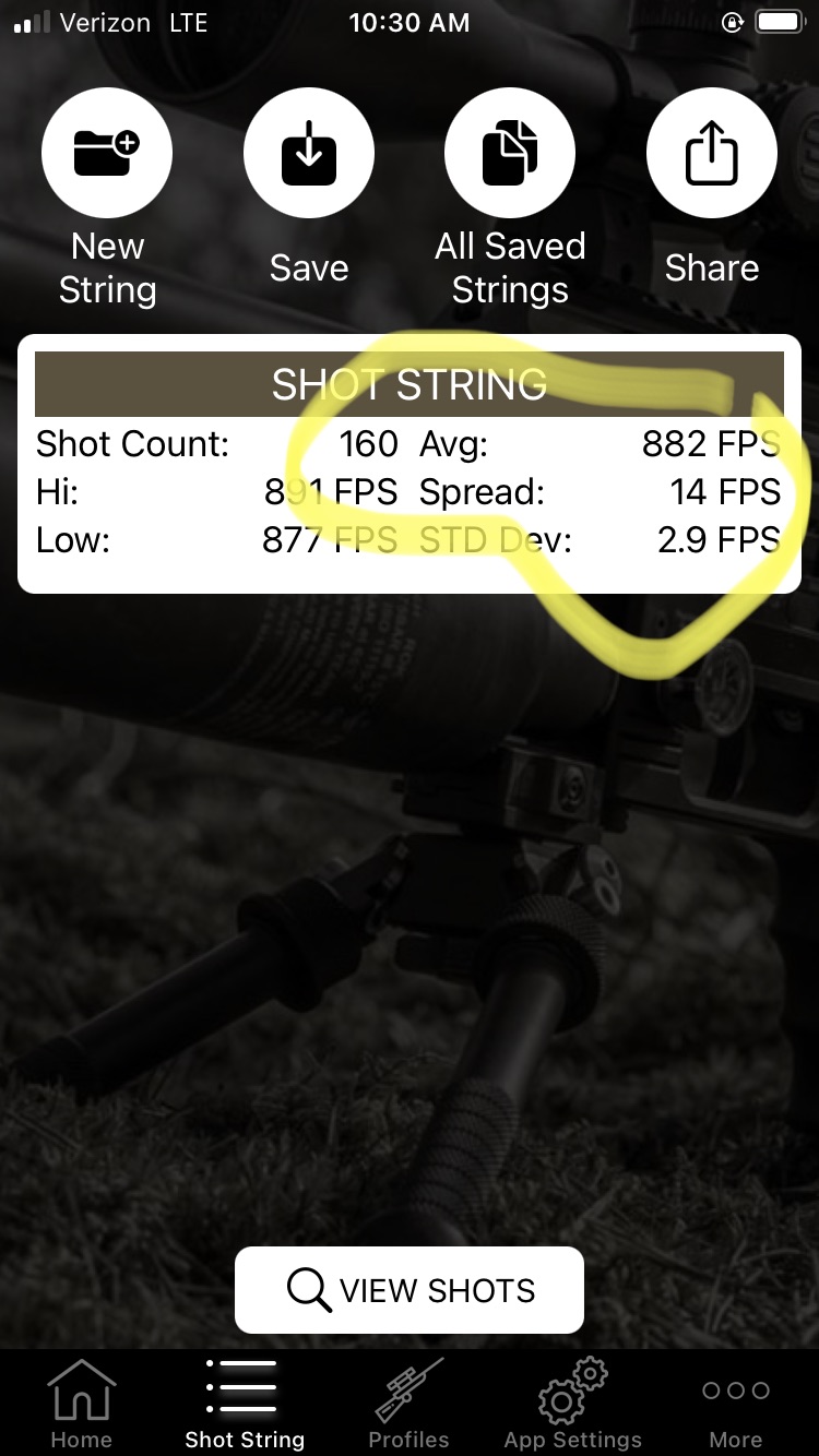

Yeah, I depressirize my rig religiously after each use, bottle valve closed and bleed knob left loose after bleeding the action. I’ve found this Skout to be a “procedures to follow” type of gun, a series of steps that I follow.
The other day while performing tests I didn’t pay much attention to my fx chrono that I had left on, as my attention was more focused on testing for accuracy and as far as I was concerned, my tune was good and done.
When it came time to put things away, that’s when I noticed this shot string
This Skout is truly unbelievable in its performance. It keeps getting better with each passing day, for me anyway
What is your tune on this string? HP, LP and Dwell settings. That's pretty solid.
