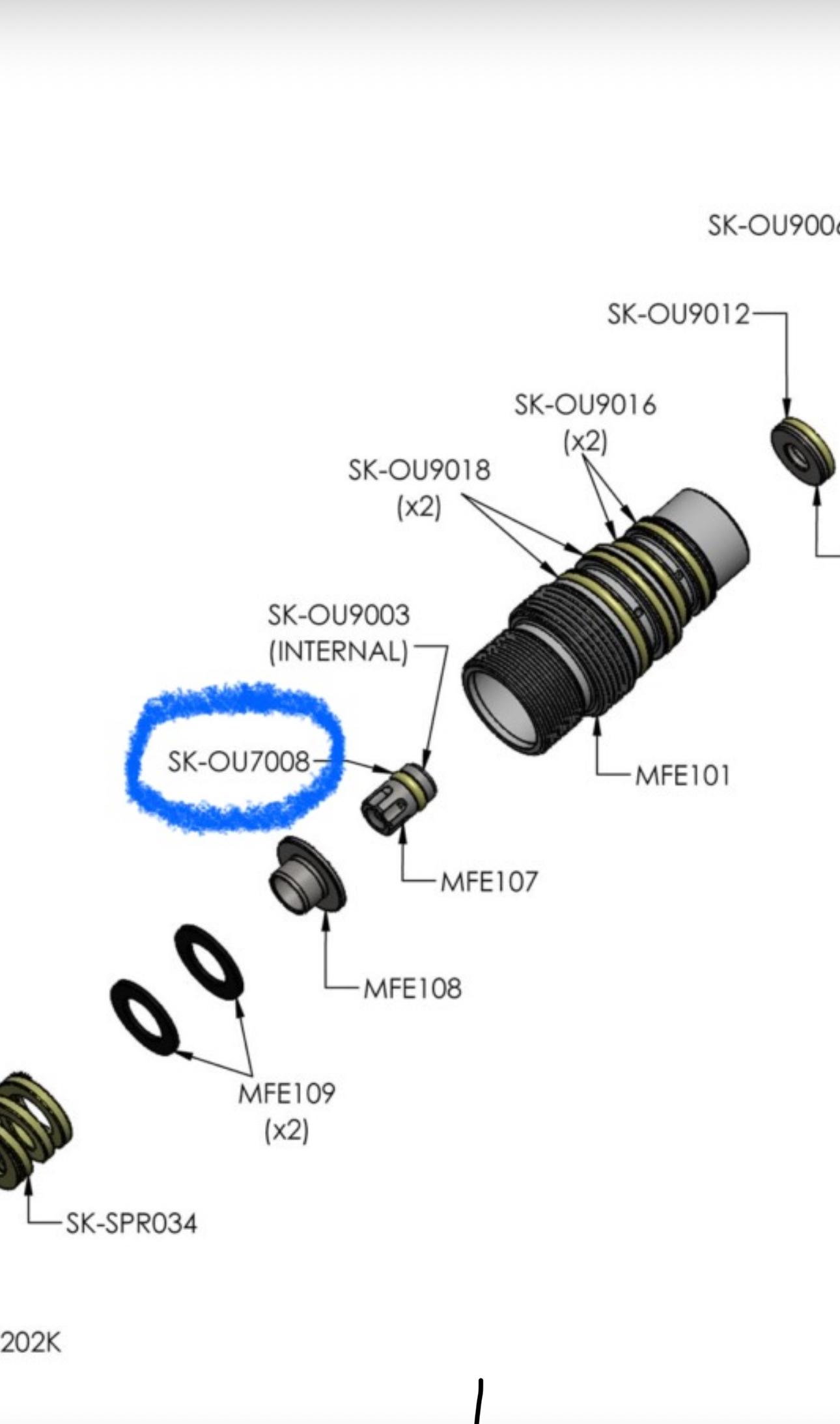

I have never had air leaking out of both regulators on a fill. I have before had air leaking on the HP reg because I believe an O ring lets some air slip out before it can balance its self.
I replaced the o ring on this part of my HP regulator with an 90 hardness and I haven’t had a problem since.

I would try backing the high-pressure regulator so it’s completely off and then try your fill. Once it’s filled then start turning your high-pressure regular back on slowing and see what that does.

I removed the tiny cylindrical seal in the LP - basically to stop being a regulator/ zero air in it.
I turned the bottle on....yes, no air showing on the LP gauge.
I started filling the gun...and no leaks all the way to 200 bar....There is something I am not understanding here!
Keep in mind that I have two HP regs and both are exhibiting the same behaviour
OK, I think I got it licked
The problem is the choice of material and diameter of the VRG 106 (L.P) . This seal deforms over time, and certainly the condition in may case.
Although the mating faces did look clean and undamaged, the side view will show a bulging of the material at either end.
Had you made it a tight fit and made from 90 Shore, that would have stopped the issue.
In the mean time, I added a washer behind this seal as I do not have a replacement in my spares box.
This item did not seal well, so the LP crept up, and when this LP is high, the HP starts to vent . So it wasn't the HP venting when certain fill pressure is reached, it was the continuous creep of the LP as the fill pressure went up, leading to the HP venting.

Even with replacing the VRG 106 (L.P) that I got today, along with the the associated assembly...still no luck, exactly the same issue...:eek::eek::eek::eek:
Try replacing the Oring that I mentioned above.
you can order them on Amazon.
here’s the link https://a.co/d/f2JWcQl
I still think it’s a deforming issue because the O-ring that was used was a softer one and I think it’s because one , air is slipping around this O-ring and 2, because it’s softer it also deforms after a while, making the problem sometimes worse.
