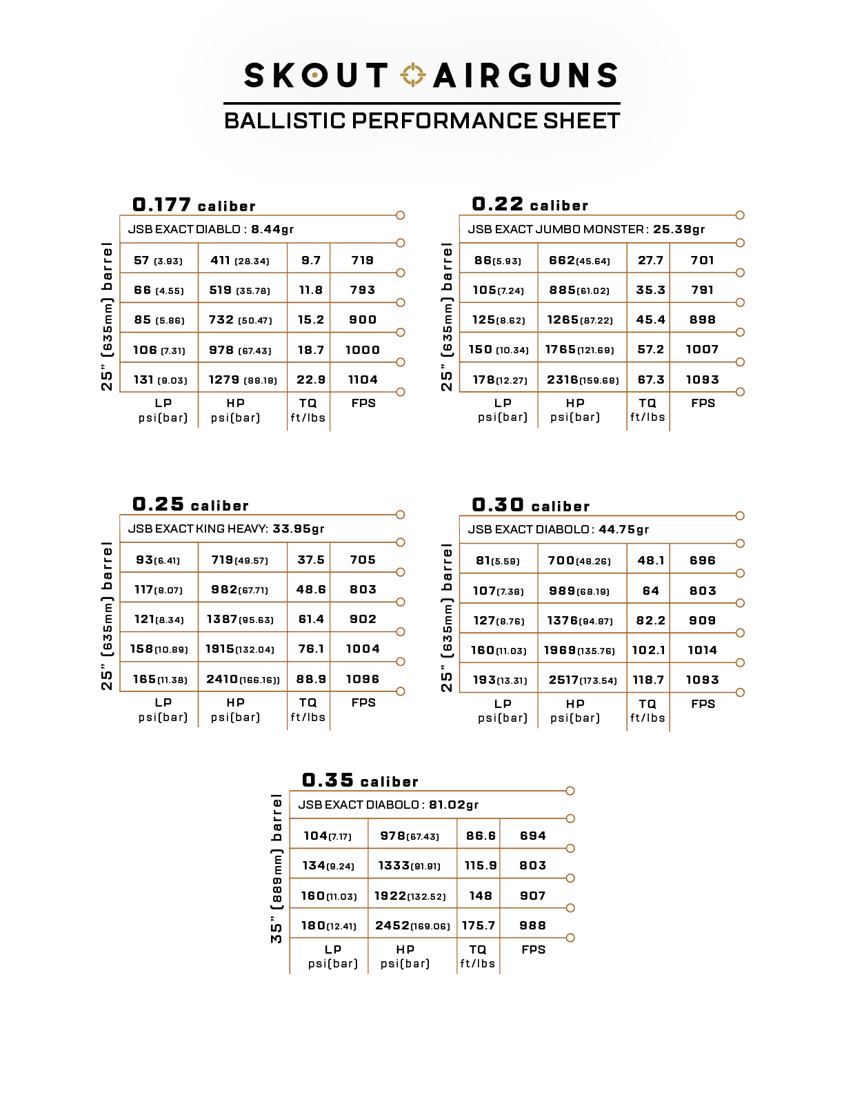

Your charts above have two columns, LP and HP. Do your rifles have two regulators and does the chart reflect the pressures for each regulator to yield the velocity outputs listed in the far right column?
Too elaborate further ..
The LP reg is strictly controlling the pressure for the solenoid valve that controls the spool valve opening.
The HP reg strictly controls the pressure within plenum for each shot.
Generally as one increases or decreases HP setting the LP setting follows along also going up or down & in most situations / settings.
The LP does not need to be changed once set for the most part.
* Only found if changing the electronic dwell substantially from #23 default may further LP changes yield any desirable difference.

Scott, I understand the plenum pressure and its relation to power and operations. But the LP valve seems like if it operated properly, the pressure of that reducer should work across various HP settings. What is the benefit to changing the LP reg pressure? On the Skout that I have, a .25 caliber 25-inch barrel, the HP is at 1600psi and the LP is at 190psi. That results in about 920 fps with 34 grain King Heavy Mk2, and very good accuracy.
In a spool valve ... it is JUST pressure differential on the sealed piston end of the valve that creates the spool to shift from closed to open. Higher the LP is set, more abrupt or violent the spool moves and a tad longer it takes for the bleed hole in poppet head to get the piston to get closed. At 1600 on HP, would think you needing no more than @ 130/140 on LP.

Here is some information regarding the speeds and power you can expect from the 25" barrel on the gun. You can achieve higher outputs from the long barrel. Right now we only have pellet barrels available. The stock guns come with the standard valve installed, but we do offer the higher power valve as an accessory item! If you have any questions let me know!

yes, I recommend trying dwell settings from 25-32 shooting around 930-950 fps. LP should be around 150psi, and I recommend shooting the JSB 33.95 gr MKII pellets. do you have a 35" kit with 3 liners or 1 liner?

To get LP to around 150 PSI I'll have to adjust it separately from HP because if I crank HP so far high that LP get to 150 PSI it will shoot well over 1100 FPS. I have no problem in cranking LP up separately, I was just under impression that it shouldn't be done since adjusting HP moves LP along with itself.
Factory settings was HP 1700 PSI, LP 170 PSI but that was with 25" barrels. In the meantime I bought 35" barrel kit and to shoot 930 FPS, HP needs to be lowered to about 1450 PSI, which in return lowers LP to around 130 PSI.
