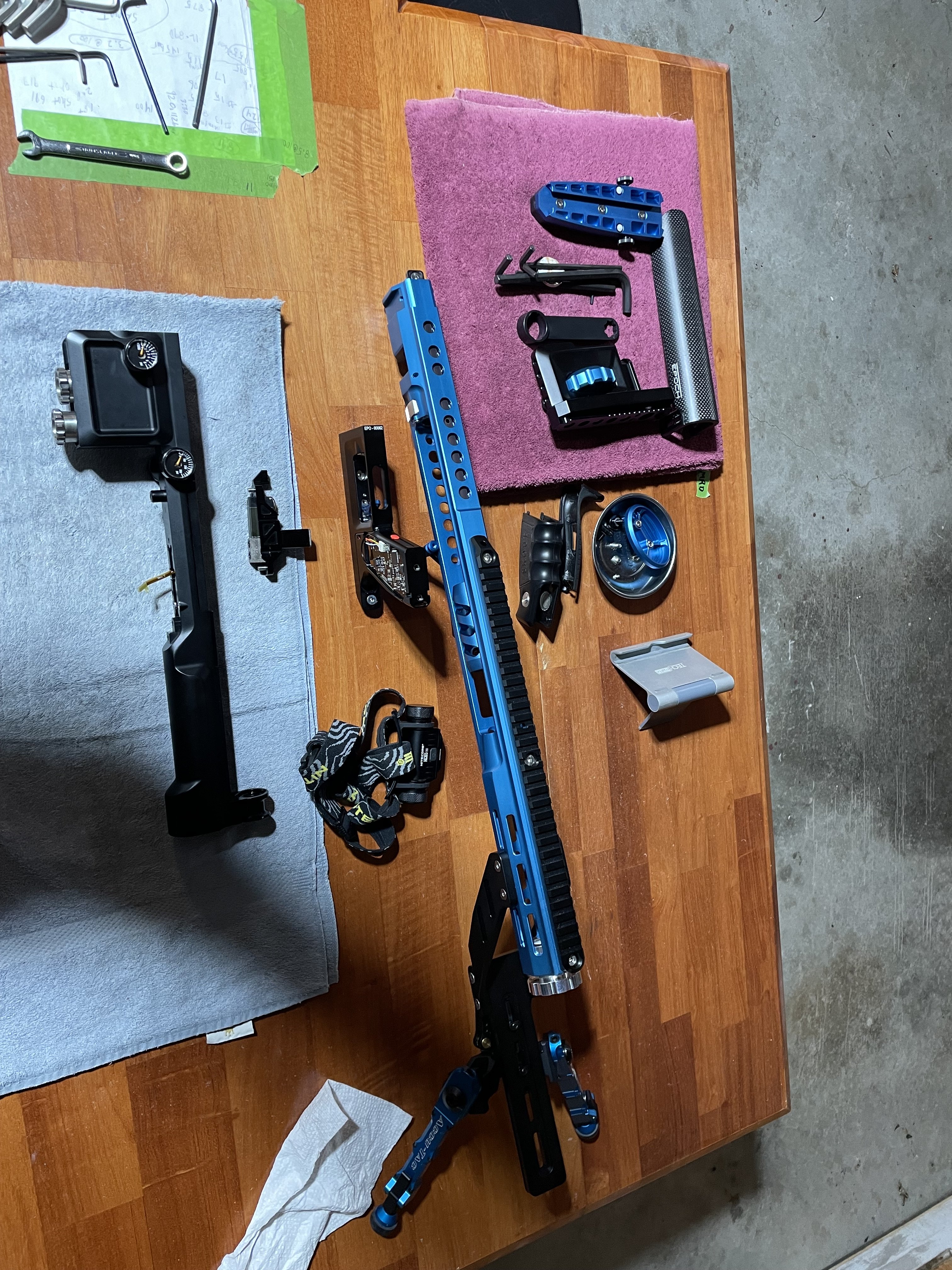

I DMd with @Scotty1 and he told me when he had recurrent issues with his Skout decided to send him a lower assembly that contains the reg, valve, gauges, etc. Looks like a fairly easy job and Skout has videos on line for step by step. Here’s his photo of the gun disassembled to replace the lower assembly (the black unit on the left in the photo). So I’ll talk to Darryl next week about that. Much better than sending the gun in, and after replacement I send them my faulty lower assembly.

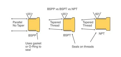

I have a good friend that has a Skout on the way. He asked me about the threads on the three gauges on the Epoch. All three of mine are BSP (parallel) threads. He told me he asked Skout and was told they are NPT (tapered). Not sure about others, but I am 💯 percent sure mine are parallel threads. Oddly enough, they were installed like you would do NPT threads with LOTS of black sealant tape (Teflon?) and no oring or Delrin gasket at the base. Things that make you go hmmm…. 😉

Hi mike, it may feel like they are parallel threads, but I can assure you they are not. BSPP and NPT theads are close enough in pitch to easily be mistaken for each other. I just checked here and a BSPP gauge will thread in, but for the first few threads it is a looser fit, and then gets tighter near the end. For the record Skout does not recommend trying to use anything BSPP on the Epoch. All gauge ports as well as fill nipple and bleeder valve ports are 1/8-27 NPT threaded.
