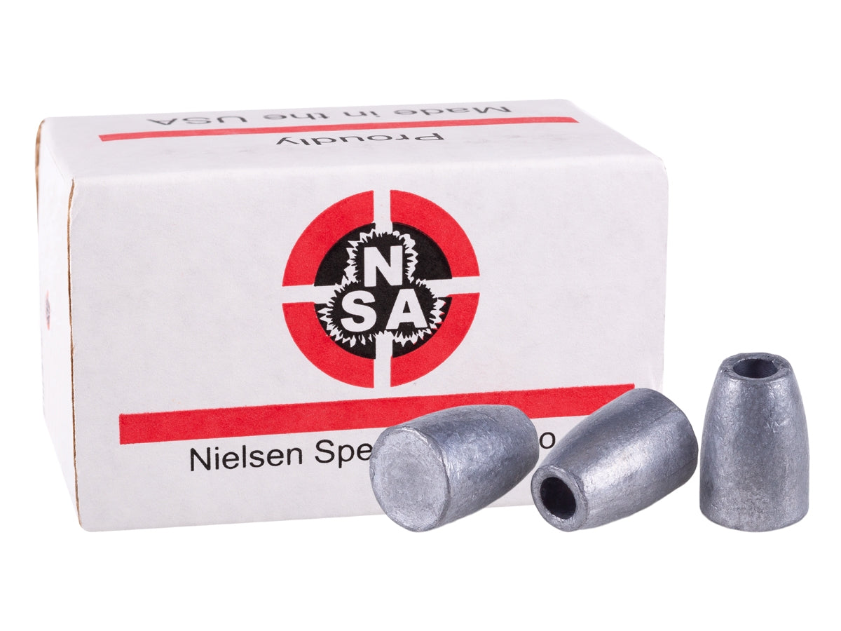

Did you buy the wrong NSA .25 slugs? on the 38.5 slug you can choose .254 which is the correct size for the GK1
I have heard that these work fine with the GK1 .25. I just ordered my GK1 .25 and am likely purchasing these slugs and also the JSB 33..95 as my pellet ammo. I know others like the JSB Exact 25..39 and JSB Hades Match 26.54 for pellets.

I know you tried NSA but you must not have used the right size, which should be their .254 - 38.5 gr slug. They are $17.99 for 200 slugs. I have read that others found that they shoot well with the GK1 so I think you should consider those as well.

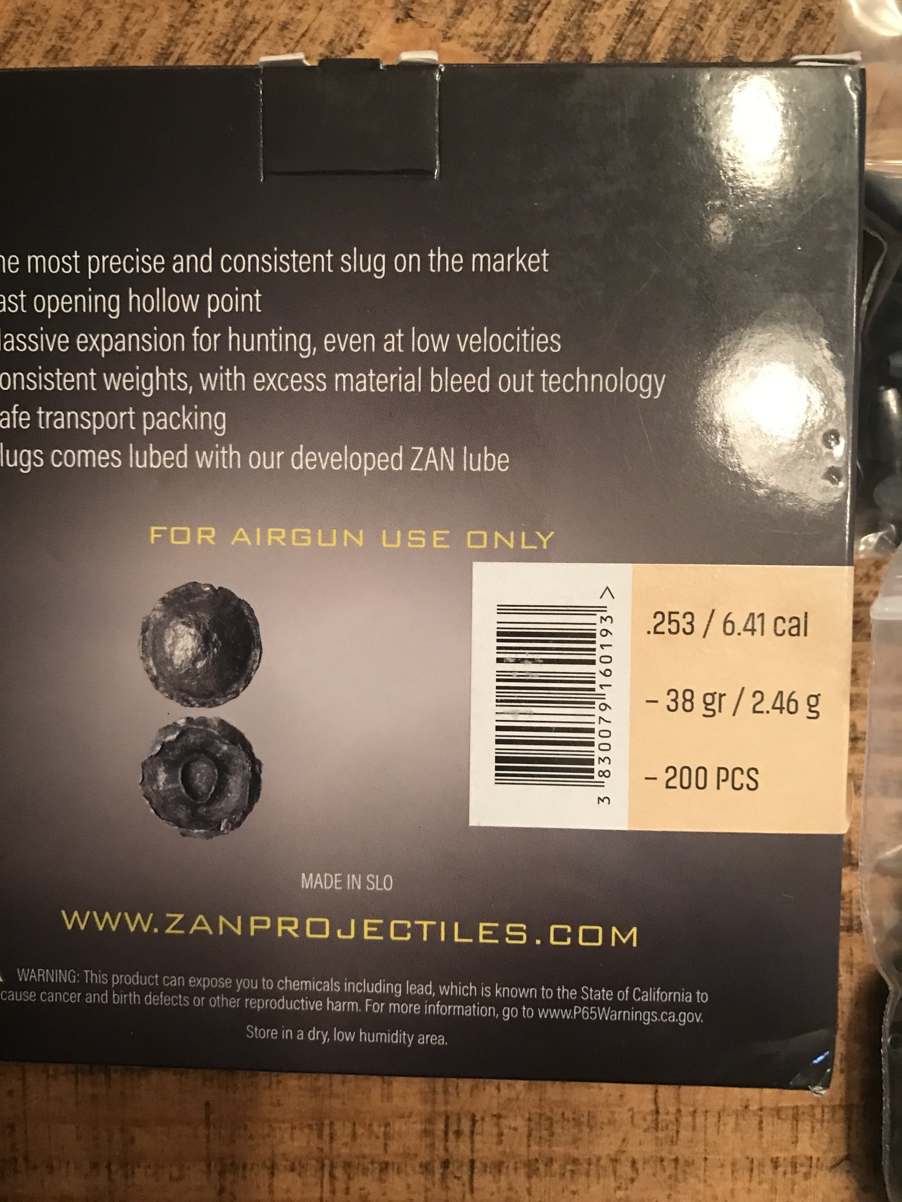

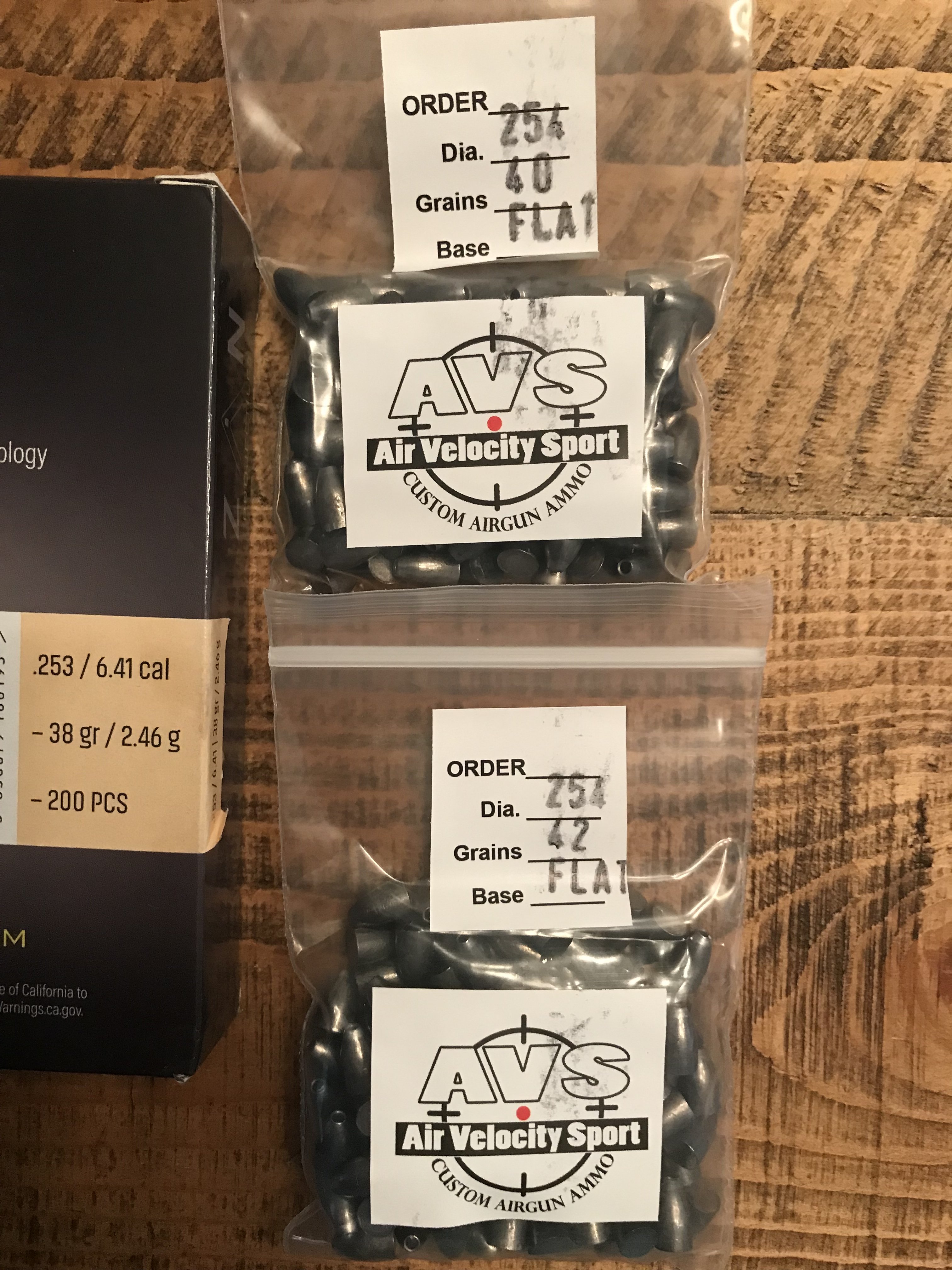

Were the slugs .250 or .253(zan) .254(nsa)?ZAN .253 shoots just fine out of my GK-1 with no issues….AVS .254 42gr would be my recommendation though.
Reactions: Bandito

I received the 12.5gr .177 slugs from NAS today and they are working better in my Crown than the JSB Knock-outs, and they were grouping in dime size groups at 50 yards. The work so well, I placed another order with NSA today for 2 more boxes and added a box of the .254 33grto try in the GK1.
I really have no idea, these were slugs I had laying around from when I was testing them in other airguns. One is in an old tin marked NSA .25 26.8gr, the other is in an old tin marked ZAN .25 33gr. Both fit way to loose and the magazine will jam when I'm just spinning it after loading the slugs. I have not tried to actually fire either from the GK1 for fear of a jam!
Yeah sounds like .250…you will be good with the NSA .254’s👍🏼.Here’s a couple other good alternatives.
