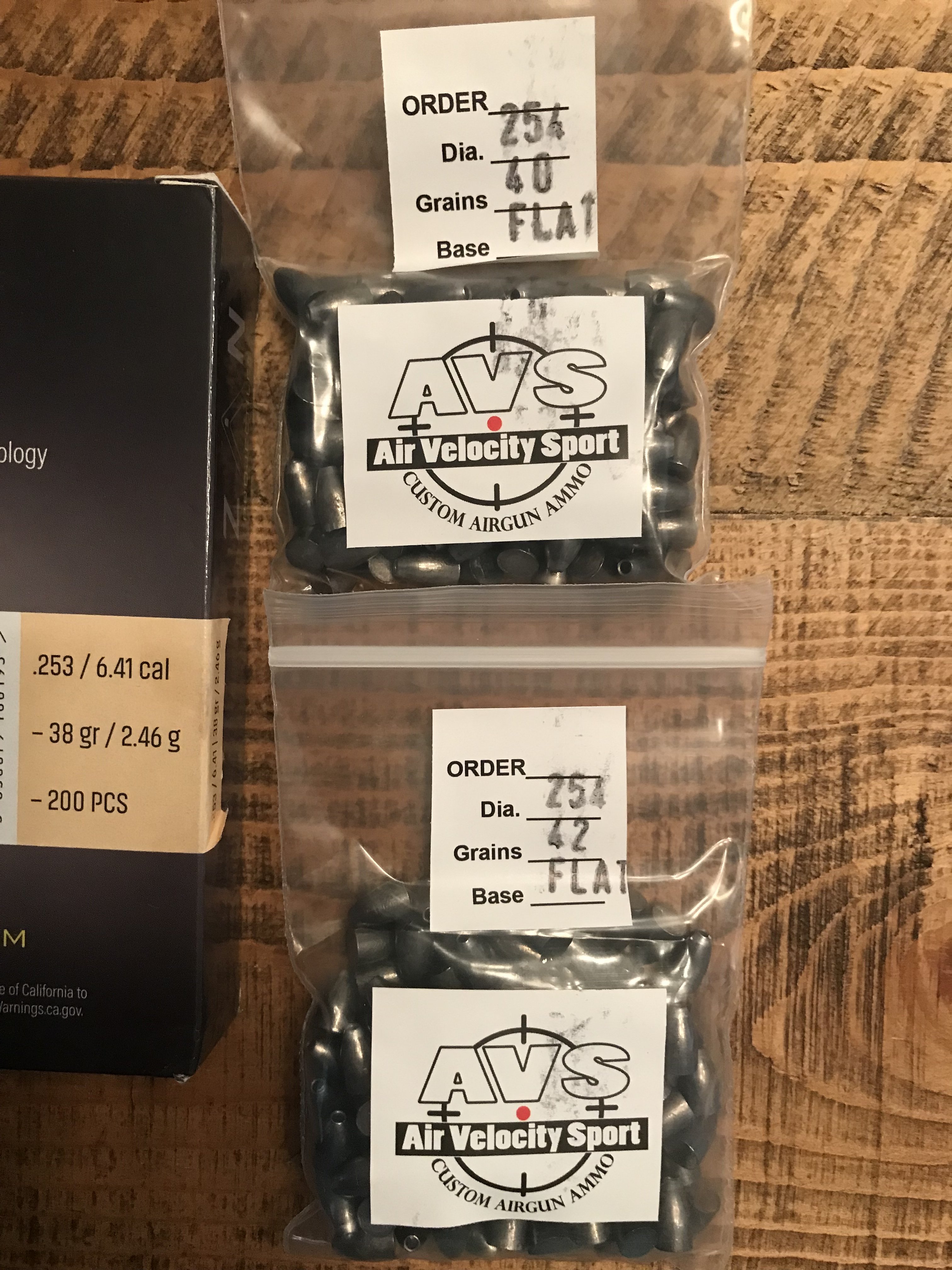

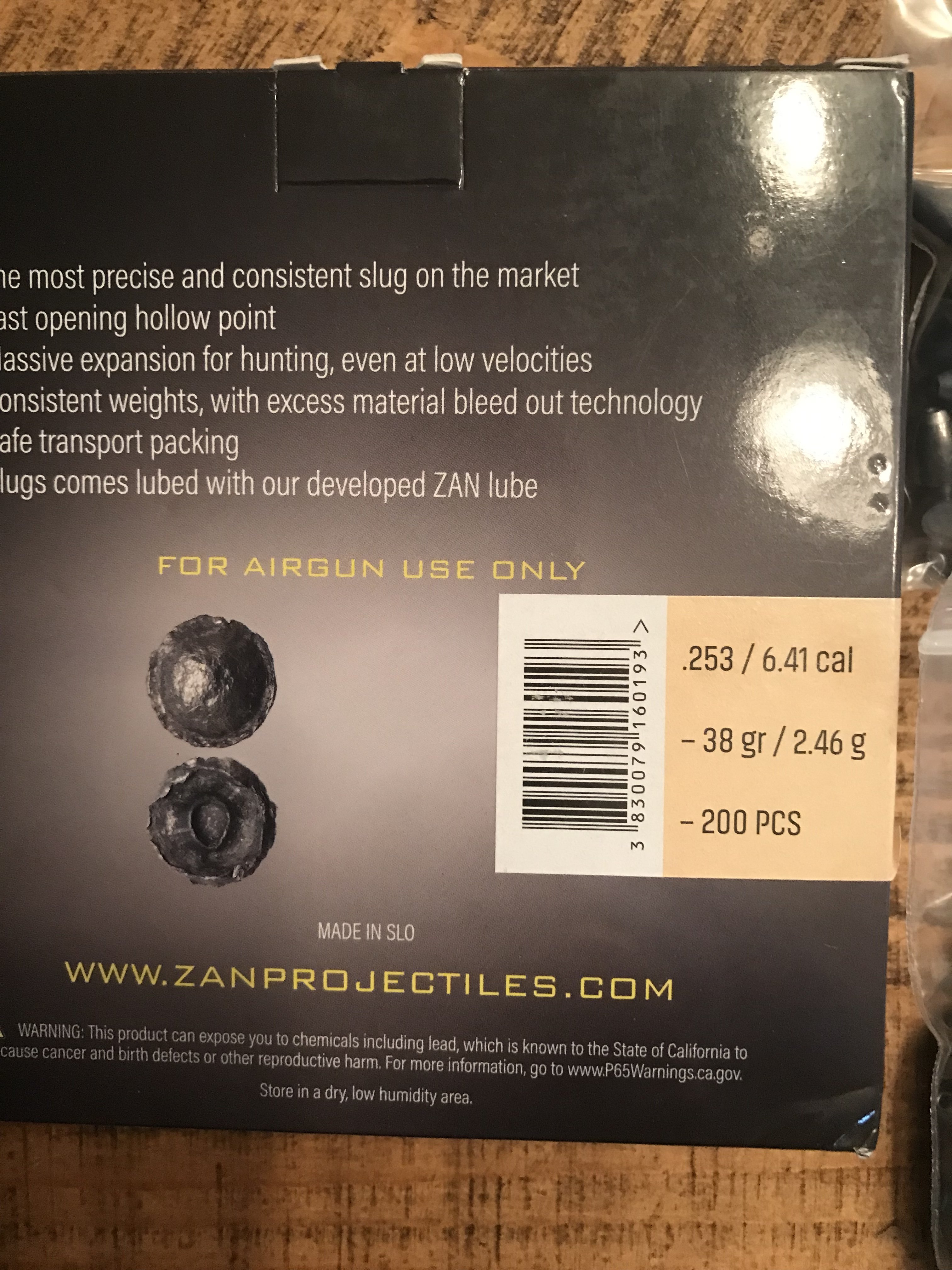

AVS has .253 now. I tried to push it and bought AVS .253 cup 48 grain listed at .429 long. They are just a tiny bit too long and scrape a bit when I rotate my GK1 magazine, so I didn’t try to fire them. I have Zan 38grain to try, but will probably also get a slightly shorter AVS to try to max it out.

On a different note, I just got the Zan rounds and found them to be TIGHT. i had to push them in. the mag cycles fine but im still afraid to shoot them. should i be?
