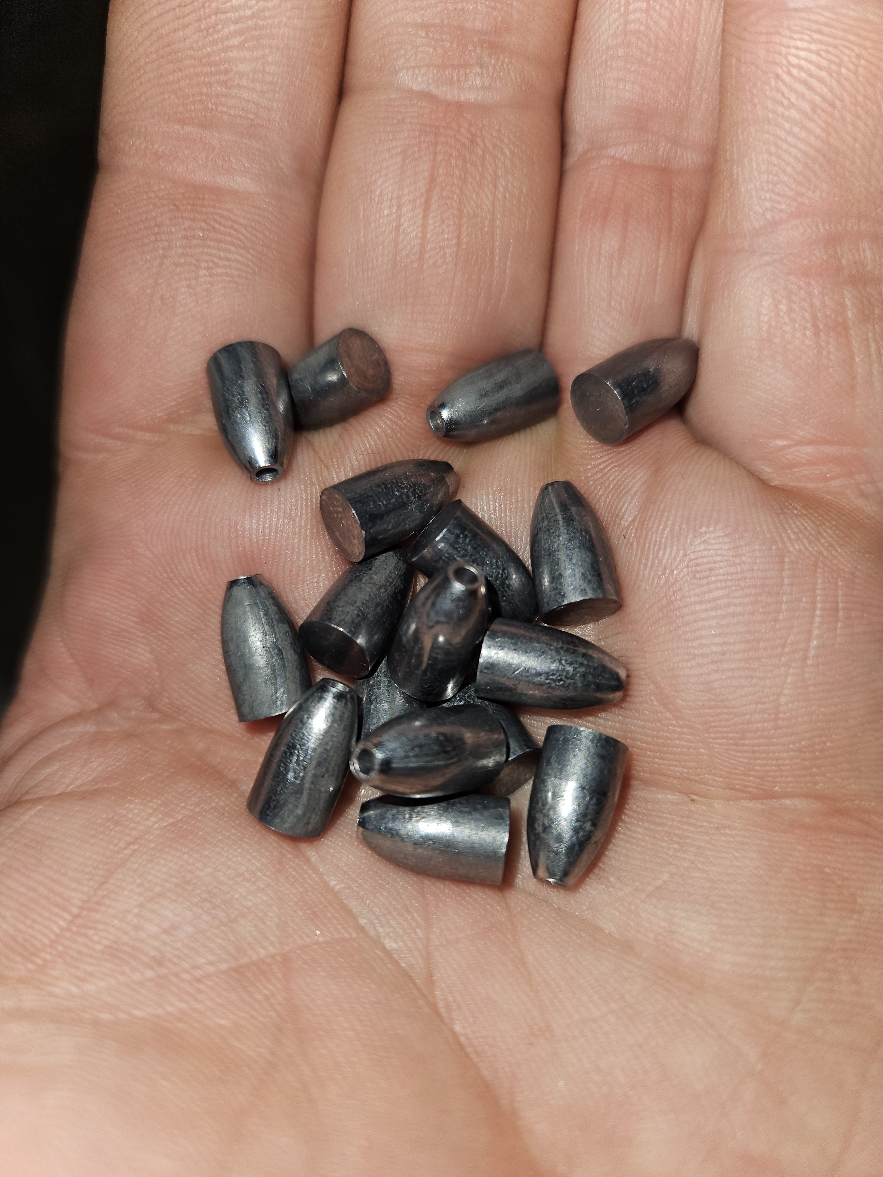

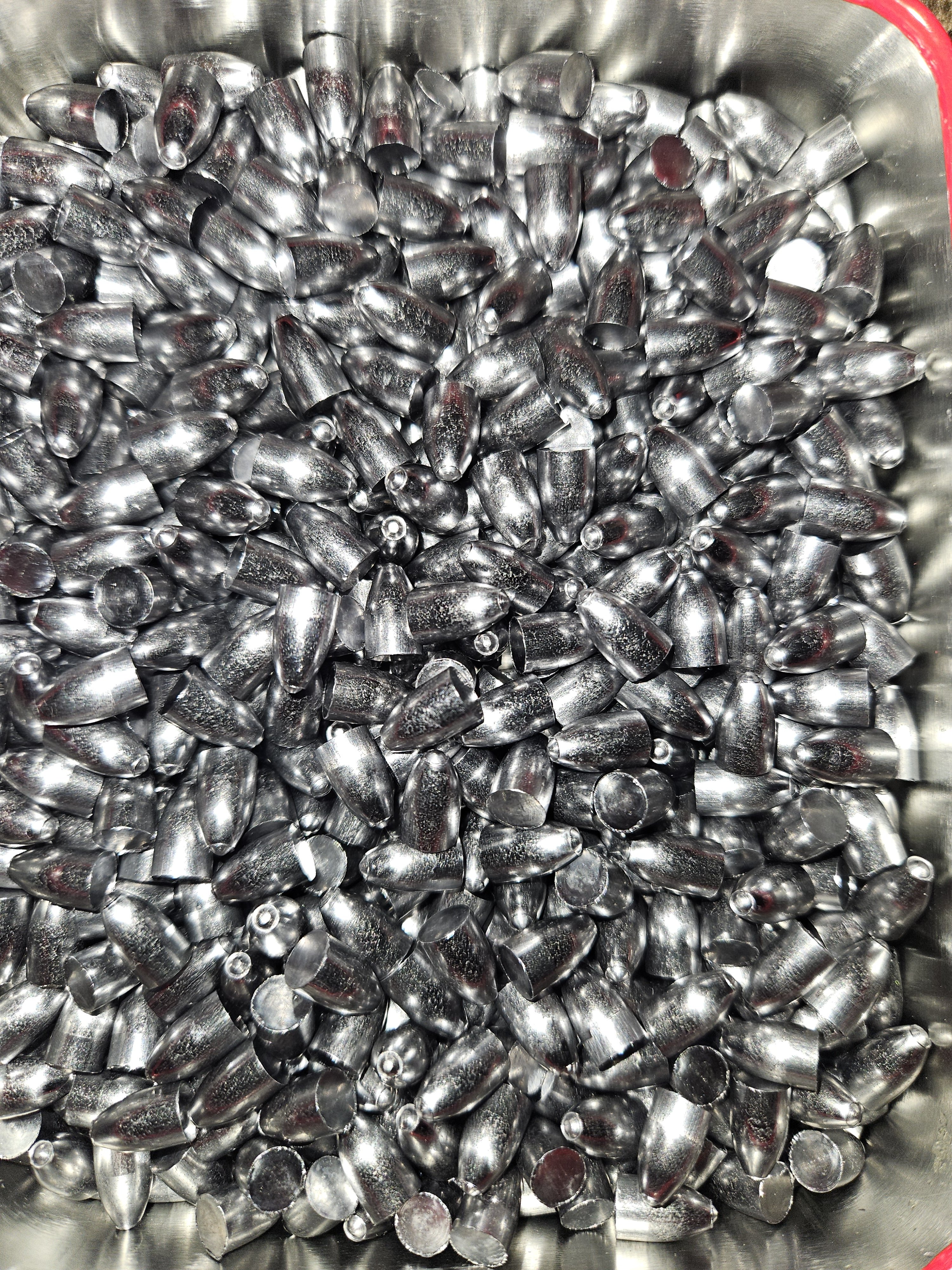

Been liking the ones I've been making. Unfortunately the .2537s I had a die made in just weren't as accurate for me. It likes the .254s better, as everyone else says.

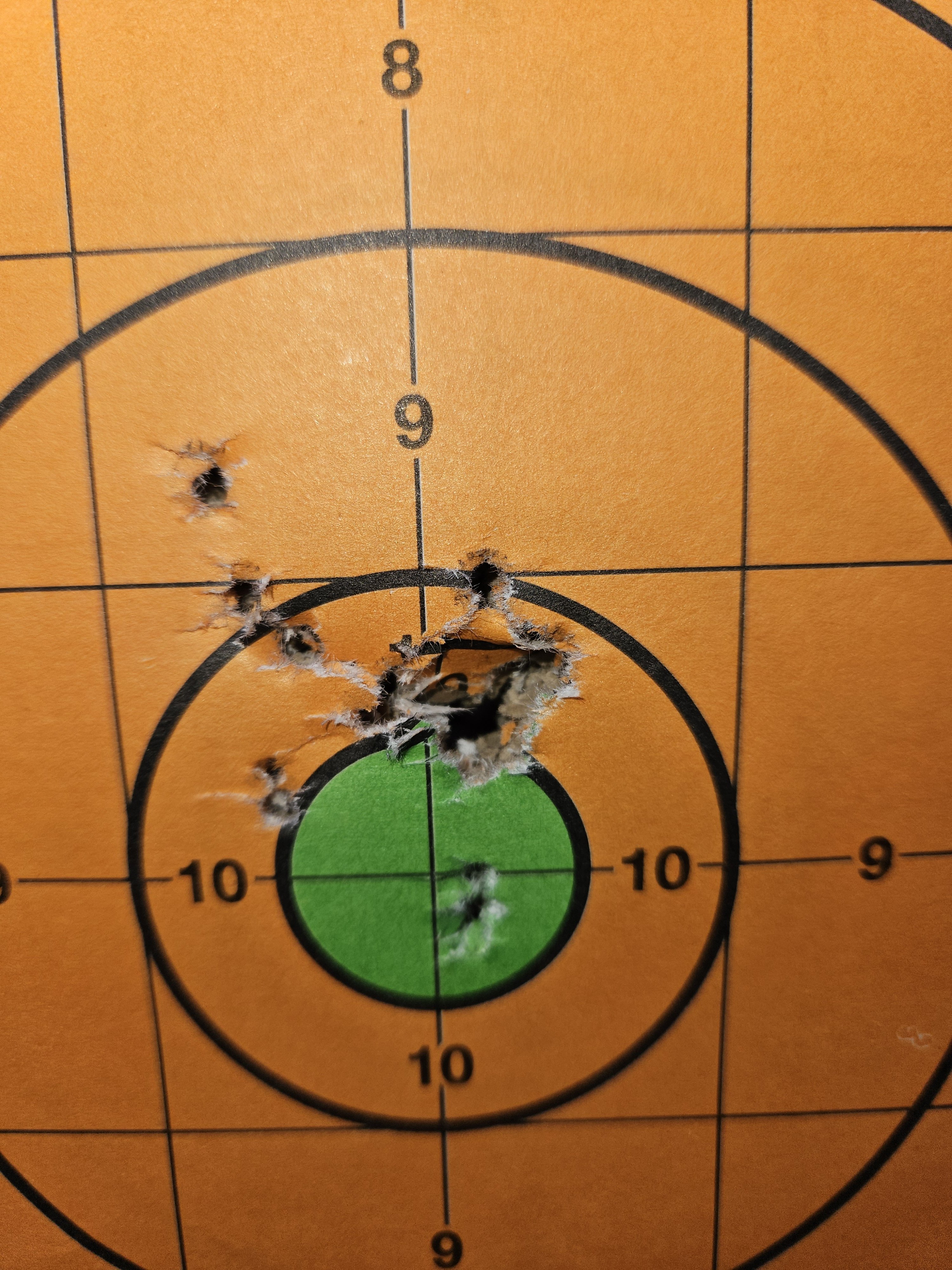

I can make hollow points or nound noses. It likes both about the same which is to say very well. I basically make them to fill the magazine, just a fraction of a mm shorter so the seating is very satisfying. The round noses are a bit over 46 grain and the hollows end up right at 50. Dont have many group pics but here is a pretty good one shot at 15 yards if I recall... using the iron sights and a bag rest. At the distance I shot at it, the green circle looked to be about as big as the sight dot. No pics of groups at further distance but I seem to be able to hit cans off hand pretty consistently out to 50 yards and with a few tries at 75.
