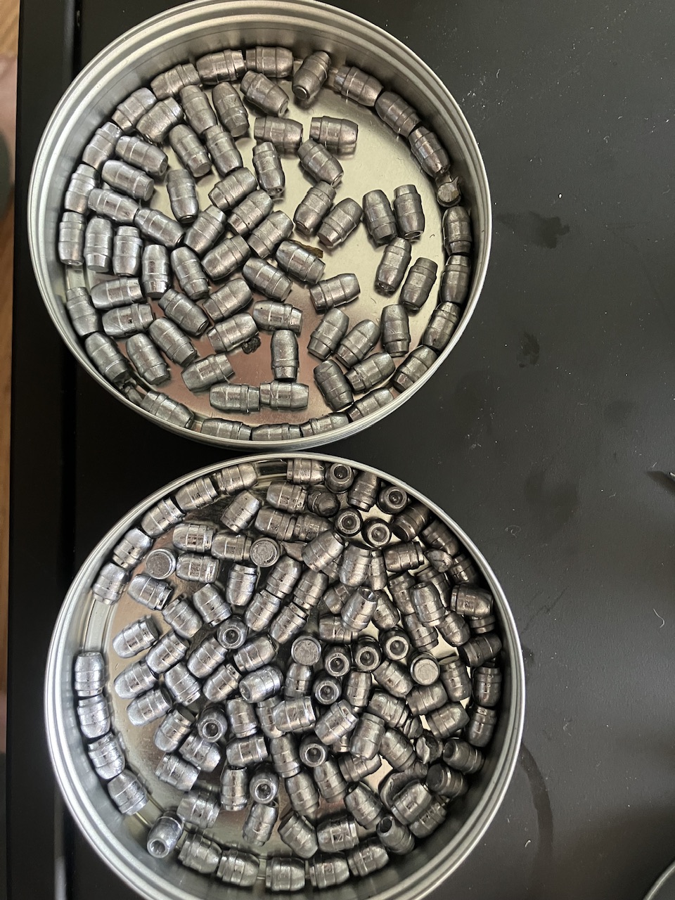

Bob's boattail slugs. Molds for these can be picked up from NOE bullet molds.

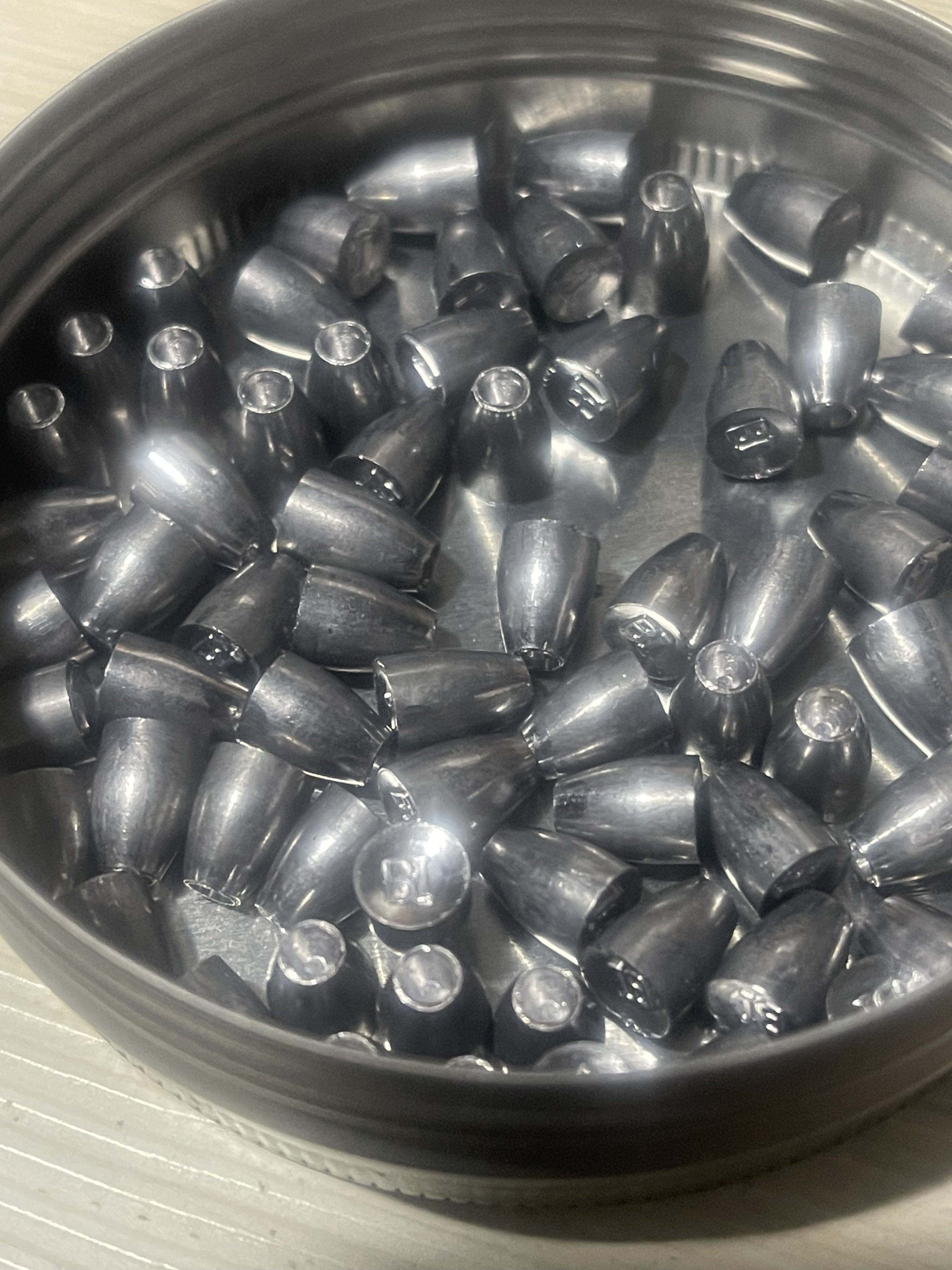

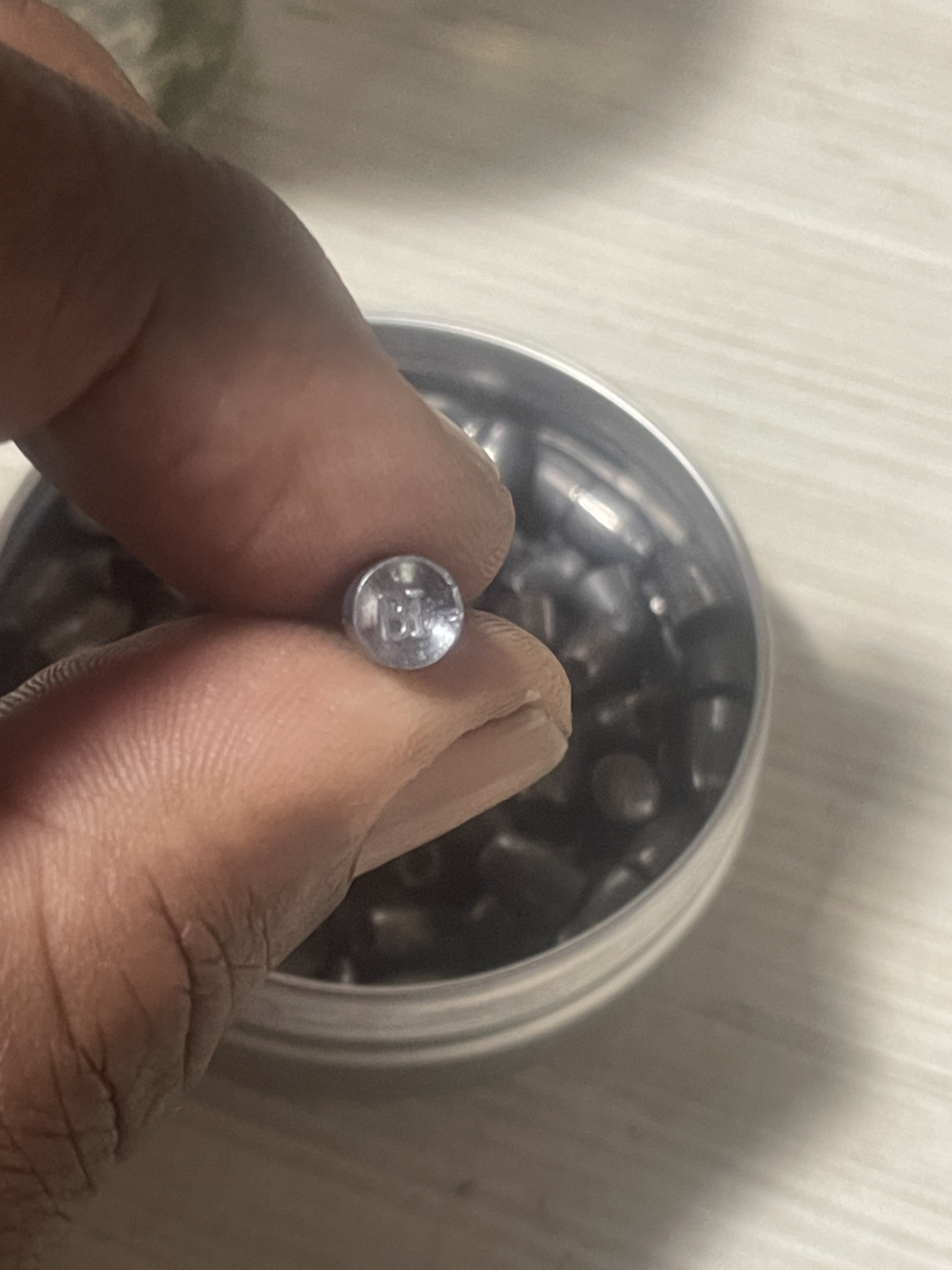

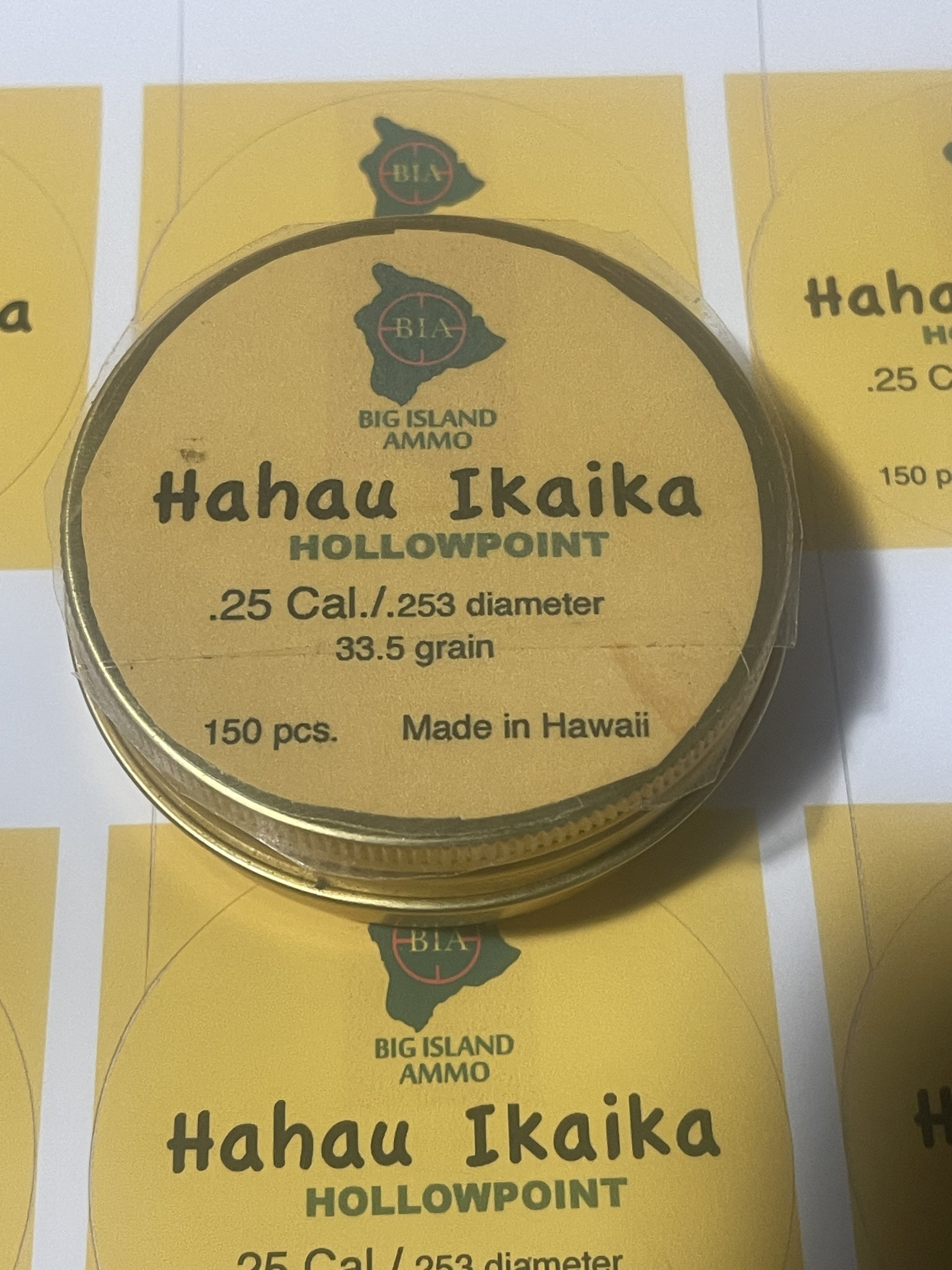

I made a custom die for the .25 cal GK1 that shoots .253 slugs MOA at 110 yards. I’m in the process of setting up a website to sell them but you can contact me and I can send you some samples in the five different weights.
You can view accuracy tests on my facebook page: Big Island Airgunners

Big BIG thumbs up here for @DMTman! I received a sample of his 50gr, 40gr (haven’t shot the 33gr yet) but can vouch that these are my favorite slugs I’ve run through all of my .25 (Lelya 2.0, Matador Long and GK1) - these are special in that I haven’t found a single slug yet that will run in all three cycling properly. I’ve tried ZAN, Altaros (good too in the GK but expensive), FX hybrids… but I prefer one slug to rule them all. I also prefer the heaviest slugs I can run in all my gear, and these fit the bill perfectly. Highly recommend you grab yourselves a sampler and send them downrange.
Peace,
Mark
P.S. they’re also very handsome.
