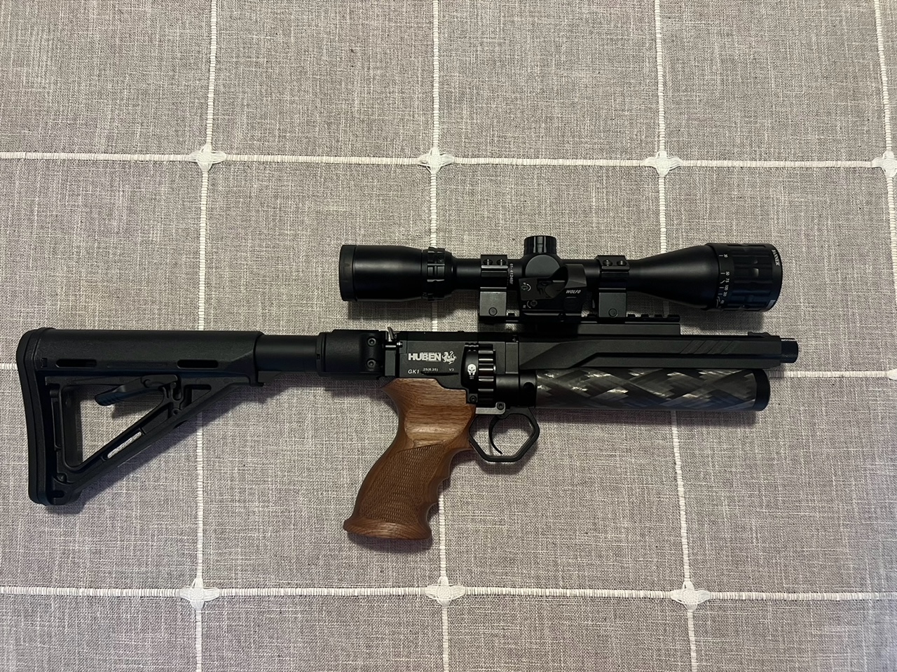

Yep, when I bought my GK1, previous owner said the AVS .254 42gr works great. I bought 400 slugs and I only shot maybe 50 because they're difficult to load. I guess you can say I'm not too experienced in putting things in tight spaces... lol. I went back to pellets. I've noticed the JTS dead center are a bit wider than most other brand pellets and has a tighter fit in the GK1 thus having a smaller group at 15 yards. I was shooting JTS .25 25.39gr. I ordered some JTS .25 33.80gr and some in 29gr. We'll see how they shoot. I use my GK1 to go small game hunting. It works great so far and at maximum, I am shooting 50 yards. I did add a pistol brace to my GK1.
