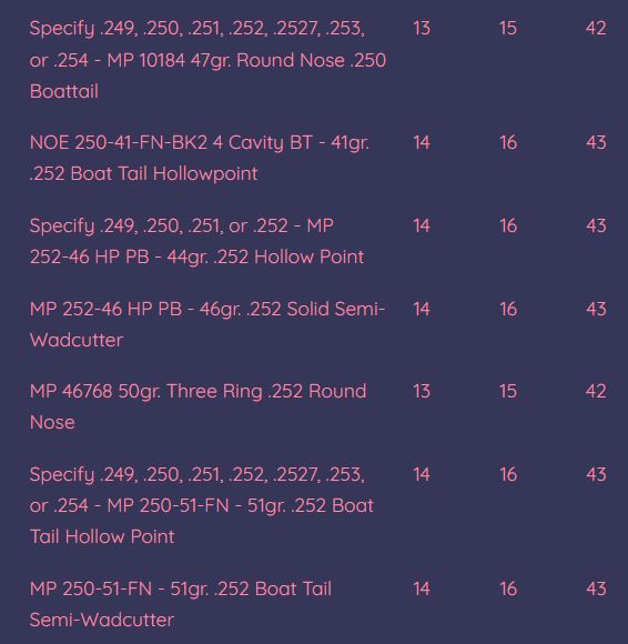

If you want to try cast slugs in all variations from .252 - .254, they are available:
