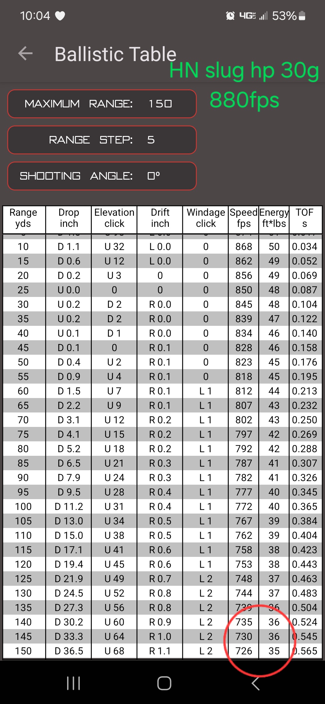

I appreciate the slugs ability to reach further. I had all but given up, then I got an email "use your $22.75 Shop app credit". So i did. And a new flame of hope ignited after I saw the groups of the H+N 30gr. 1 uniform hole on my best group., the rest fingertip tight. 25,35....45......50.......70. If it retains that at 70 it's not going beyond a minute at 100. And that's OK. BC +.11 yes, please.

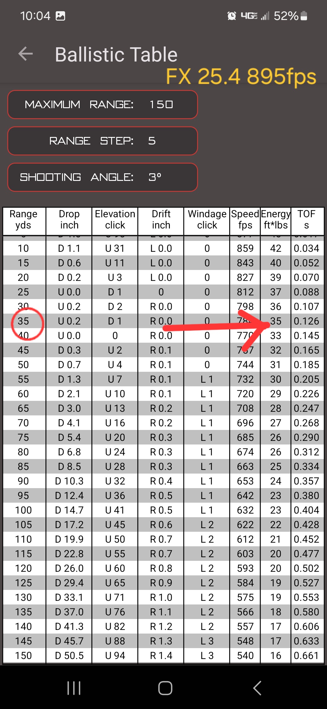

I'm under no illusions. I know what the dreamline can do. I'm limited to about 62fpe, and I've had no issue doing damage with pellets at "best speed". What's Important to me is surgical precision and on that many pellets deliver from 25.4-34gr. I just find that at 865-890 I get MUCH tighter more consistent groups than trying to push exact Kings at 930, not to mention 6 mags before needing a fill. 26gr Hybrids at 925 ish and now 30 HP slugs at 880. I've got a tune where I can push the exacts at 887 at 125bar pw:15 5.5-6 mags from 250bar-150. And if I crank the wheel up to 20 I'm pushing 30gr slugs at 880-3.5 mags till fill, or 23(max) for 33.95 Mk1@ ~875. I'm just trying to see if anyone has any experience with any other projectiles. I'm liking the slug HP. $11-120Ct isn't bad for something I'm only going to shoot at living targets. 25.4s are for plinking or pulling probe and swapping barrels to .22 is much more economical.

It worked. But 40fps slower Gave me best results. I'm pretty sure I'm at the point where I've got my loads. I'm always looking anyone else who's had good experiences with a projectile at 50-65~ fpe. Would try maybe something a little heavier or some different nsa offerings. The nsa economics aren't bad either. $16-100 of Hybrids isn't worth it. But 19-22 for 275 IS.. but hell .7-1.1 MOA is pretty damn good. Only 3FPE LESS At 100y than Exact Kings at the muzzle. Should be good enough. I'm a tinkerer. But I do always leave good enough alone after enough trial and error.
