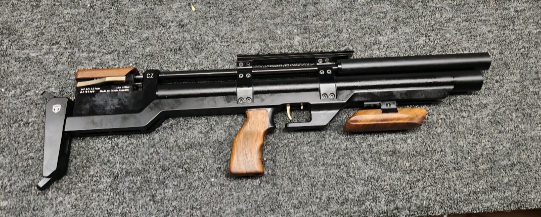

I purchased this .25 taipan standar with the intention of change the barrel to a 15mm TJ 1-22 twist. Why .? Because they suck . I have never found a review of the .25 that at least was some what close to the accuracy of the .22 . I personally have had 2 including one of the first original long and it simply can't shoot the 34g pellets in a aceptable way and the 25gr where at least aceptable.. it was really rare for me because I have shot cheap guns like the hatsan or krall and they have shot way better.. THIS least batch of taipan have won the barrel lottery it shoots Great almost any pellets you throw at it including the 34gr wich make the gun as silent as my .22 .. and I was testing at 94y + with pellets .. I'm more than happy with this purchase this kind of acurracy was what i being looking for in a .25 for the last 6 years.. OF this las batch there is only one left .. at only $1,100 what a bargain.

That last OG .25 Standard that Talon Tunes currently have in stock has a CZ unchoked barrel. That is according to an email conversation I had with Taipan. I saw that Talon Tunes is advertising it as a CZ barrel but I've always thought that the .25 comes with LW barrels so I had to clear it up. He told me that there really was no "rule" as to what barrel they put in... just depends on the dealer and what the market demands.

I was expecting a LW Barrel with my Taipan 2 Tac .25 but it's got the 12 groove CZ un-choked. It's fantastic with the knockouts but was lacking with 34 gr FX and AEA 33.95 however the wind was a steady 15 mph with lots of 25-30 mph gusts as the day went on, and that's when I started trying pellets.

Yes, as far as I know, most Veteran 2's have CZ unchoked barrels.

My Vet two standard does have a cz (550) in .22, but I don't really know at this point if it's choked or not. And as far as a choke goes.. When slugging the .25 700mm Vet 2 barrel.. It does have the slightest of chokes close to the muzzle.
