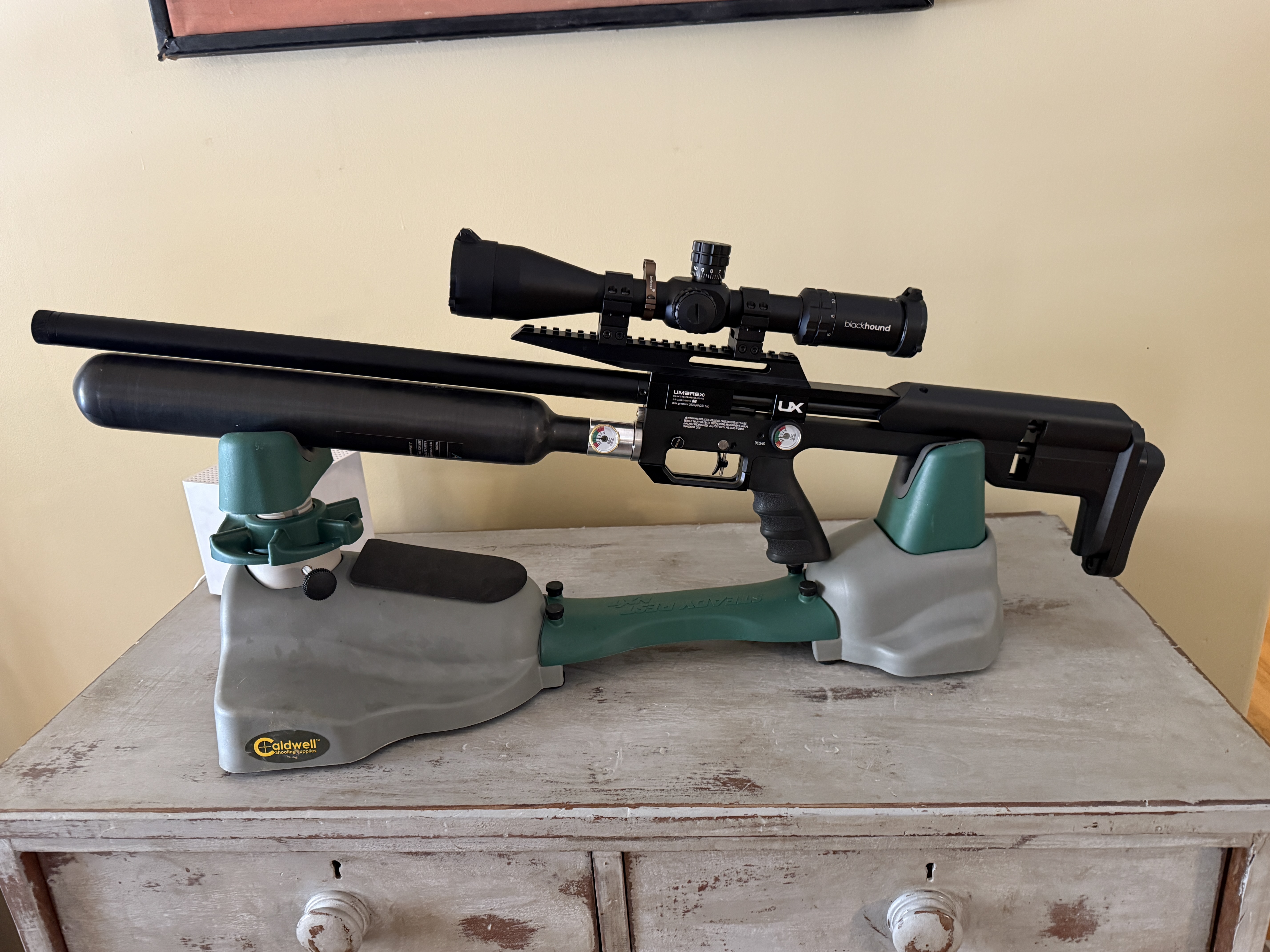

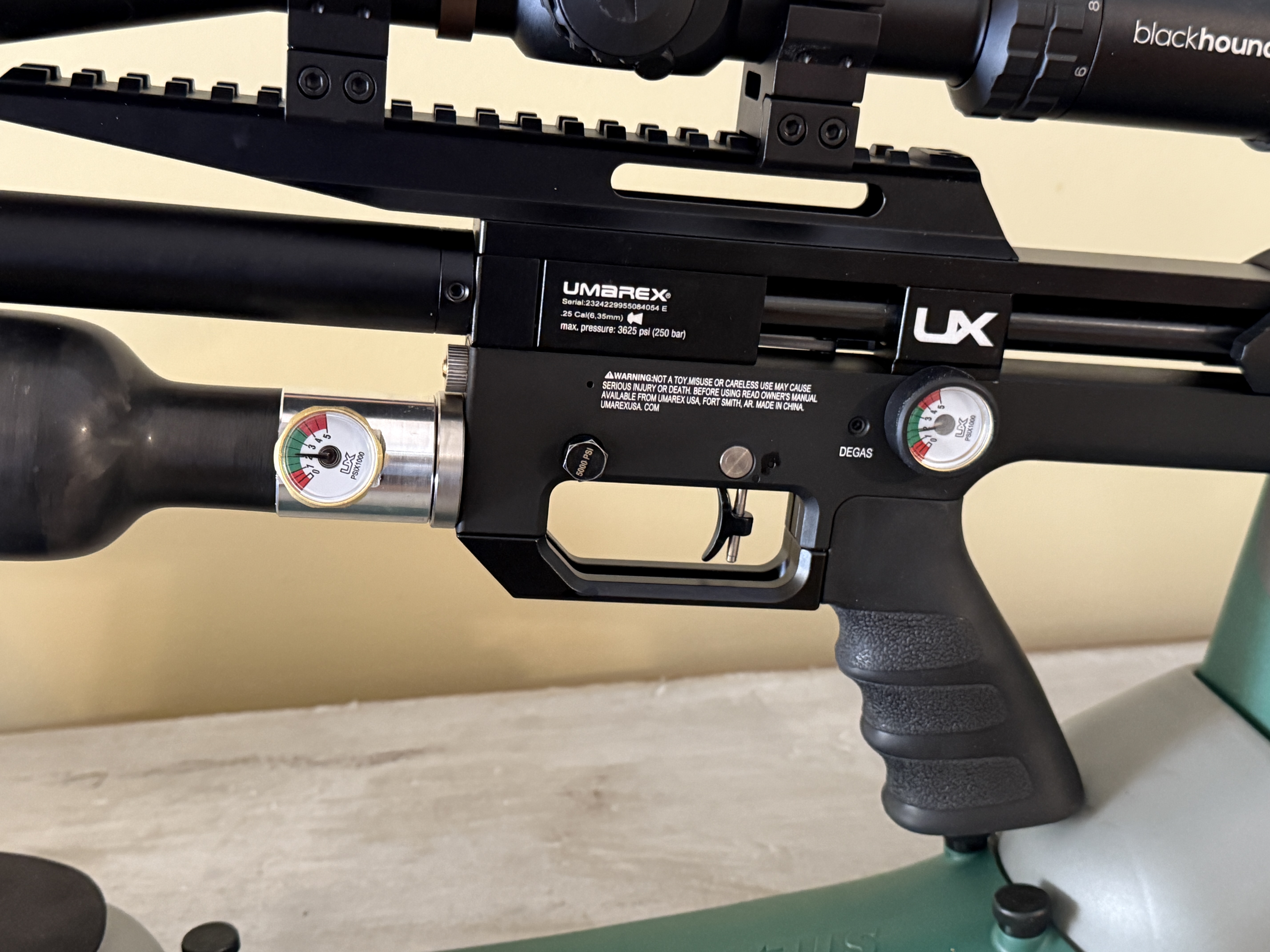

108 actually. The regulator was set at 2000psi and I have the hammer spring adjustment set flush. I am shooting a little over 900 FPS. I have about $200 in the upgrade.
It is, I think my opinion has changed. Especially for $50 and you can have it right now. I filled the tank and it held pressure for 3 days.Looks like that valve adapter is working out pretty well for you.
I shoot supported so I had never really thought about that. I just checked and the balance point is at the handle of the charging lever when it is in the forward position.Great shot count for sure - how's the balance on that beast?
I did not weigh it but the ad on Amazon says 0.7 kg so about 1.5 lbs.How much weight did that add to gun, looks like it would be very front heavy?
