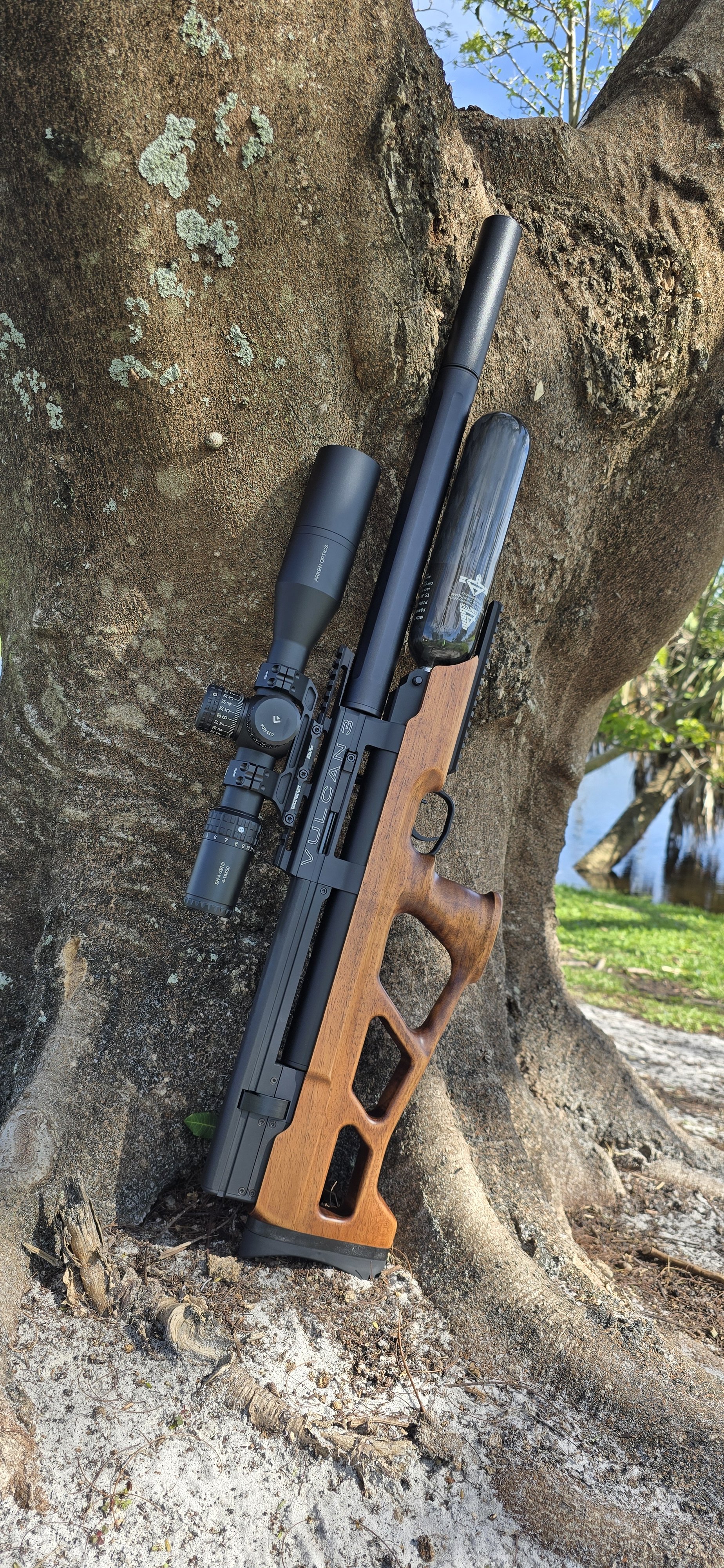

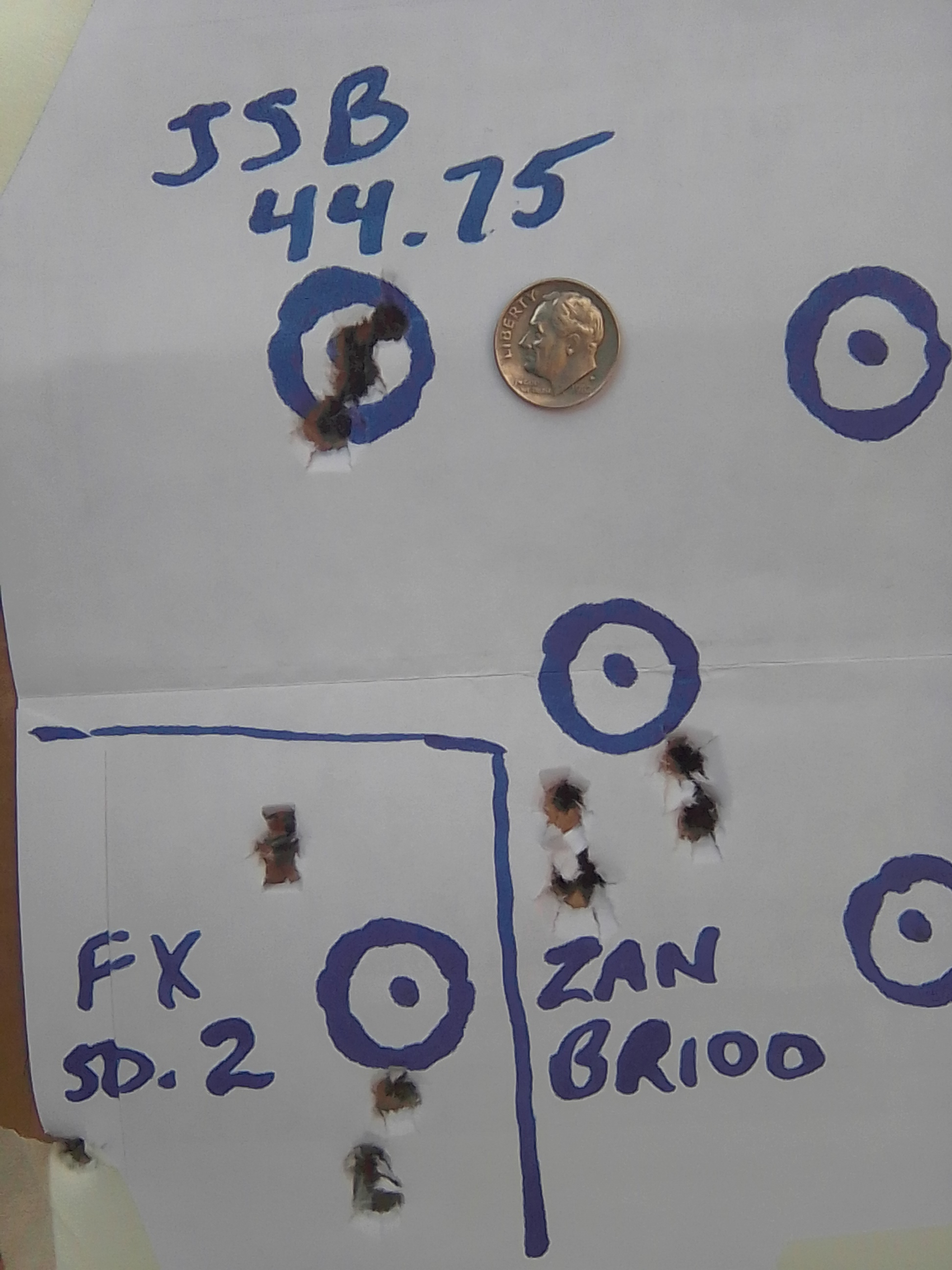

Look what Uragan 2 (700mm) did with five JSB 44.75s yesterday @ 50 yards, 984 fps. WM
A .30 uses a ton of air. That’s why I switched my P2 back to .25 and bought a 700mm Uragan in .30. I have wide berth tuning parameters and a good shot count. Unfortunately I could unscrew its bottle and go scuba diving with it. A .25 is a good middleman but when you jump to the 33.95, it gets thirsty too. So take all that into account.
Uragan 2 600 or 700mm I have one in .22 700mm and it's currently shooting 25gr HN HP2 .218 at 1007fps and grouping like this at 63.6yrdd with 5-8mph winds gusting 10mph from right to left, and you can see where the gusts took effect in this 7 shot group . @Dairyboy

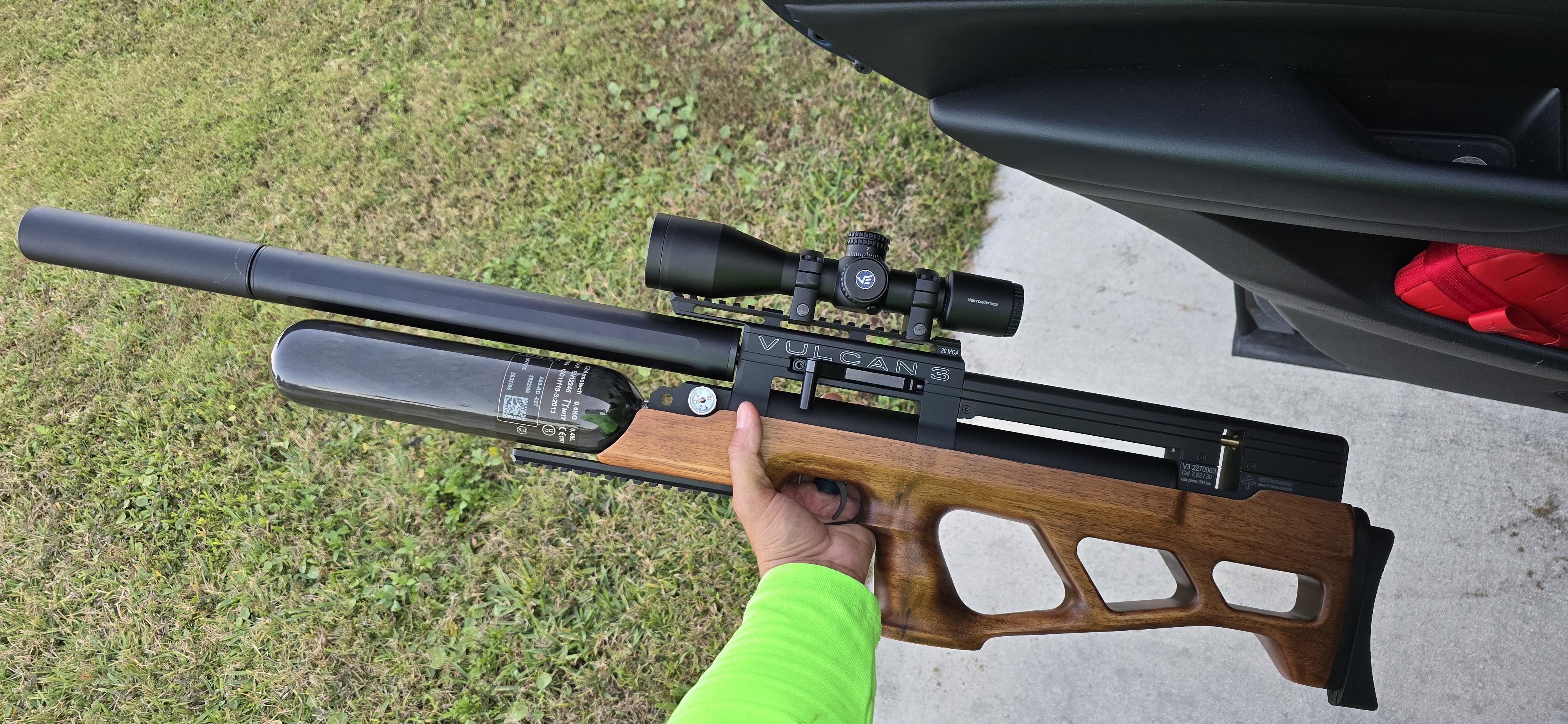

That being said, .30 may be an airport, but it's not without good reason. Unless you're pesting in large open areas you're going to go through that much ammo. My Vulcan 3 .30 500mm (31" OAL no mod) gets me between 50 and 60 shots from 300b to 150b and it shoots 44.7gr pellets between 870 and 880fps.

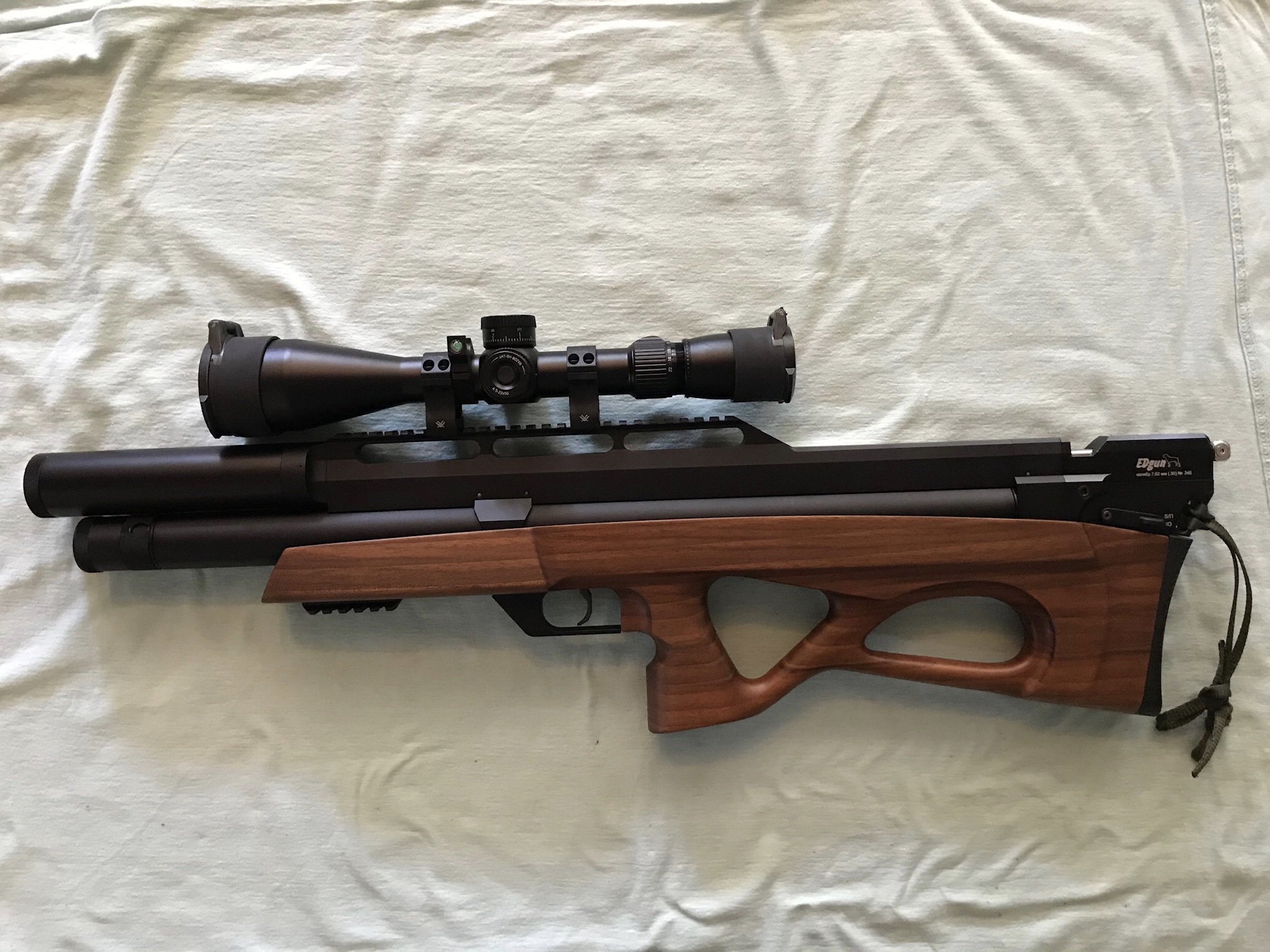

If you can find one, an Edgun R5.30 Standard. Rare as hell. Mine was short with the 18” barrel. Shot 44gr pellets at 885fps and got around 30 shots per 250bar fill. I think the Huma reg it had was set to 130bar. Longest ground squirrel was 155 yards.

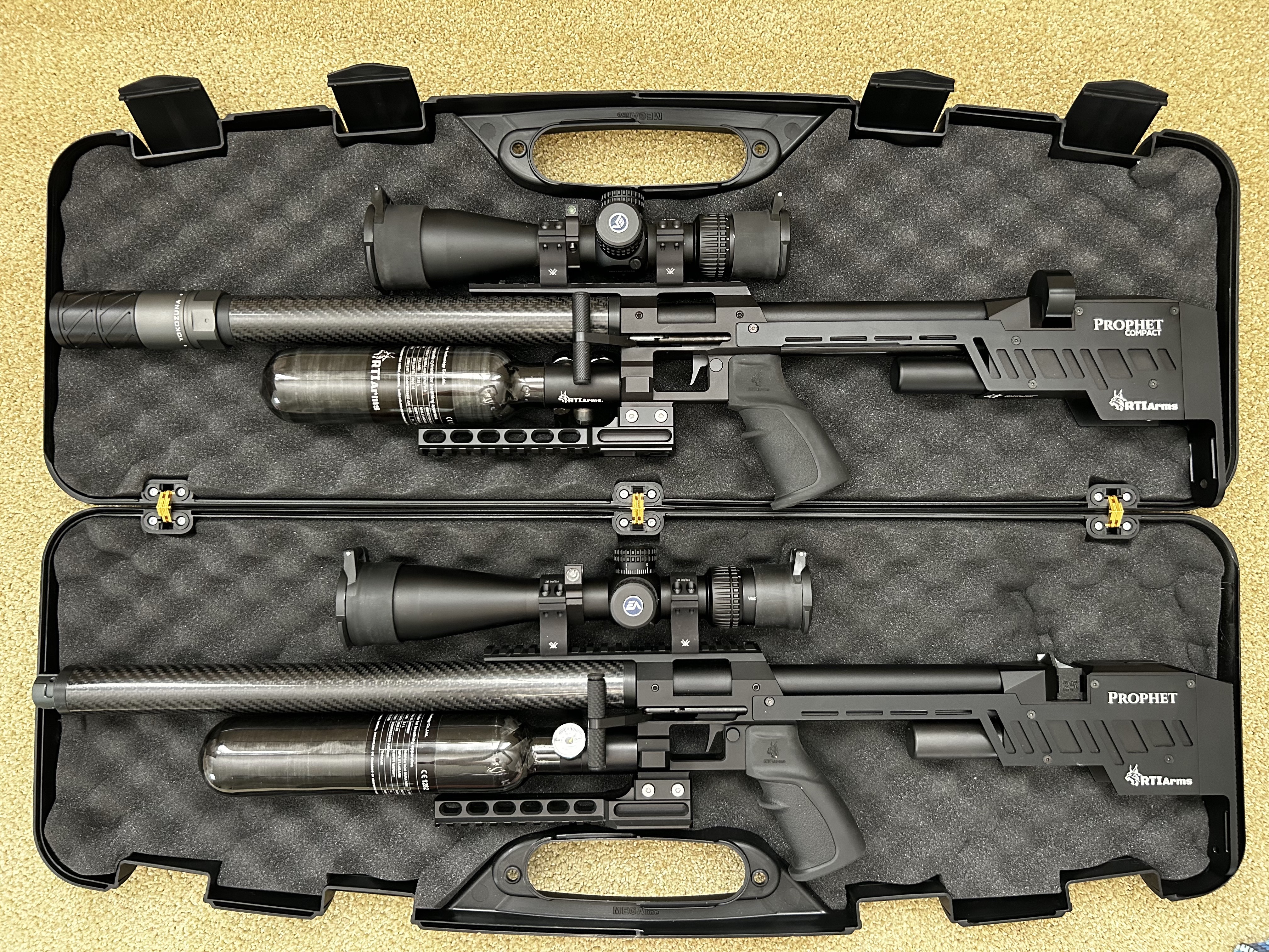

Current .30 is a Prophet P1 with the 600mm LW barrel and Huma reg. It does 895fps with 44gr FX Hybrids set at 147bar. 44gr pellets reach 920ish at the same reg setting. Gets 30+ shots from a 300cc bottle with a 250bar fill. Just swapping the barrel to.25 LW? leaving all else the same and it’ll push JSB KnockOut 34gr at 945fps. It’s the one on the bottom
