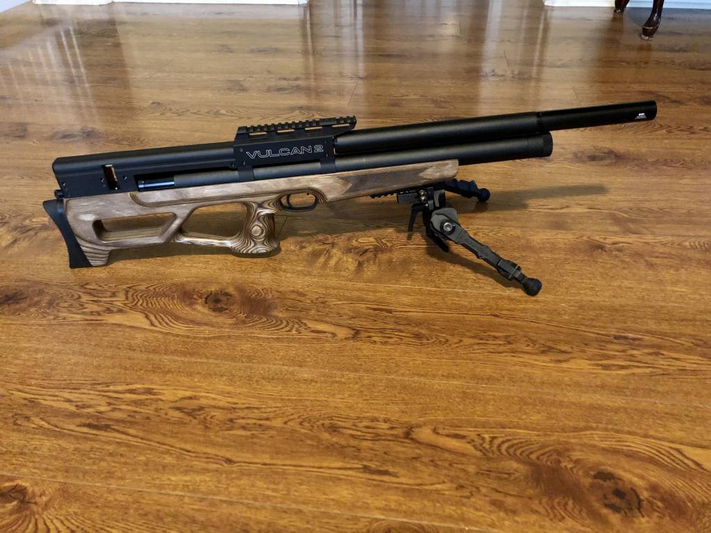

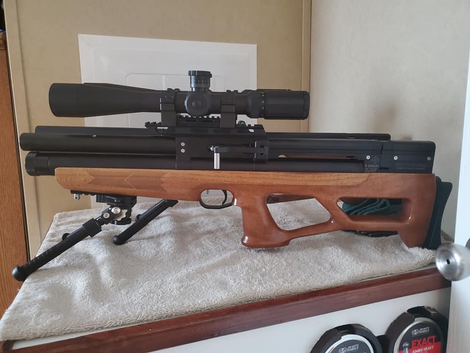

I’ve wanted to complete a power tune on a .25 Vulcan 2 for a bit now. Well, the day finally came around to get it done. First things first, got my head lamp and my safety glasses donned.

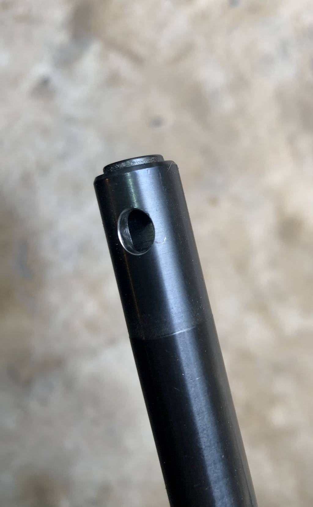

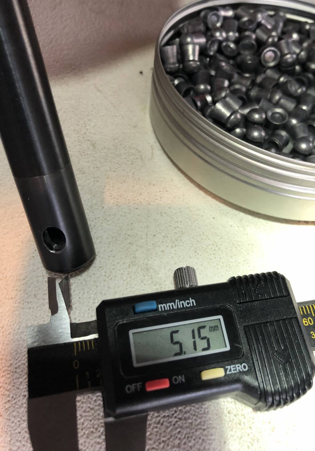

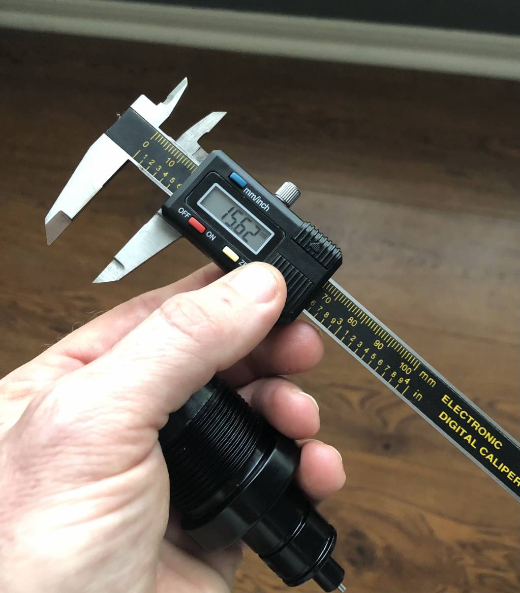

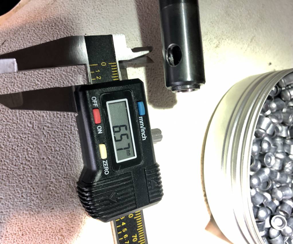

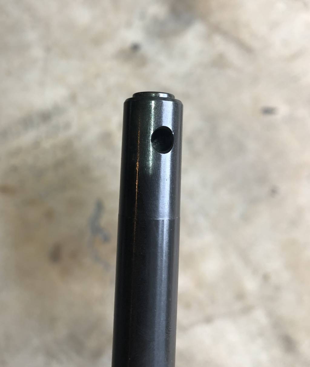

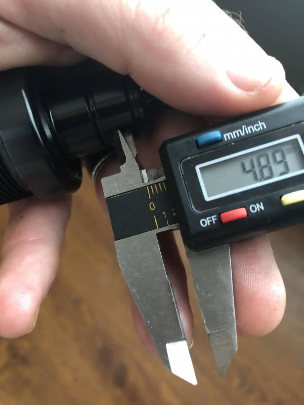

Disassembled and began taking some measurements. Wanted to take a depth measurement of where the valve-housing’s spring-return adjuster was sitting.

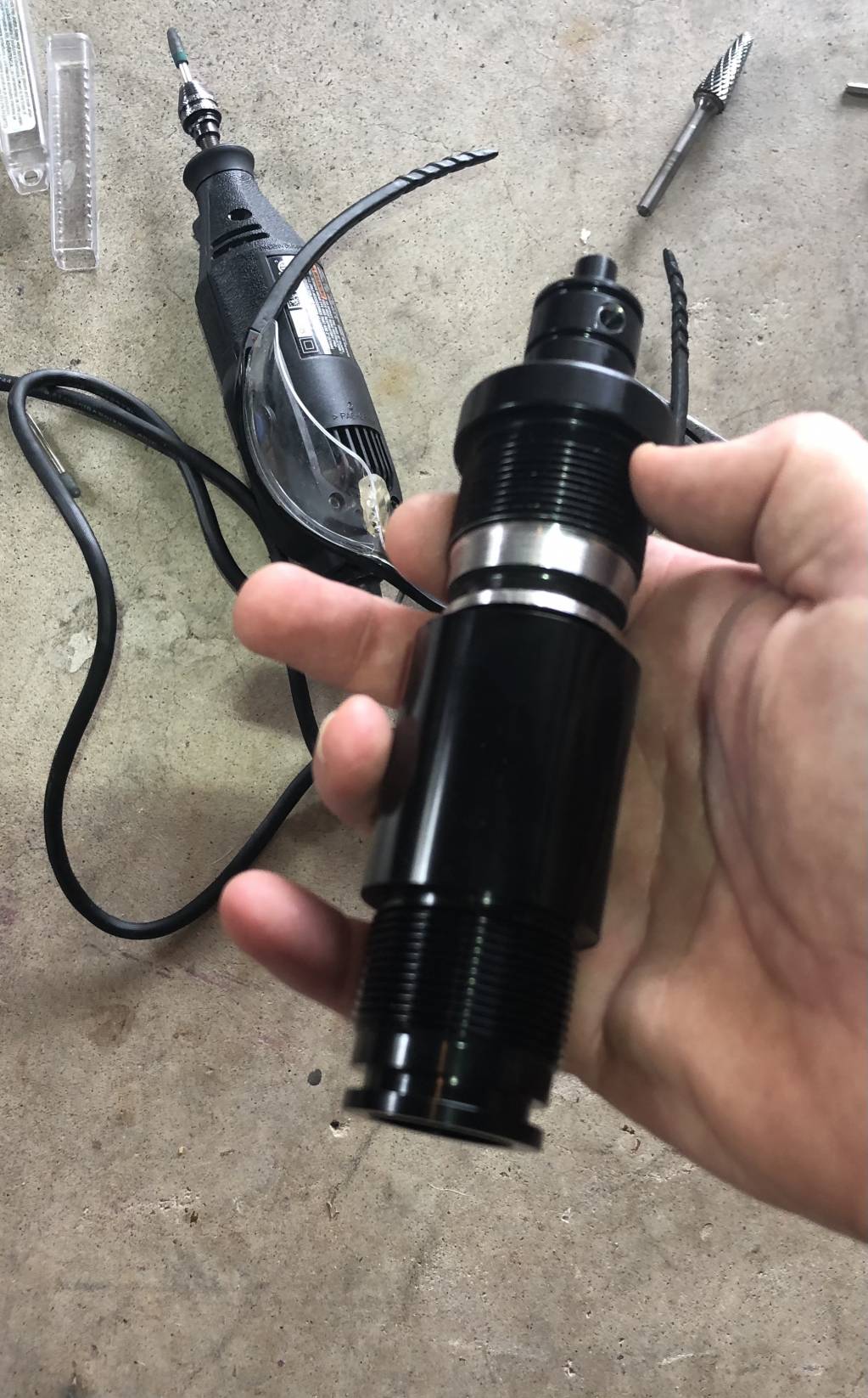

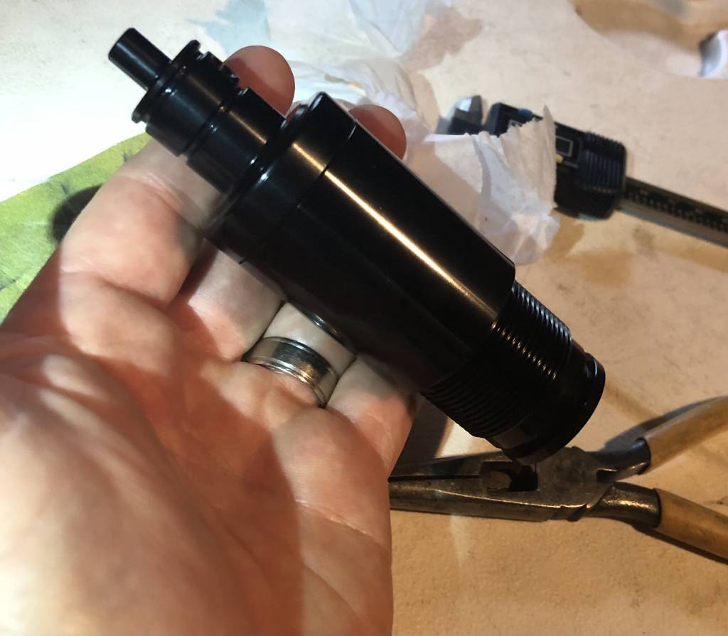

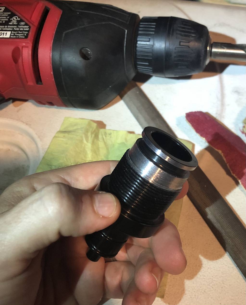

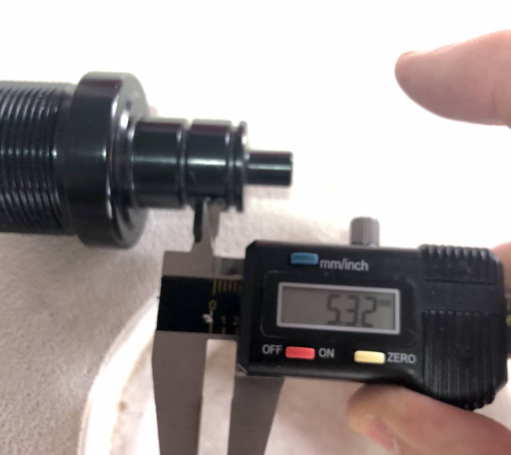

I needed to add regulated air space ~ plenum volume to shoot the 33.95gr King Heavies to my desired 58 to 60 FPE range. The Cricket power plenum just about mates with the Vulcan’s valve-housing. That “just about” doesn’t cut it! There is a portion of the valve-housing that needs to be turned down in order to properly mate with the Cricket power plenum. MacGyver time!

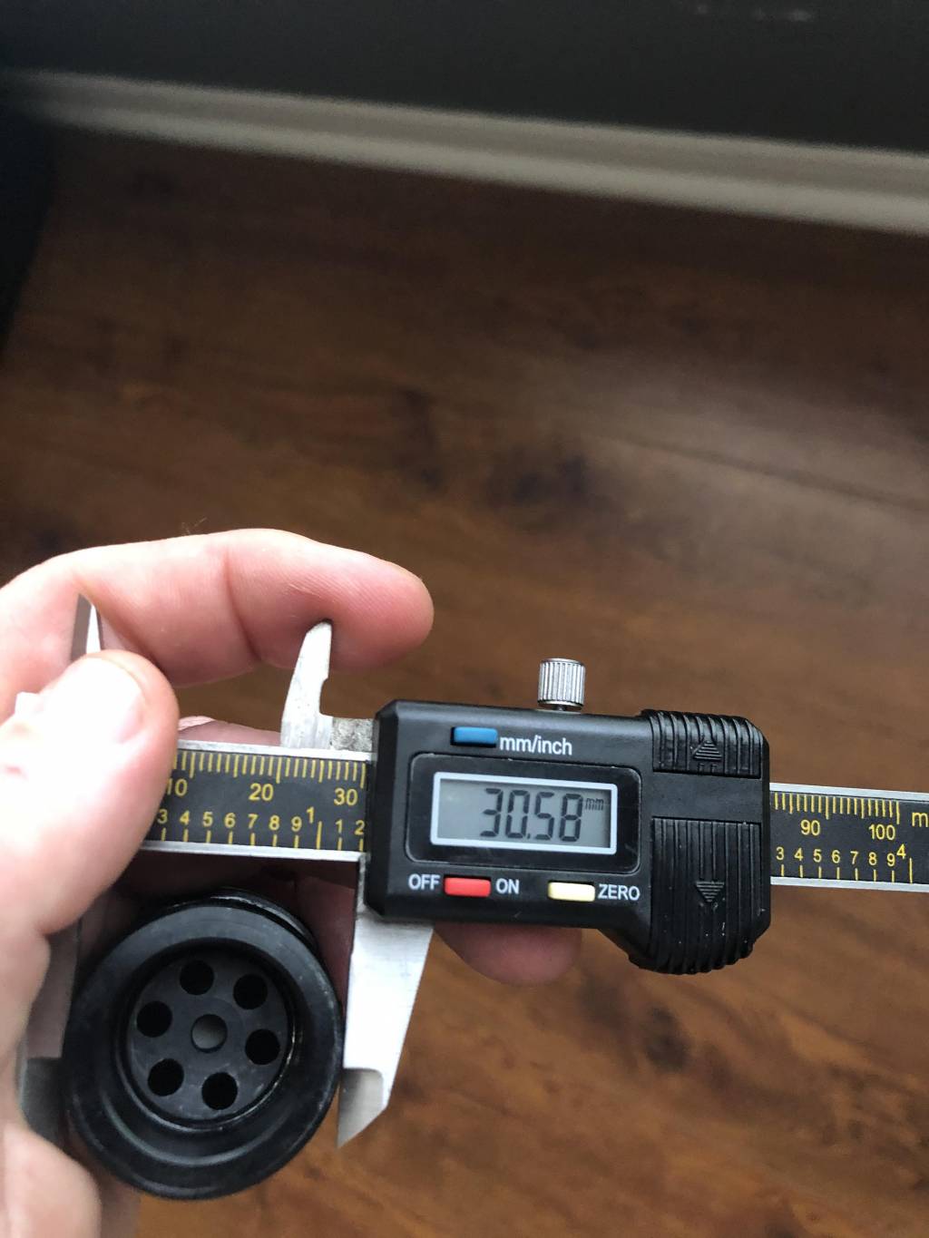

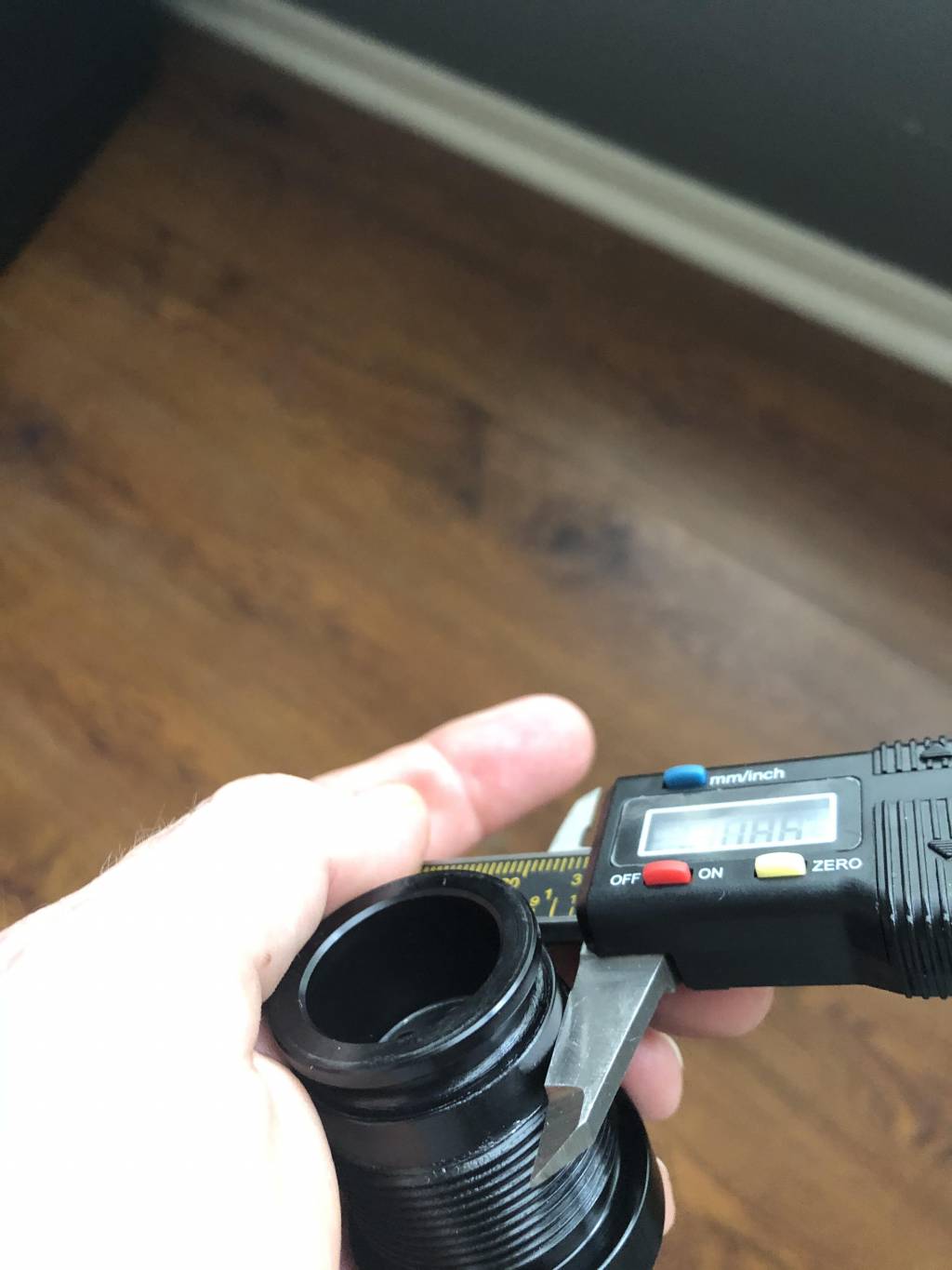

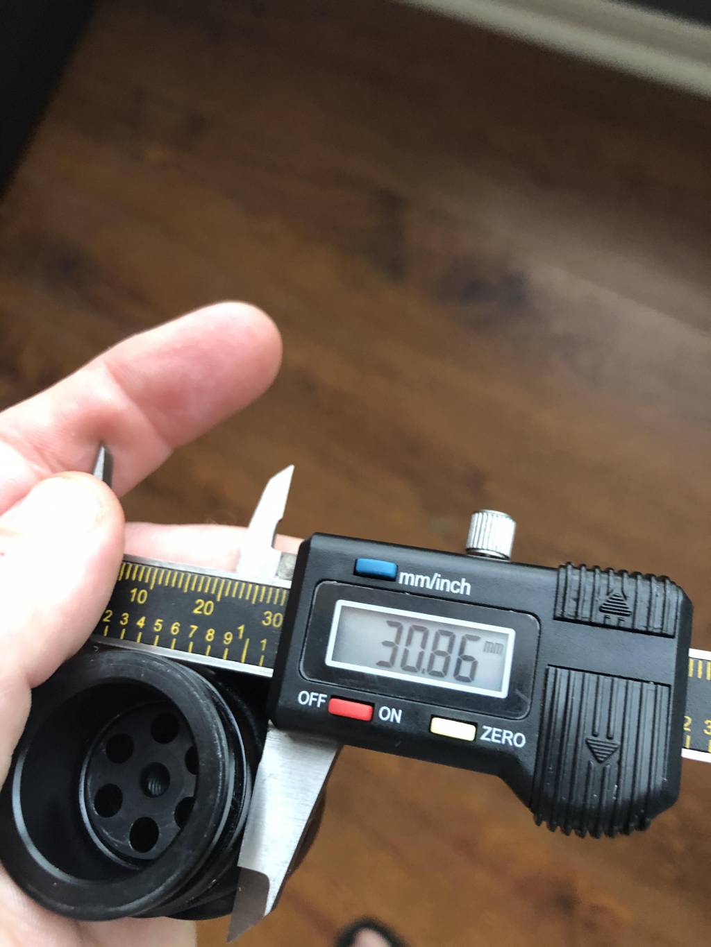

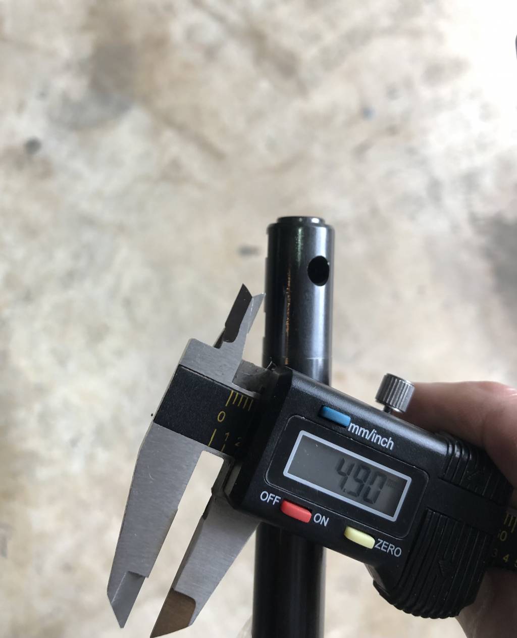

The smaller diameter outside shoulder fits perfect at 30.58mm. However, the shoulder behind the o-ring groove is too large at 30.86mm. Took care of that.

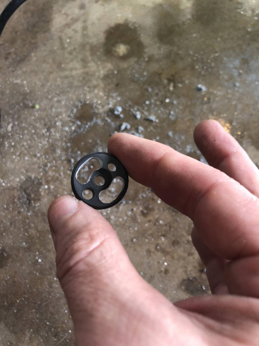

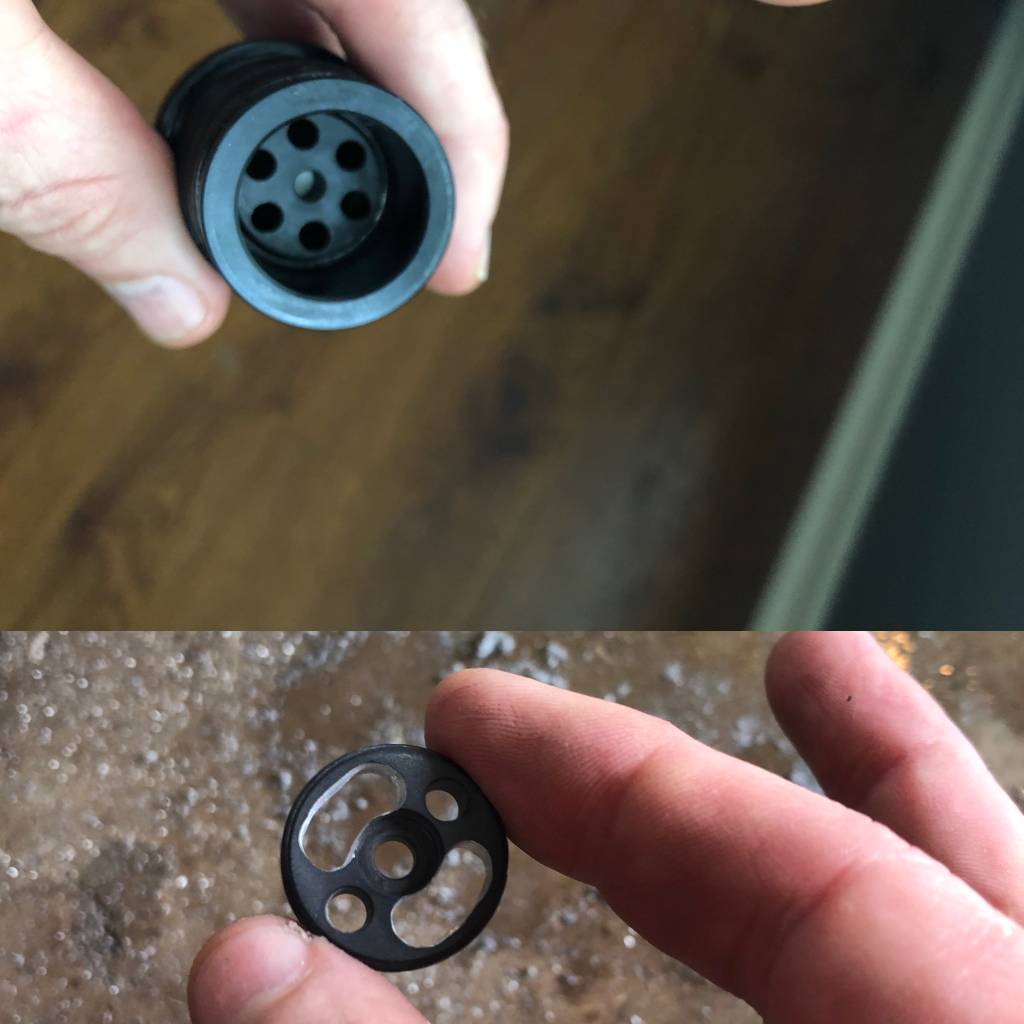

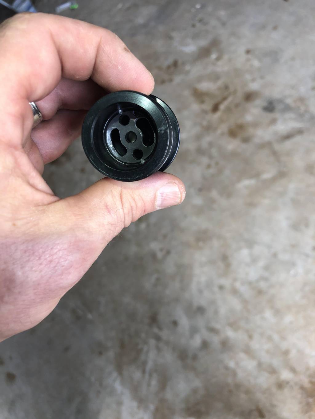

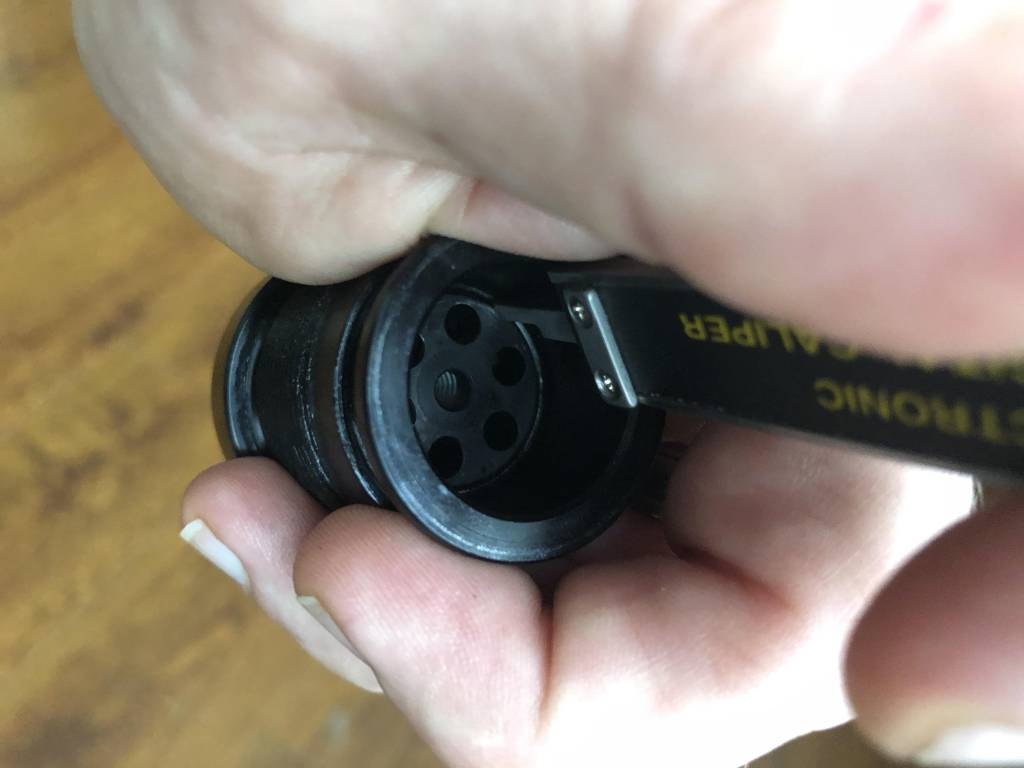

On to porting and radiusing. Need that spring-return tension adjuster opened up.

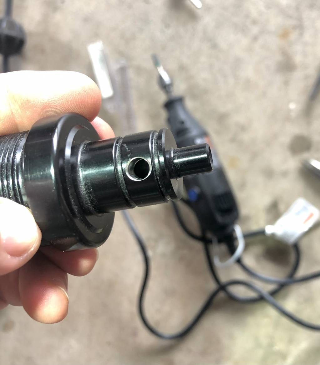

On to opening the valves porting.
Now that barrel needs to breath. Opening, ovaling and radiusing the transfer port.

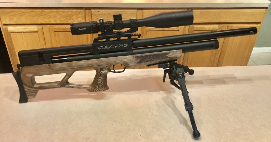

I will keep it here and see how I like it.
That made for a satisfying day of tuning. I’ll let you all know how this Vulcan 2 performs moving forward. BTW, it’s very quiet
for the power she is putting out. DonnyFL makes great products
