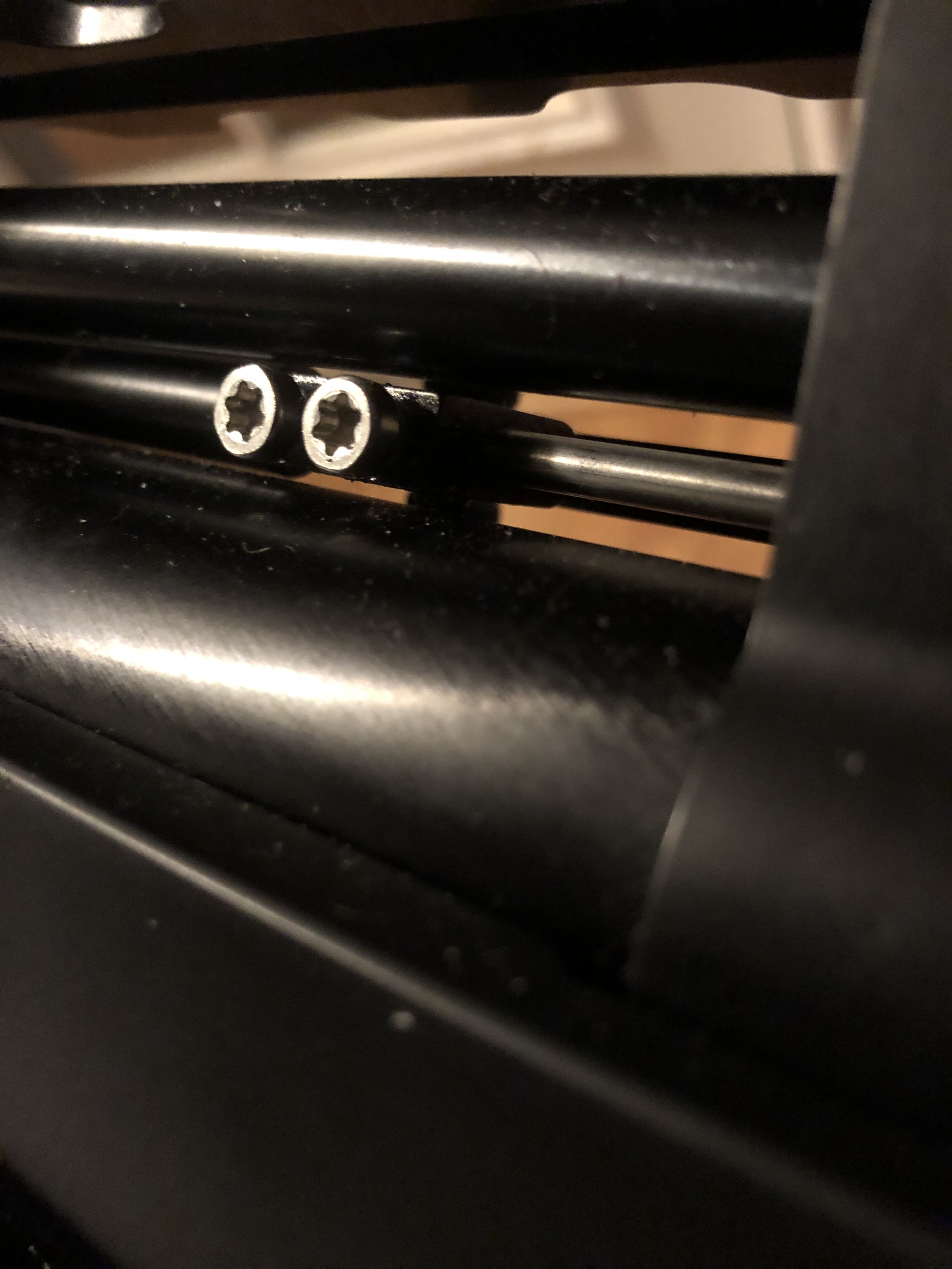

If you must pull the liner, do scribe an index mark at 12:00 so you can make sure your liner goes back exactly where it was at. Lastly, very important- swap out the two grub screws on the cocking block, one at a time, for either M4 x 6 Torx or allen socket bolts. I prefer Torx as I can really tighten down on those with no fear of rounding out the Allen socket corners. Apply blue locktite on the threads.
Consider yourself lucky that the cocking rod hasn’t slipped on you in all your shots. When it does happen it’s because those grub screws work themselves loose and then since that rod is spring loaded it’ll move your pellet probe and your transfer ports won’t be aligned. What you’ll get is a sudden loss in power and you’ll wonder WTF happened.
This is what I’m talking about, on my MK2
