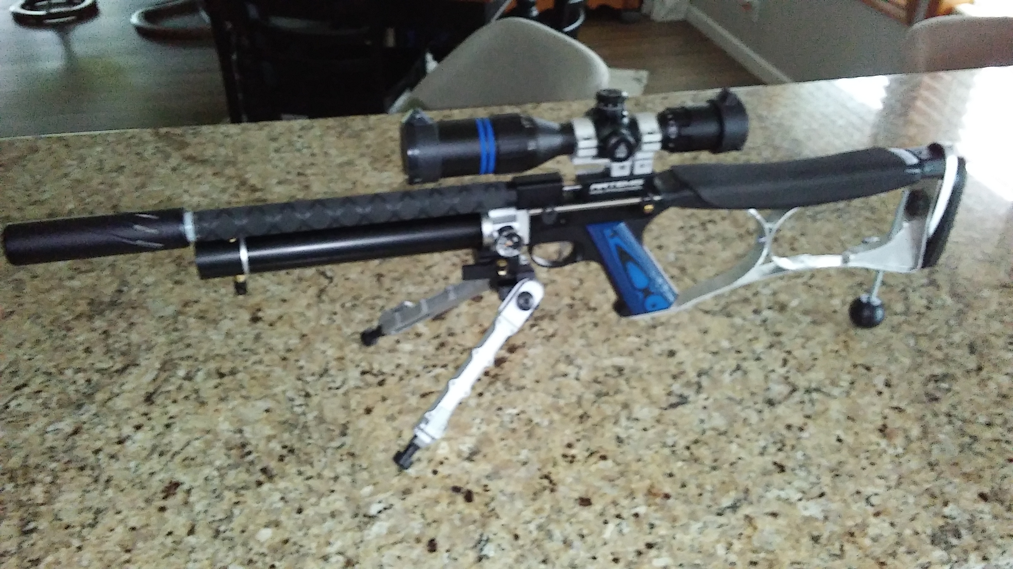

I have the Beeman 13615 .177 3500psi fill after changing the hammer spring to a softer spring tuned to about 840 I get 80 shots before hitting the reg set point
I paid 249.00 for this gun and have seen them for less. I own several Beeman airguns see sig
bipod 20 bucks temu 18-14 cf tube ten bucks big river TKO mod 79 bucks prism scope 4x monstrum 109 These guns use beeman ,benjamin and avrenger mags or carm , ae swede, maple, and barra ya just cant go wrong for the buck oh hey forgot the barrel band from Buckrail 20 bucks
