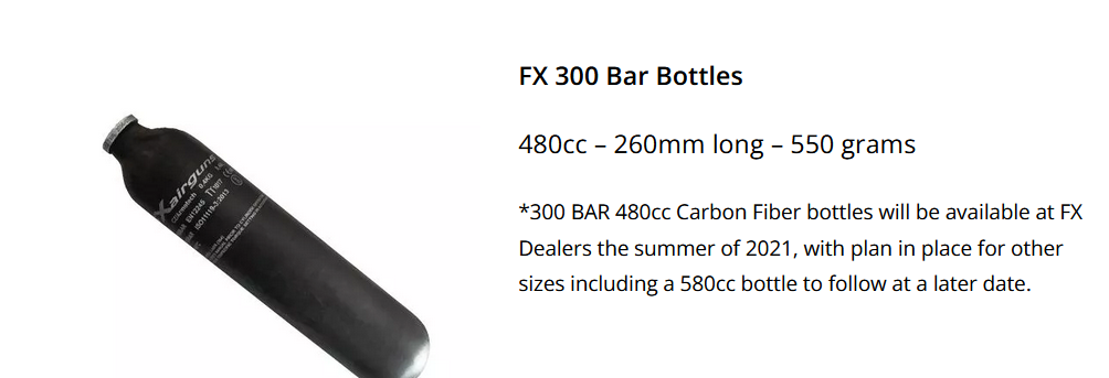

After reading everyone's reply and the response I got from FX I cancelled my order at Utah. FX has no plans as of right now of offering a 300 bar bottle.

Maybe the person you talked to at FX that said they had no plans for a 300 bar bottle could get on the same page as these people from FX. lol

The Regulator in the bottle adapter before the gun is where I got the idea of 300 bar. I hunt Coyotes with a Compact and thought it would give me a few extra shots. Now I just carry an extra bottle with me. Future plans are to carry 2 - 480 bottles, smaller diameter moderator and just leave everything 250 bar.
The person that sent me an email from FX USA will go unnamed. They obviously asked someone and that is the response sent to me. Quite frankly it doesn't really matter I was just thinking outside the box for my own situation.
