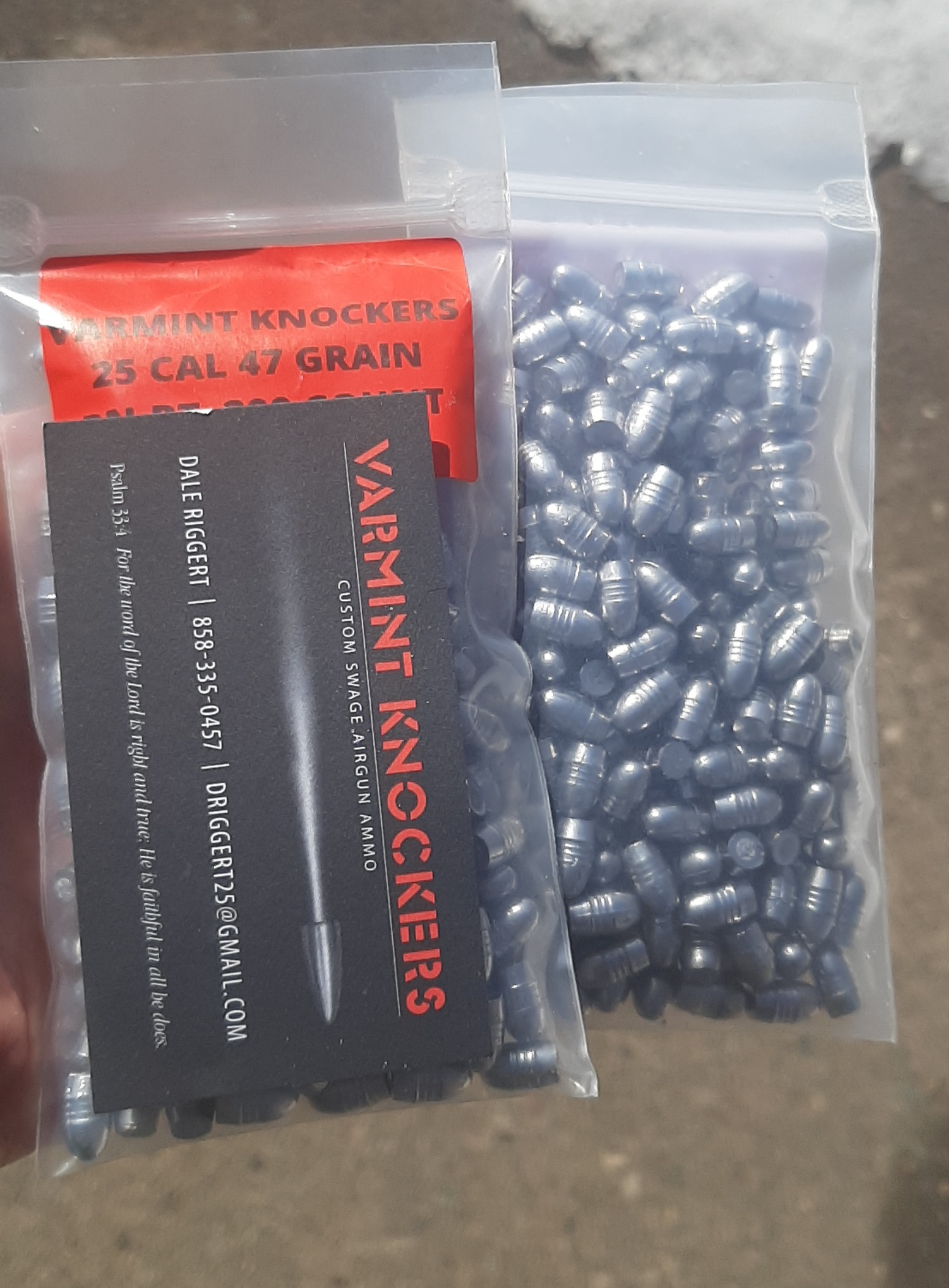

Recently in heavy winds I was hitting a fox sized steel at 250Y easily and out of a dozen shots I missed once just left when the wind let off. That was with 22 cal 15.75 twist barrel, Altaros 32.3gr slugs, going 829 fps, 49 fpe, in a Skout EVO. I've done the same thing with a 25 cal Vulcan 3 using 60gr Altaros slugs .245 BC at 862 fps/99 fpe.
However I'd still like one larger caliber pcp slugger. It'll probably be 45 cal but a .338 custom is more interesting in the hopes of finding a .5-ish G1 BC cast bullet.
