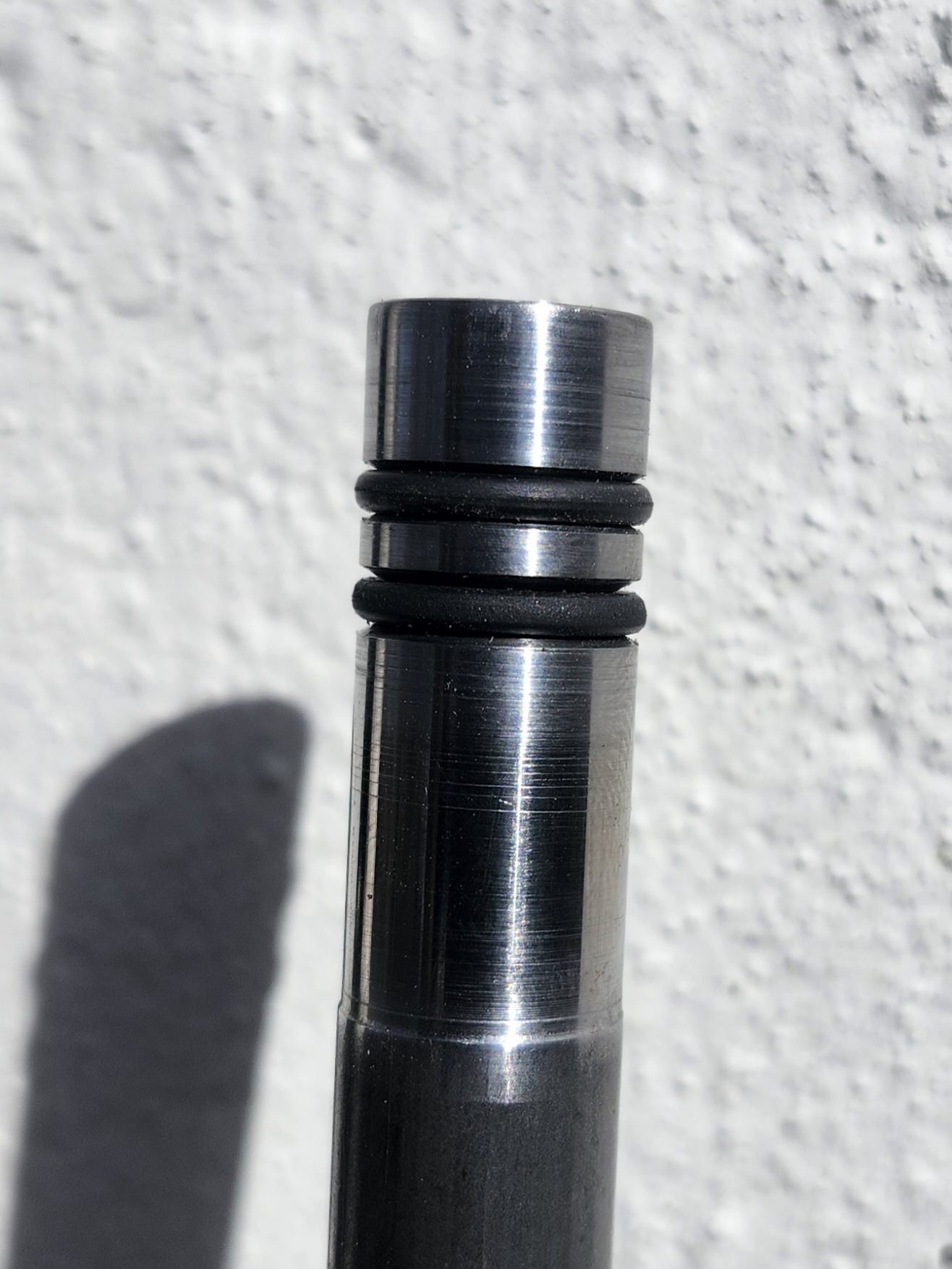

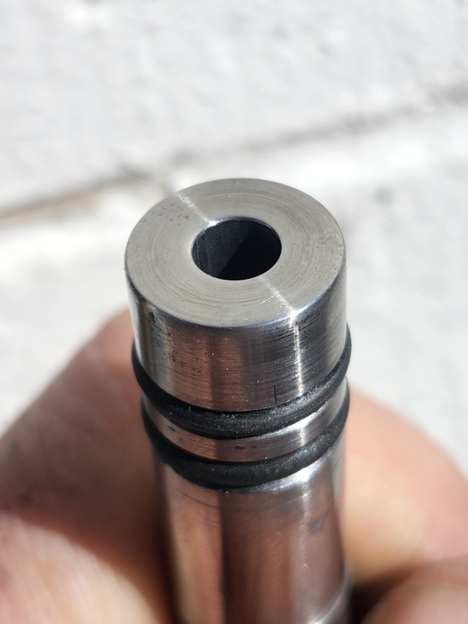

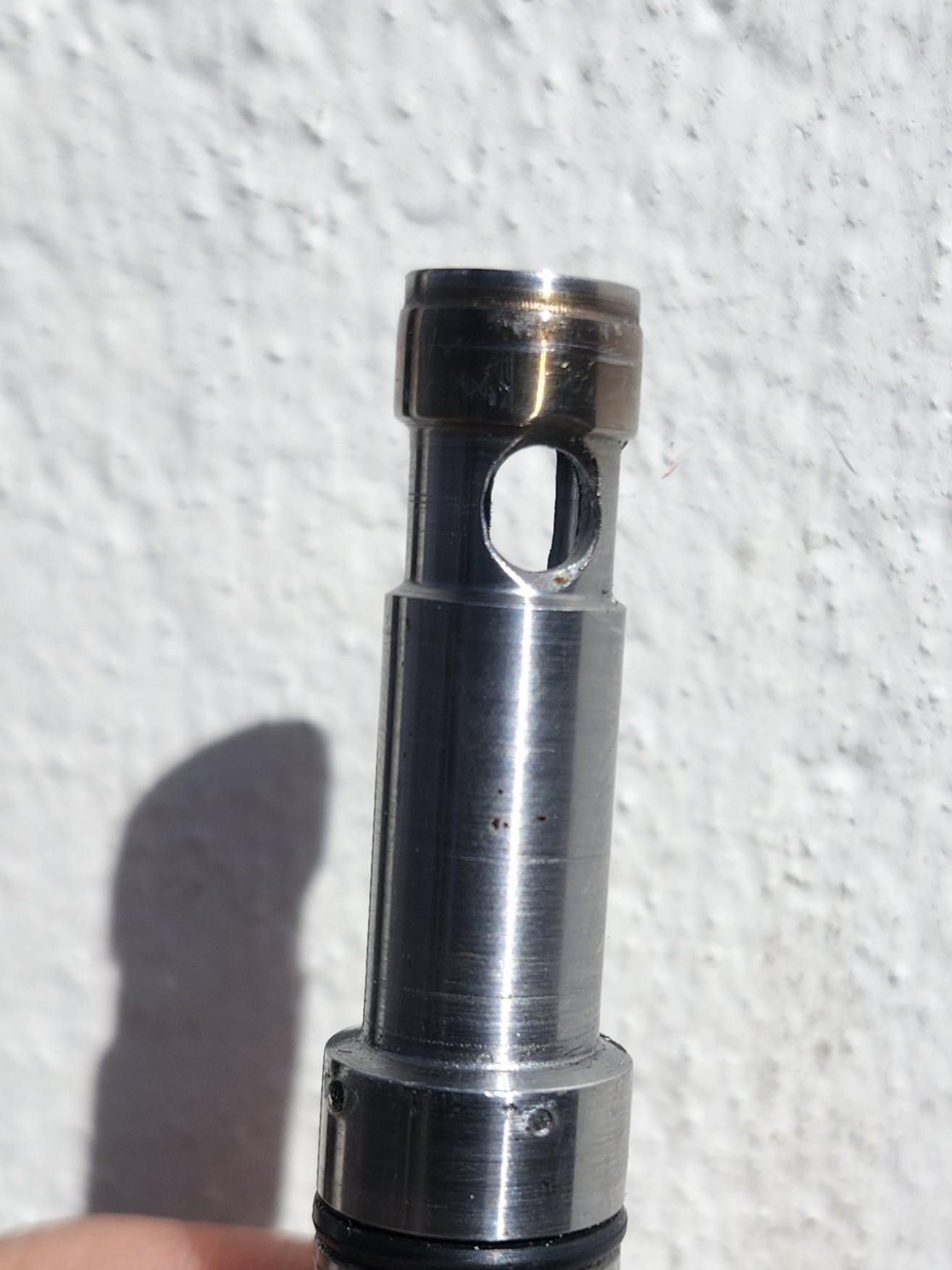

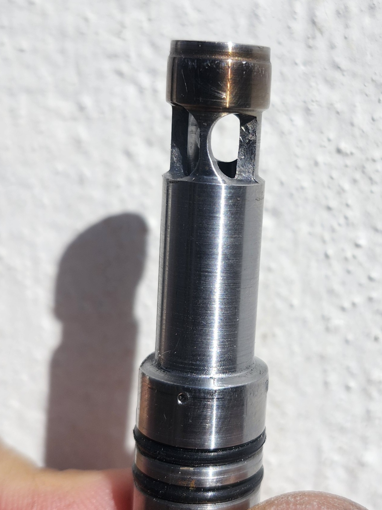

My custom designed 3 groove Hammerforged by TJ. Tested very well with both pellets and slugs. It's a .217 bore so anything .218 or larger didn't perform nearly as well as the proper sized slugs. 1in18" twist. Best for 24gr and under. FX Hybrids did exceptionally well. Uses a few barrel designs in one for the TP. Pellet port standard in most guns. A wide bridge TP like the RTI and both are combined with the channel recess which allows both ports to technically be used during every shot. Double redundancy on the Shroud/Airtube seals. Requires 3 different orings to fail on a single end before leakage. I've repaired many that get the factory oring seal cut during removal/install/swapping liners. This prevents that. You can remove both factory seals and still have two orings on each end to seal the airtube. Drop in ready. Lapped and polished. $275 shipped to your door.
CONUS only. This was the prototype test barrel for production
