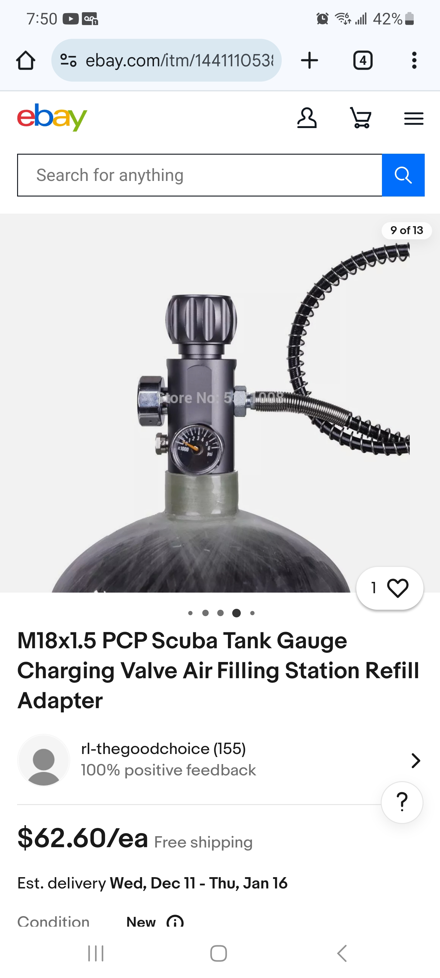

I use my own compressor so i bought the acecare 6.8l tank. I got the acecare Tank by itself and order this fill station. It's small and compact. Show both bottle gauge so you know what the Tank pressure is and also show pressure going into your gun. It have a quick fill so will fill any pcp with a quick fill. If you want to fill at a shop you will need a tank that is DOT like the great white. Which is about $700. Not worth it imo when acecare tank is like $200 for the bottle and $60 for the fill station.

I didnt purchase the chinese valves, I didnt trust it.
I received the valve, still haven't received the tank. The valve looks pretty decent to me. It's my third different valve system. One of them has a nicer gauge, but other than that, all very similar.
Is there anything I need to know when installing the valve in the tank? My other tanks came with valve installed, and have never been removed.
Dont overtighten the valve , so you dont destroy the o ring.
Simply hand-tighten the valve until it stops, then give it a slight extra turn—just enough to ensure a snug fit. The O-ring will create a proper seal over time.
It is not necessary to crank down on a tank valve. Bottle pressure alone keeps the valve from loosening. Please note that removing a tank valve can be a real problem when overtightening. In that case, because there is no wrench surface on a bottle, applying torque to the valve is almost impossible. A method I use is strapping the bottle longitudinally to a forklift fork with a cargo strap works amazingly well without damaging the bottle..
I have had some issues with Chinese tank valves, but none were safety related. They work fine. My issues were too heavy chrome plating creating oversize threads and another valve that leaked because a drilled hole was off center and caused an O ring leak.
