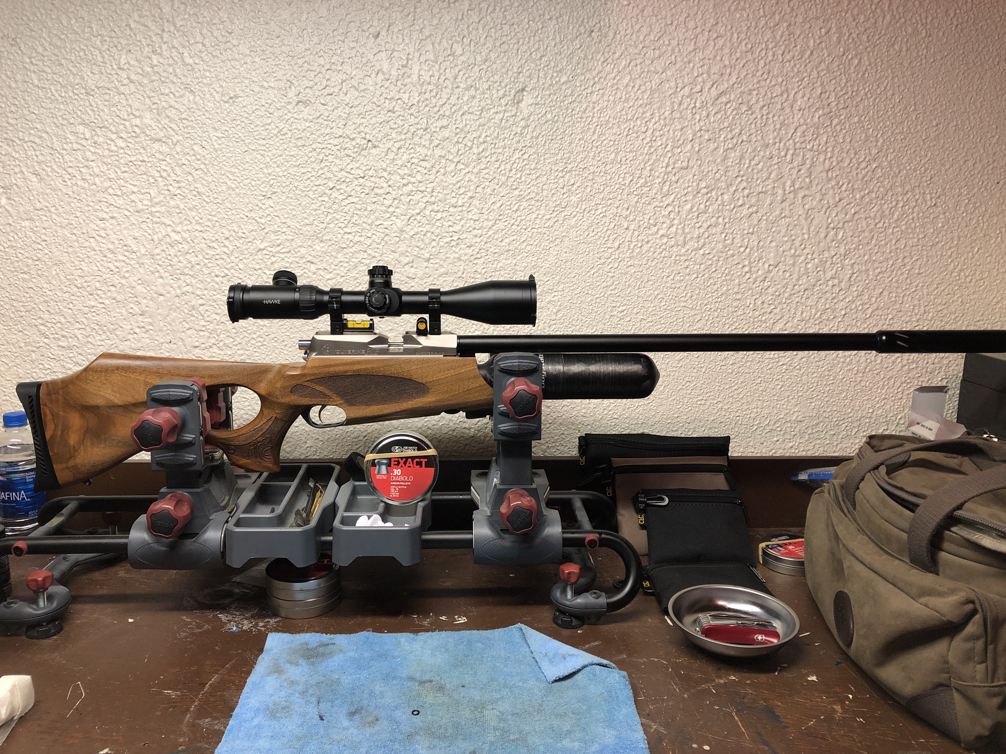

7 years using my FX Boss, .30 cal. for ground squirrels & rabbits. It's not overkill, the .30 is better for cutting through the wind, brush & br
30cal is my favorite caliber. Probably the best if anyone only wants or can only carry one gun with them. Not overkill for most small game and enough power for mid game. Big game too but i would probably only do headshots on big game and take extra care to place it in the right spot. Especially with horn bearing animals since theyre frontal skull is much thicker than non horn bearing animals.
