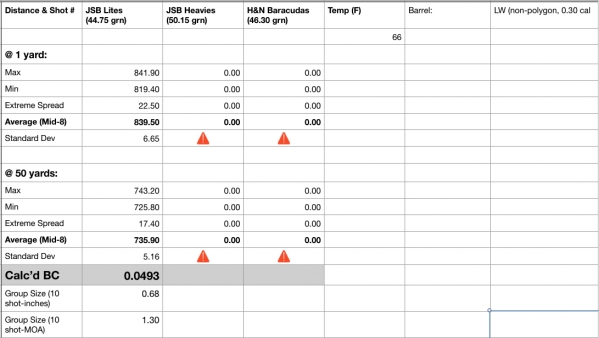

As expected, the warmer temps caused the BC to increase. I didn't test all 3 pellets, just the JSB lites to give me an indication of what would happen based on temp. I also didn't take my time to shoot groups, just wanted to get the BC data so I could move on to map the .25 caliber, LW (non-polygon barrel) to see what would happen there. I have that data now and will start another post once I've compiled it all. I'll also discuss the change in BC from the LW rifled (traditional) barrel to the LW polygon barrel-as there were some interesting findings there...
Here are the results for the .30 cal, at 66F.
1524627095_9204759165adff697811998.42230139_30 Cal BC Test at 66F, JSB Lite.jpg
Thanks again... Looking forward to your "procedure" so that when we do this we use the same baseline distances, etc. I think what surprised me the most is that the JSB Heavies weren't that much better than the Lites, and were actually worse than the H&N. Not sure it will be the same on a ST barrel, but we'll see. The BC for the Heavies are usually advertised as being approx. 0.01 better than the Lites. If you look at Chairgun, or Strelok Pro, it shows .042 or .043 for the Lites, and .051 or .052 for the Heavies, which is a considerable difference. We'll see when the data comes in on the .30 Bobcat Mk2. I have the Polymags, Lites and Heavies, but no H&N pellets to test...
