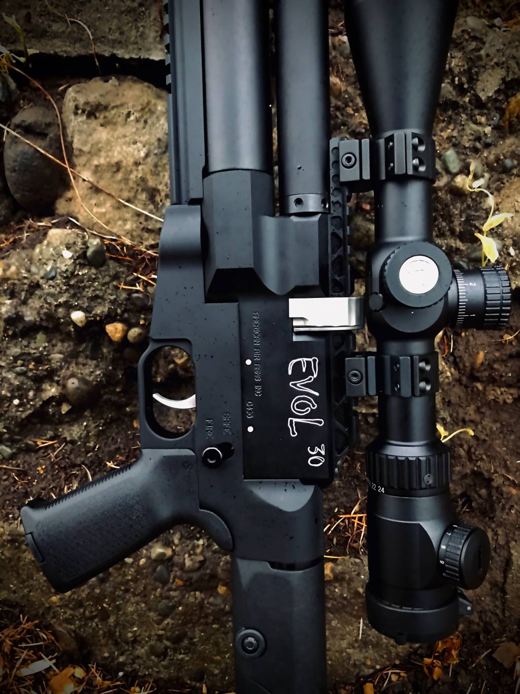

Not anymore. AoA is now the exclusive dealer for AAA. They regularly have the Evols in stock. I just checked right now and AoA has both the Evol 30 and Evol Magnon 30 in stock. The only model that there's a waiting list for is their Slayer, which has to be ordered directly at AAA. I think the Slayer would be more of an appropriate airgun for coyotes. I know one of our members here, mtnGhost, has tuned his Evol 30 up to 100 fpe with 62gr VK slugs. The Evols are in a class of their own. Love mine.
