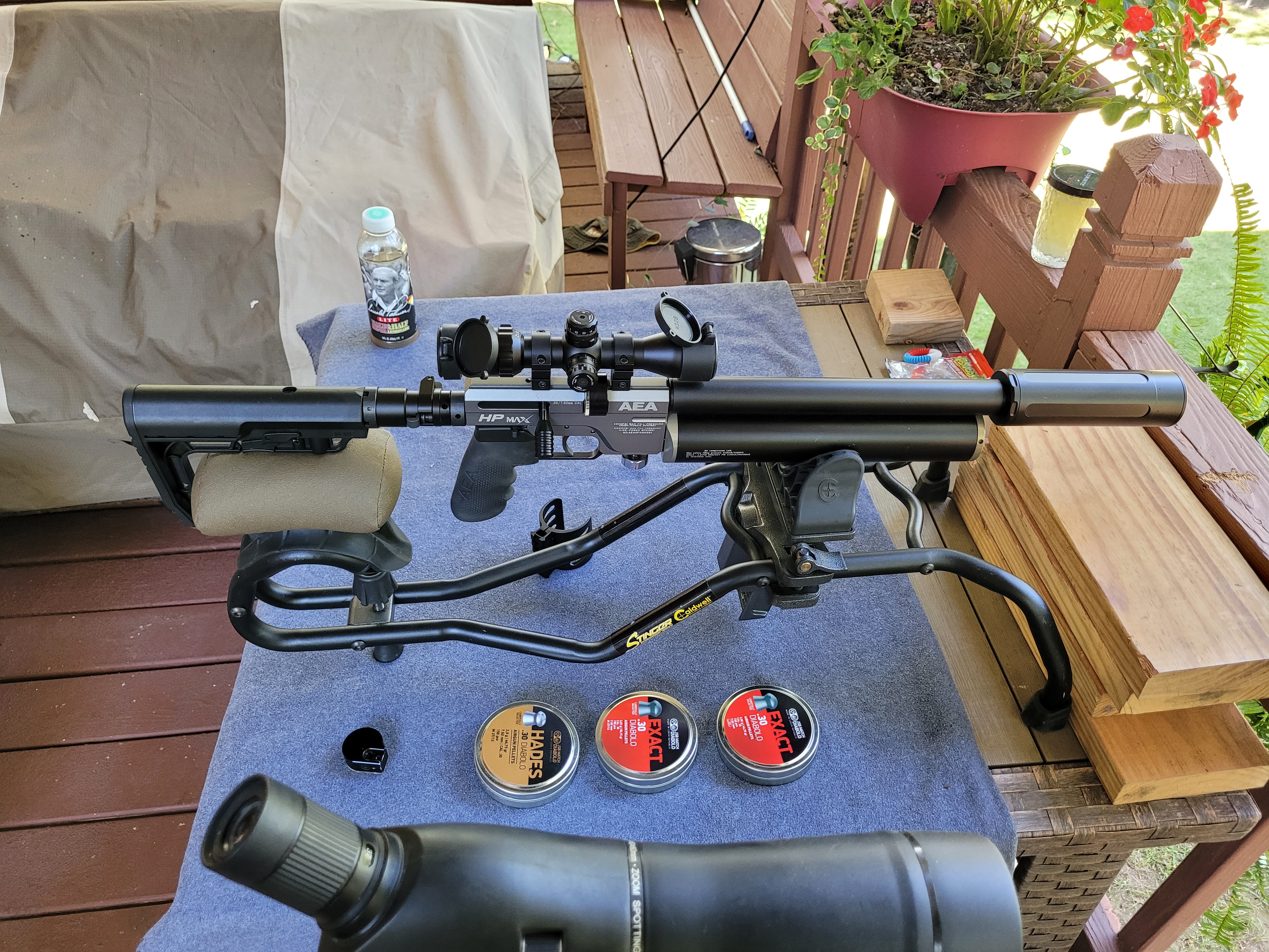

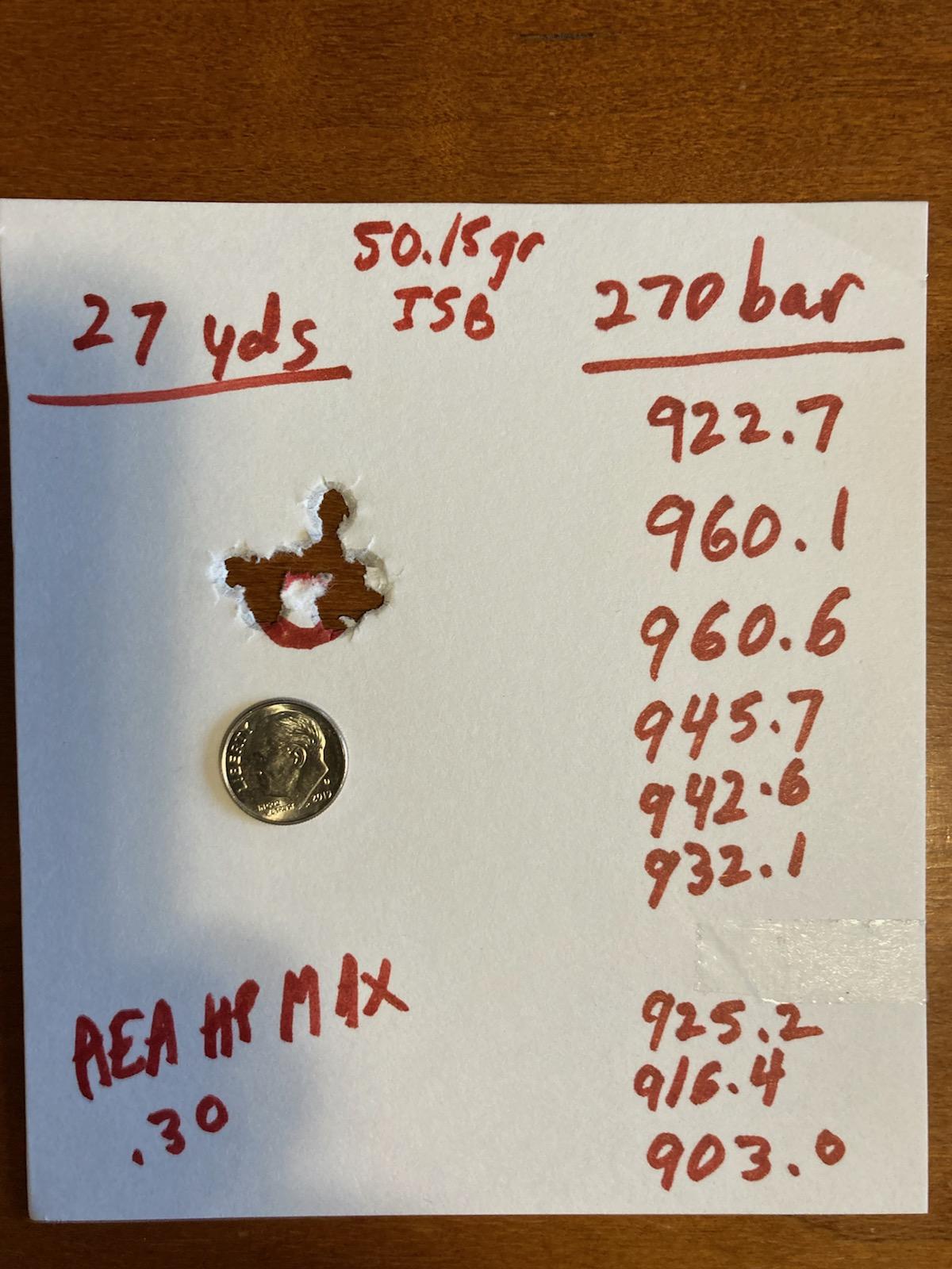

A jsb .30 50.1 @ 960 does a nice job. 102 fpe.
