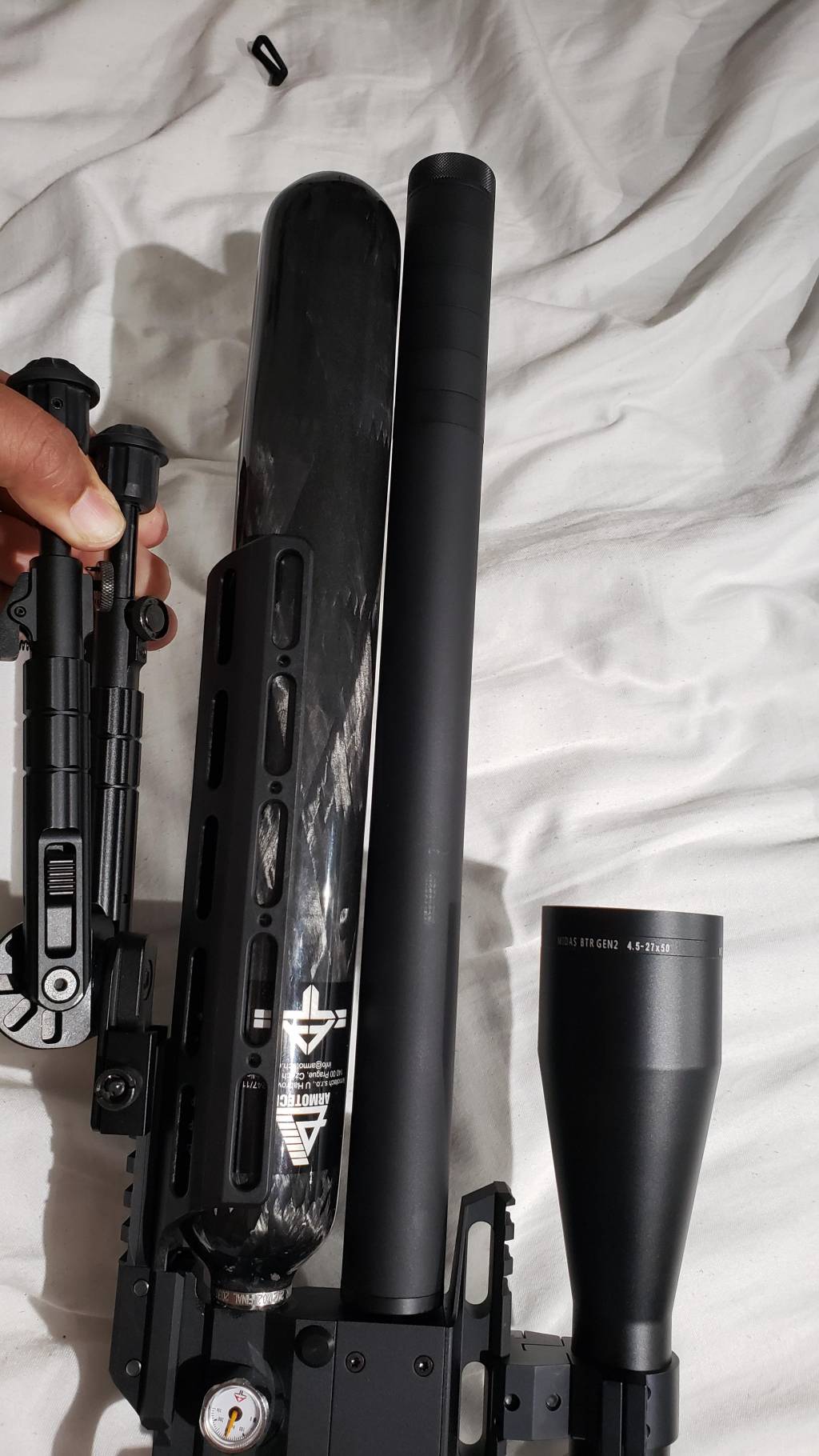

.30 cal Uragan..Arrived
You could clearly see the gap between the shroud and the bottle as it gets thinner to the front .. on the block the gap is like 3/16 but in the front only 3/32.so when you shoot you could hear the shroud taping the bottle..thanks
i think the bottle is tapered towards the block
As in larger out front to smaller at the block connection? That’s the only way that old have to be on the bottle in order to have the larger gap at the block end. I can surely be wrong, but I’ve never seen a bottle purpose built with a taper. One sure way to check is to pull that bottle guard off and throw calipers on it and measure at least at three points.
Now to me, looking closely at the pic, it looks as if where the bottle attaches to the block, that attachment may be a separate half separate from the block above I wanna is a way that the barrel exits from, and for sure that piece is installed at an angle, causing the bottle to angle upwards and it front. If that bottle connects on piece surely is a separate piece, it needs a whim of some kind to straighten it out. Another her thought is the nipple on that bottle may have gotten bent, like as if the pic rail below the bottle slammed up against it, like maybe during shipping.
May I suggest that the owner send a pm to either VMAXPRO or Derek why goes by ZX10WALL(I believe). Take a close look up pic of that area around the block, and send it to them to compare against their Uragans.
Those two, boys the way, are the Uragan pros. They both know that gun in and out.
