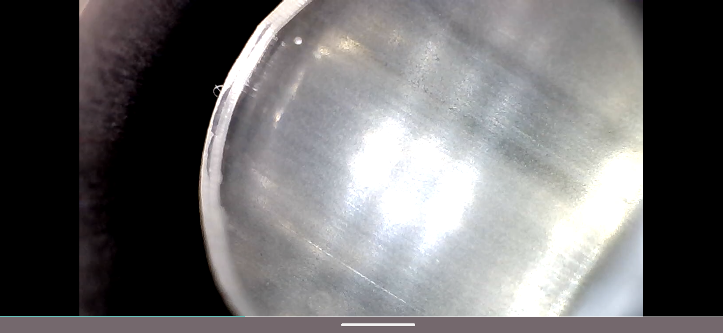

I have an early batch superior slug and it has about zero grooves...it's almost a smooth bore. That little glint that looks like a scratch is a rifling impression.The whole batch of Superior SLUG .25 liners was defective and it shot like a crap. Superior HEAVY should be fine though.
Exactly. Any accuracy out of this crap?I have an early batch superior slug and it has about zero grooves...it's almost a smooth bore. That little glint that looks like a scratch is a rifling impression.
