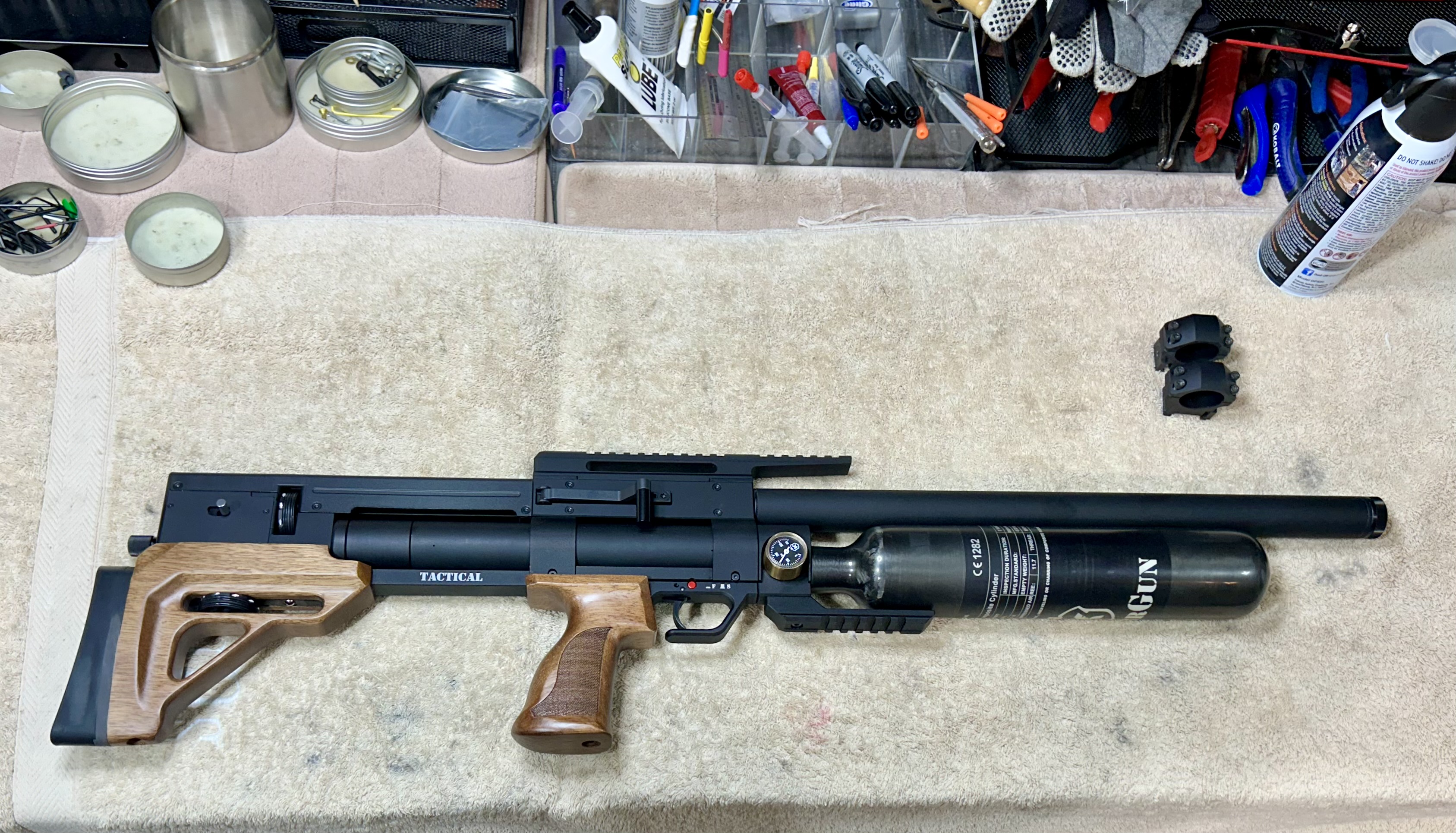

It’s been awhile since I’ve posted anything. Tuned a Cricket 2 Tac that came out great and thought I’d share. The Old Crickets are still hard hitting and accurate with great regulators! I did some porting on this barrels transfer port, changed out the valve spring and cut a custom hammer spring. Tuned for the 56gr Zan pellets at 880 fps. I also did my mod on the magazines which helps smooth indexing. Here’s the chrony string from a 260 bar fill down to the 150 bar reg setting. This is with the 580cc factory bottle:

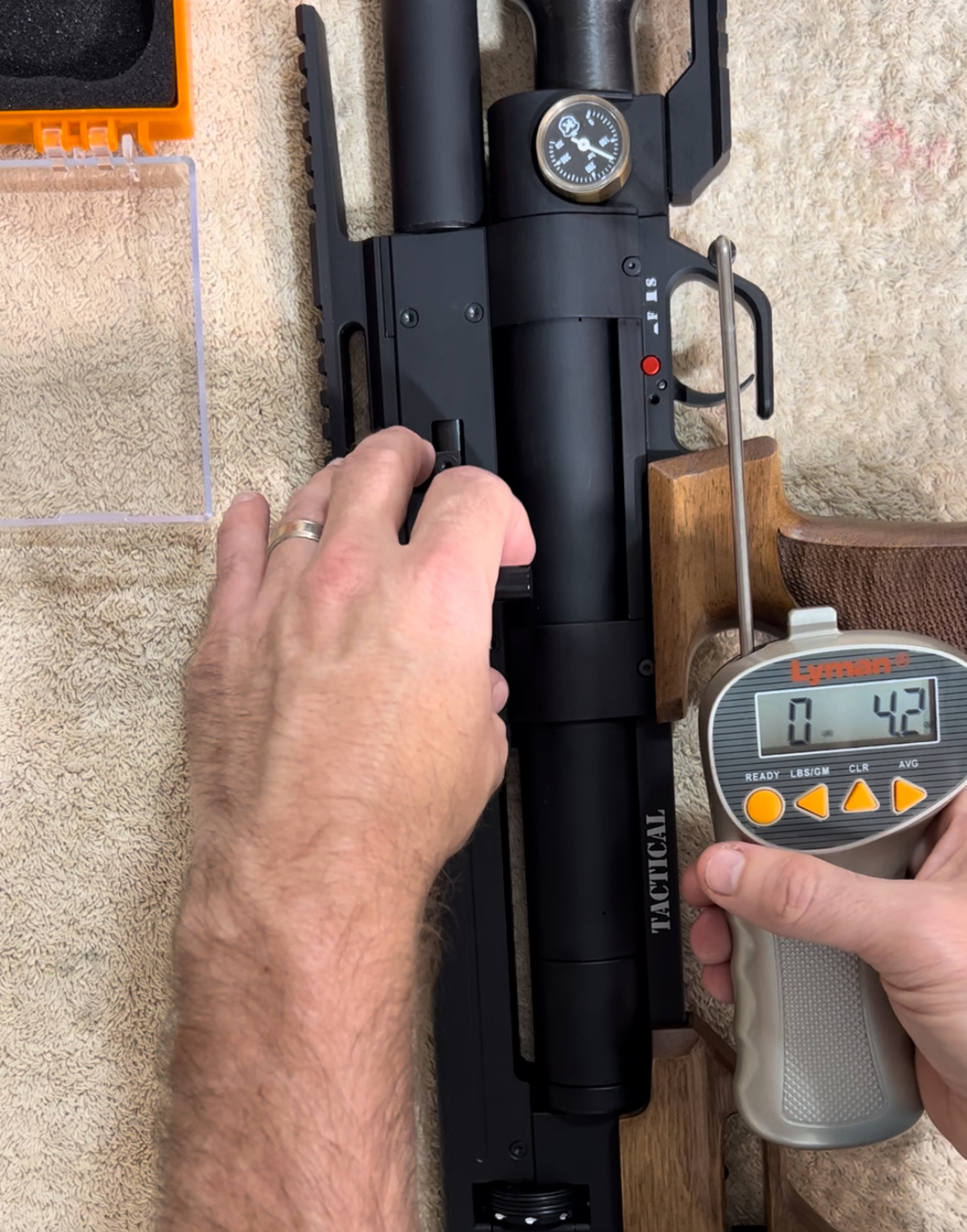

Tricked out the trigger for a 1 ounce first stage to a 3 ounce second which breaks very clean at 4 ounces.
