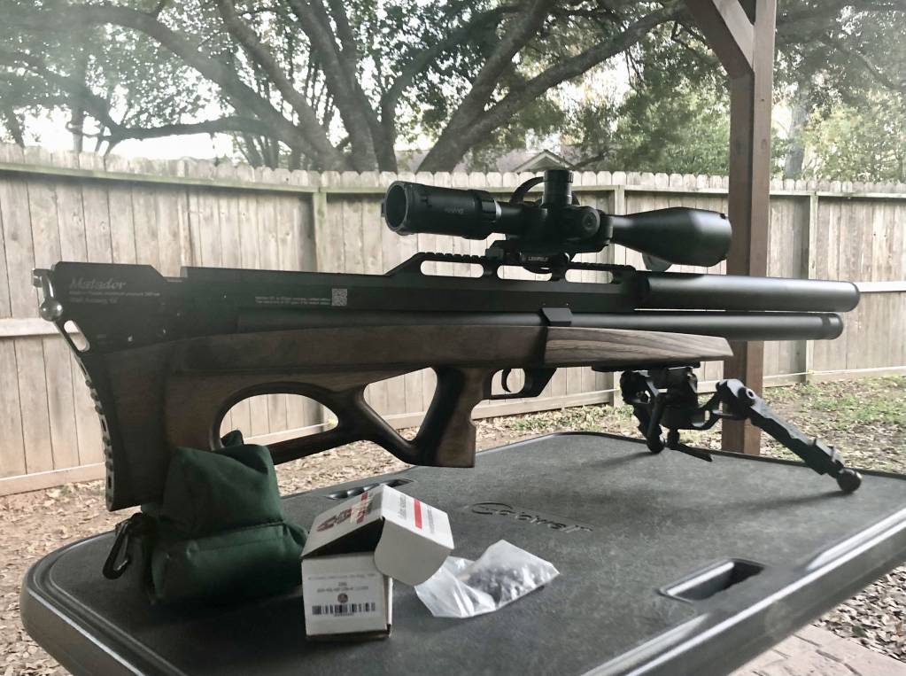

Client wanted his .30 Super Long to sling the 47.2gr NSAs. Tuned it up; Huma to 142 bar, cleaned crown, leade and polished the bore. Set tension to 10 ft/lbs. Completed a trigger job which took away the obnoxiously looong first stage travel. Set it to a lighter than stock first stage to a second stage wall that breaks at 12 ounces with no creep. Lubed action and changed o’rings. Lastly, I messaged it all in. Sends the said slugs at 955 fps. 100 yards:
