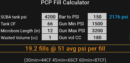

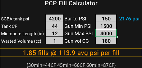

My calculator for pcp fills attached, you won't get many fills to 4k from 1,500 psi with only 4200 psi in the tank
As you reach 4k in the tank, you'll have to fill around 113~ psi less each fill after the first 1~, and then a partial fill after...and for each fill after that, you'll be able to fill to 3900, 3800, 3700, ect...
With a lower fill pressure, say from 1500 to 3200...
