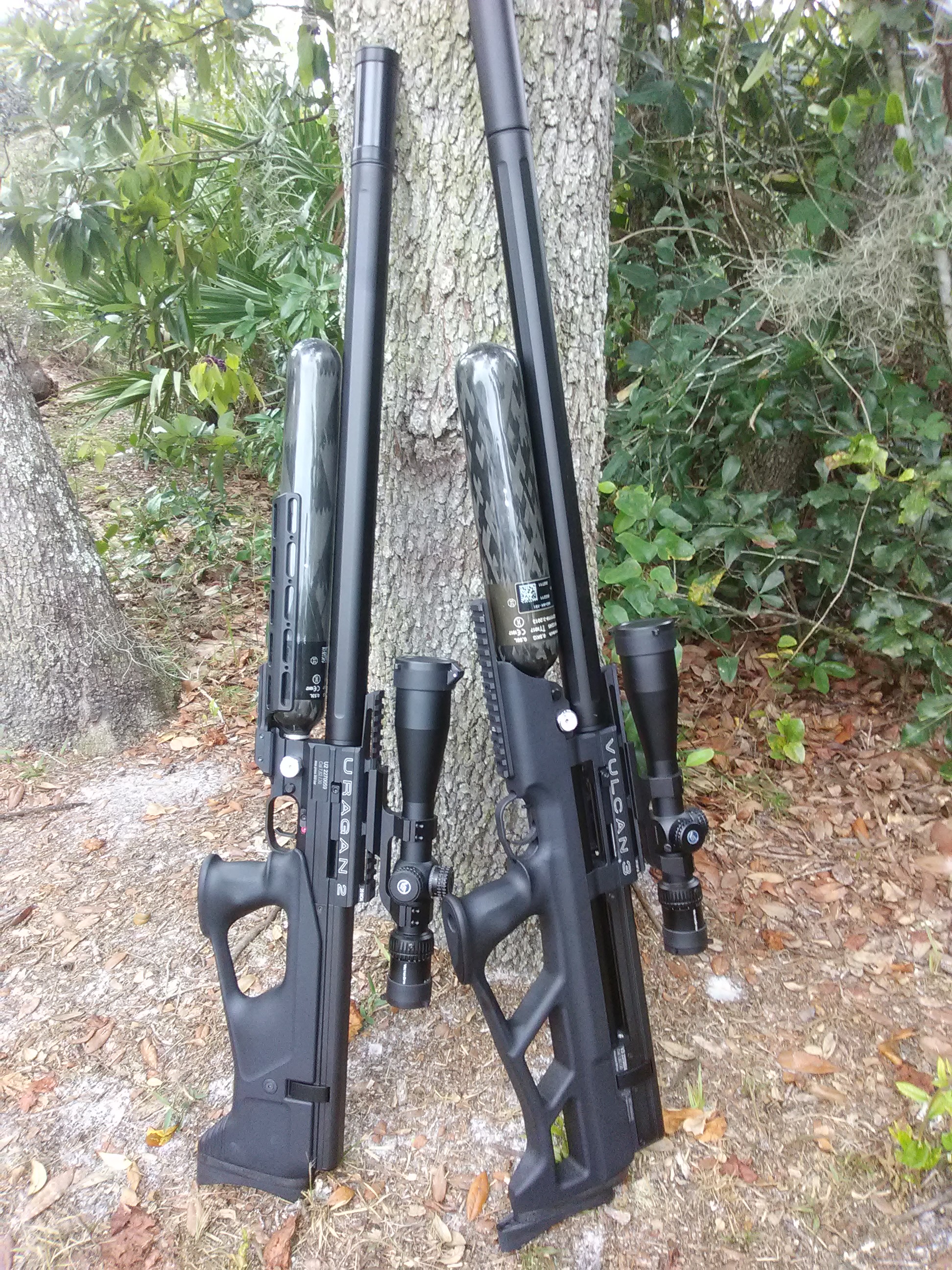

Either of these .30 700mm would suffice. Of both, prefer Uragan 2, smoother, quieter, less ammo fussy. WM

Either of these .30 700mm would suffice. Of both, prefer Uragan 2, smoother, quieter, less ammo fussy. WMView attachment 480593
Thank you for insight...personally I've always thought bullpup rifles were hideous. But you have opened my eyes to a different train of thought. I've spent alot of time today researching these 2 guns. And they have made it to the top of the list in a .30. Once agian thank you
Thank you for insight...personally I've always thought bullpup rifles were hideous. But you have opened my eyes to a different train of thought. I've spent alot of time today researching these 2 guns. And they have made it to the top of the list in a .30. Once again thank you
Bullpup ARE THE BEST OF THE BEST!
