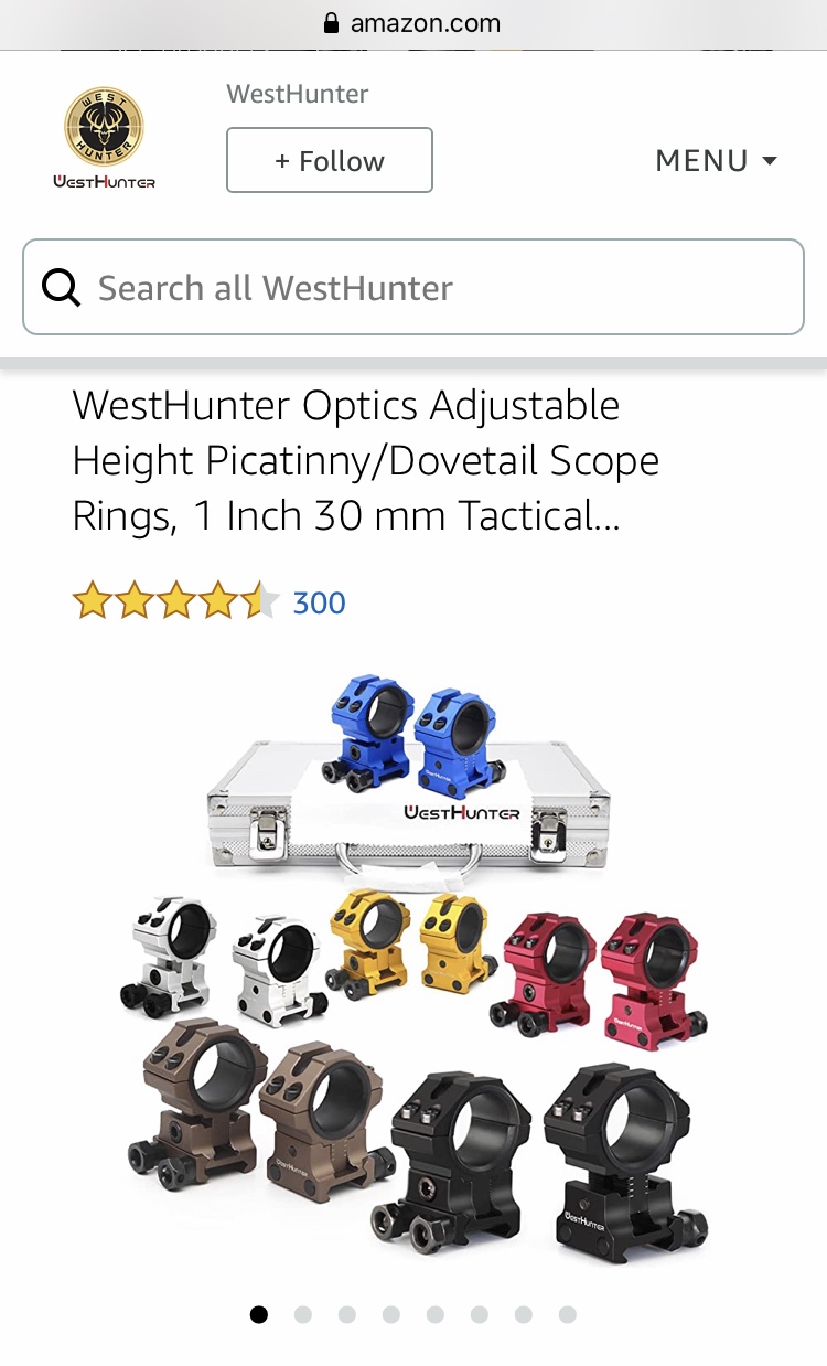

I’ve found a really good value set of rings recently. WestHunter Optics on Amazon. They are about 30 bucks a set. These are pretty dang good rings. I was surprised at the quality and have bought several more sets since the first one.

qball, I bought a set of those and was totally surprised as to how nice they are. Should have bought 2 sets
I have to disagree with west hunter while mine looked nice they were made so poorly I could not even hit paper left to right with 2 different good scopes both over $1500 price point , I liked the looks how the cant angles have like a splines so it locks unlike say no limit rings which lock by the interference angles , I guess for me I have to stick with ones which never failed me

The West Hunter rings do allow for height adjustment, but the way the teeth are ground on the elevation seems to mean it can't pivot for alignment. So, if you need the scope elevated in the rear (shimmed if you will) the rings will apply pressure unevenly to the scope. Old timers can get pretty picky about the alignment of the rings stating that uneven pressure will increase the chance of crushing the scope. I get the idea, but have used shimmed rings and never had a problem with a crushed scope.
I may have to buy a set of the West Hunter rings and try them out. I've seen stuff like this before but never tried them. Looks interesting.
A lot of the things we airgunners use is way overkill. Do we need a $200 one piece scope mount and $2,000 scope to shoot 10-100 yards, on a gun with almost no recoil? Absolutely not. In the engineering world it is called "fitness for purpose". It only has to be good enough for its purpose. The West Hunters certainly look interesting. I'm going to put a set in my cart right now.
West hunter is best of the best, all of our friends own M2 and M3 all have them, From Nightforce to Element Nexus.
