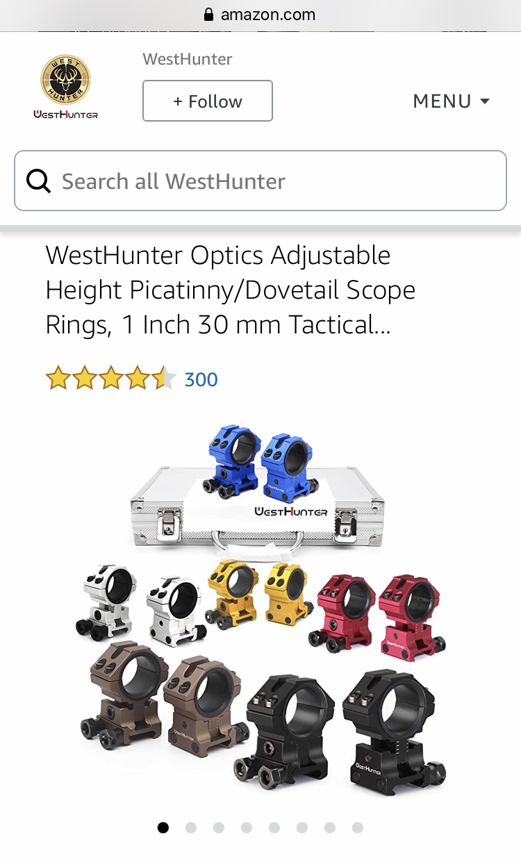

I’ve found a really good value set of rings recently. WestHunter Optics on Amazon. They are about 30 bucks a set. These are pretty dang good rings. I was surprised at the quality and have bought several more sets since the first one.
Please note the key words, "adjustable height". You cannot cant these. I've got some, they keep the scope off of the ground just fine.
