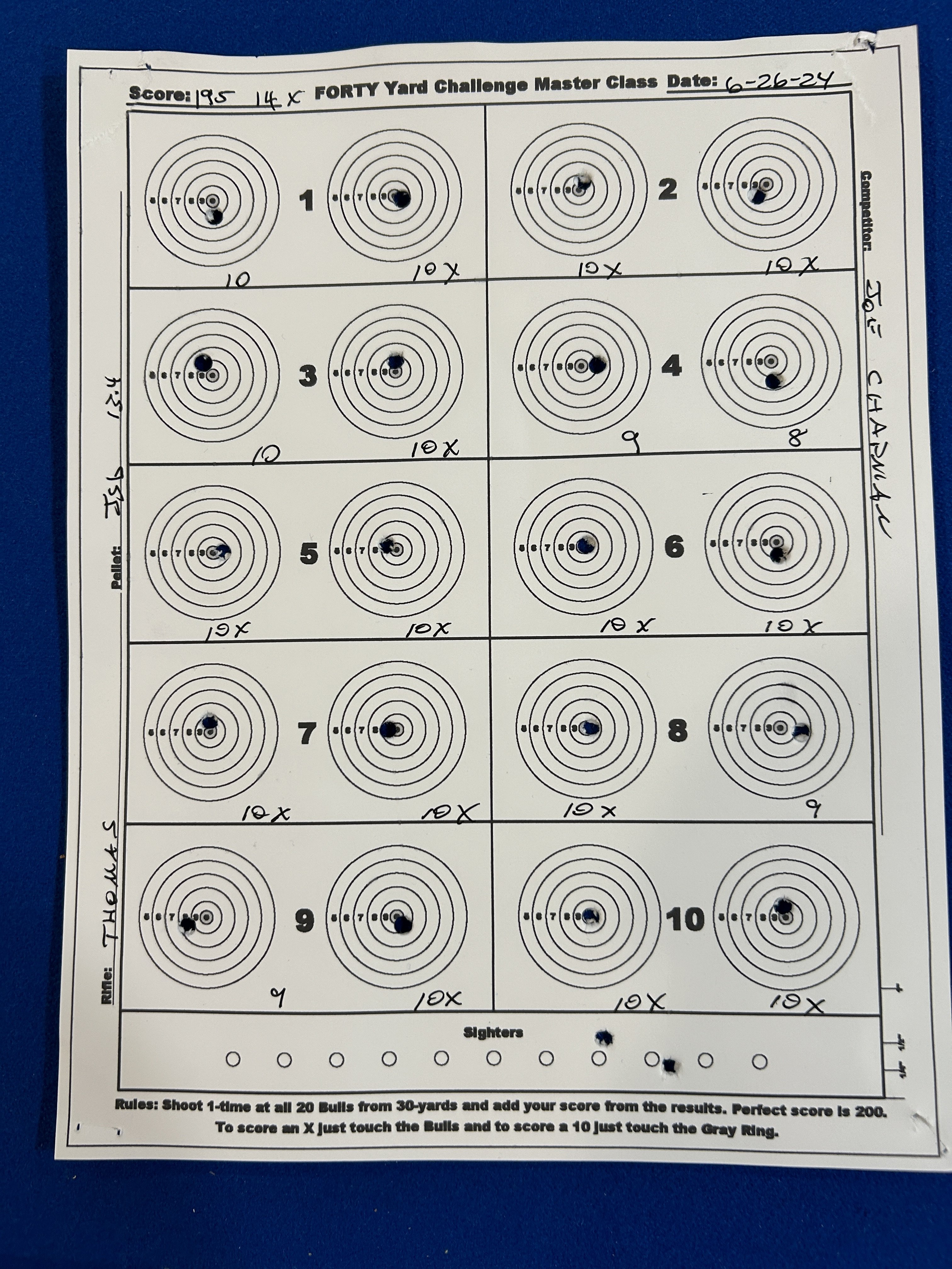

Shot a card today, score is low but I’m actually quite happy, it was very windy in Mi. Today! A couple other notes I would like to share. I adjusted the crosshairs for the most consistent condition and never looked through my scope again, only pulled the trigger when the condition came to me! (Trigger finger was only thing touching the gun. Also shot the scope on 16x?View attachment 475013
Great 40Y Masters card. Anything north of 190 is really good for this small bull at 40Y.
I understand waiting for your ideal wind condition and using that same hold for each bull, but how do you not look thru the scope when you move from one bull to the next? Also know that the Thomas rifles can just use the trigger only gun touch point.
Reactions: NAProf

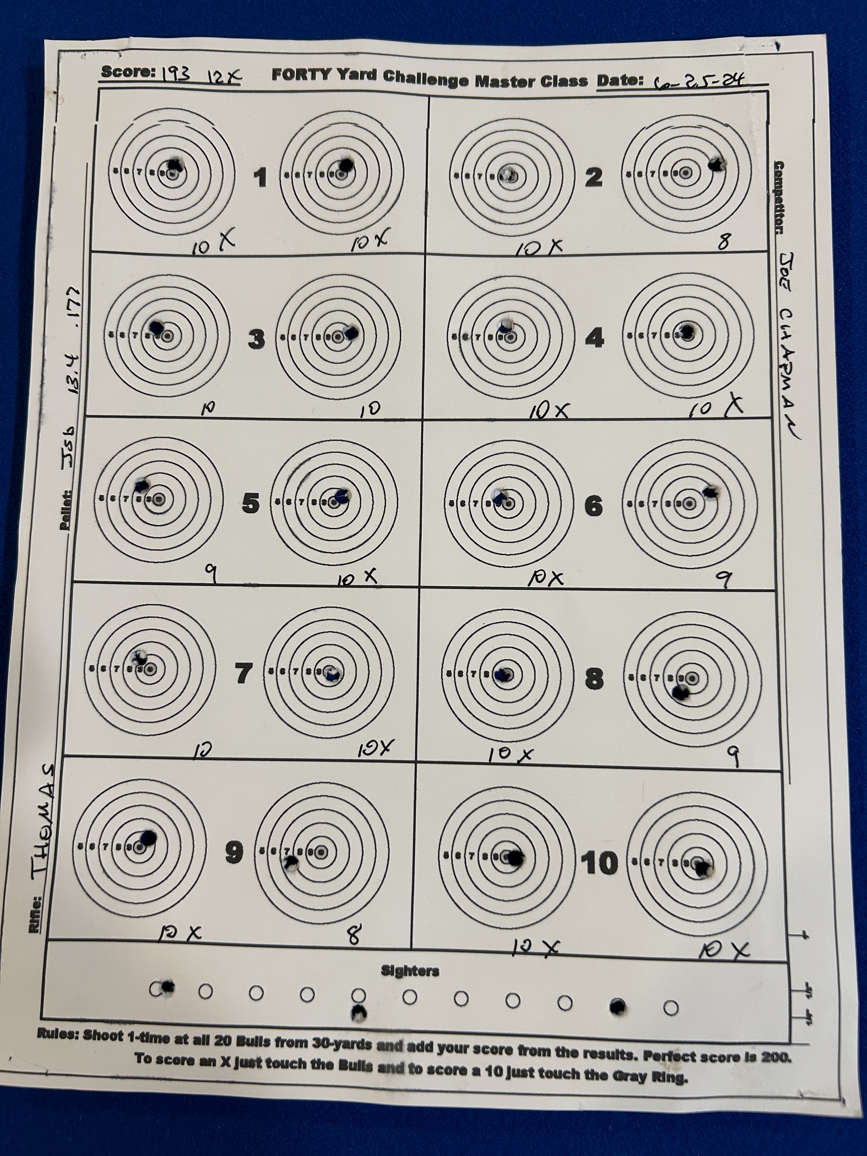

Card today, some vertical not cool!
I looked through the scope to place cross hairs on each bull but in the same spot on each bull, then waited for the same condition and pulled the trigger but didn’t look through scope till after the shot was fired then on to next bull. So on and so on!

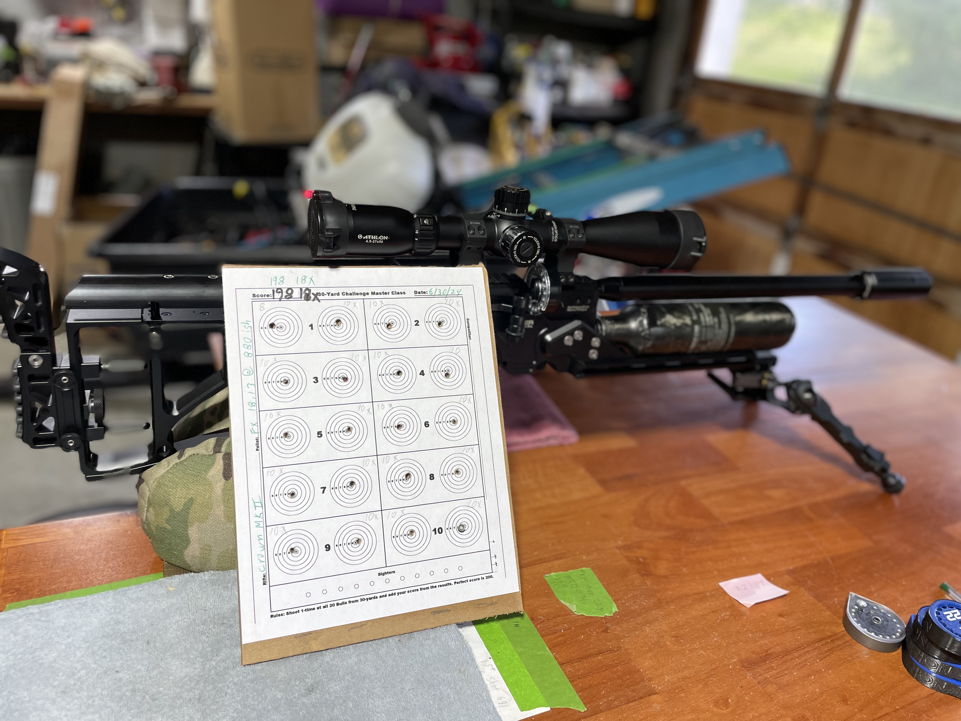

Shot this yesterday at the end of the day, any shot I was unsure of, I stuck a pellet in the hole as a gauge. What size is an official .22 scoring plug? Forgive me if the answer is .22 … These targets printed slightly undersized, so the 1/2” scale measures 7/16”
Shot this yesterday at the end of the day, any shot I was unsure of, I stuck a pellet in the hole as a gauge. What size is an official .22 scoring plug? Forgive me if the answer is .22 … These targets printed slightly undersized, so the 1/2” scale measures 7/16”View attachment 476685
Scotty - looks like a solid 198 to me.
Go back one or two pages and Ed posts the link to get the.177/ .22 cal scoring plug - cheap.
Very good card!
Tom
Reactions: Scotty1
nice shooting , i only have a .177 plug so ? i think a pellet will work .
