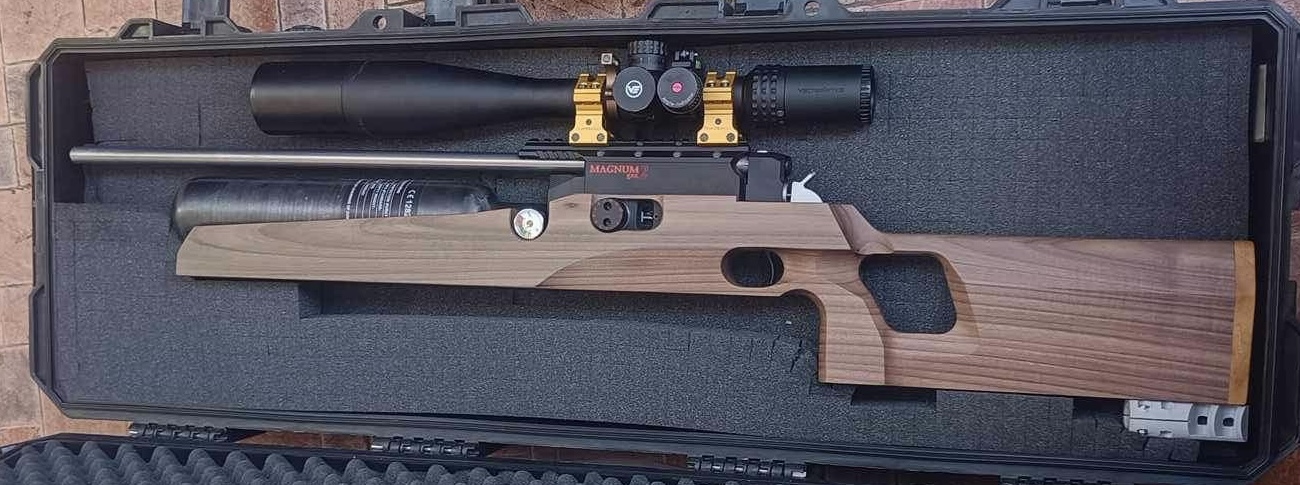

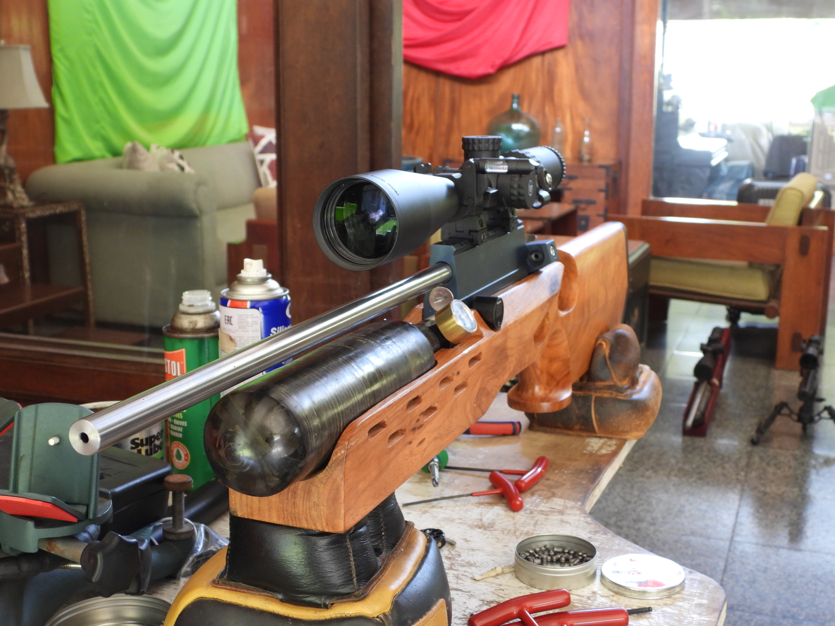

Interesting Redwolf custom. Benchrest type stock and it looks like a regulator added behind the bottle? Or does it still use the Daystate electronics to regulate velocity?
Is the barrel still the original Daystate barrel or a custom LW poly?
Do you prefer the QYS pellets over the JSB? We don’t see QYS much in the USA.

I had a BR stock made for my RW because I’m planning to use is as a dedicated WRABF BR25 LV/HV rifle.
I placed a bottle regulator to make it easier fortuning the different settings on the Helliboard and make the rifle more consistent than the original GCU.
My DSRW HP was originally in .22 cal and I just converted it to .177 by purchasing a LW slow twist polygonal choked blank 16mm OD, machined it to fit the receiver as well as the o-ring grooves and transfer port.
I ran out of JSB 10.34 so I just used my QYS 9.56gr Streamlined (6 tins left). The JSB 8.44’s I have are all damaged due to shipping and I cannot use them for br25 meter competitions due to mangled skirts.
I still haven’t found the perfect setting so that will just be temporary.
-Ricky

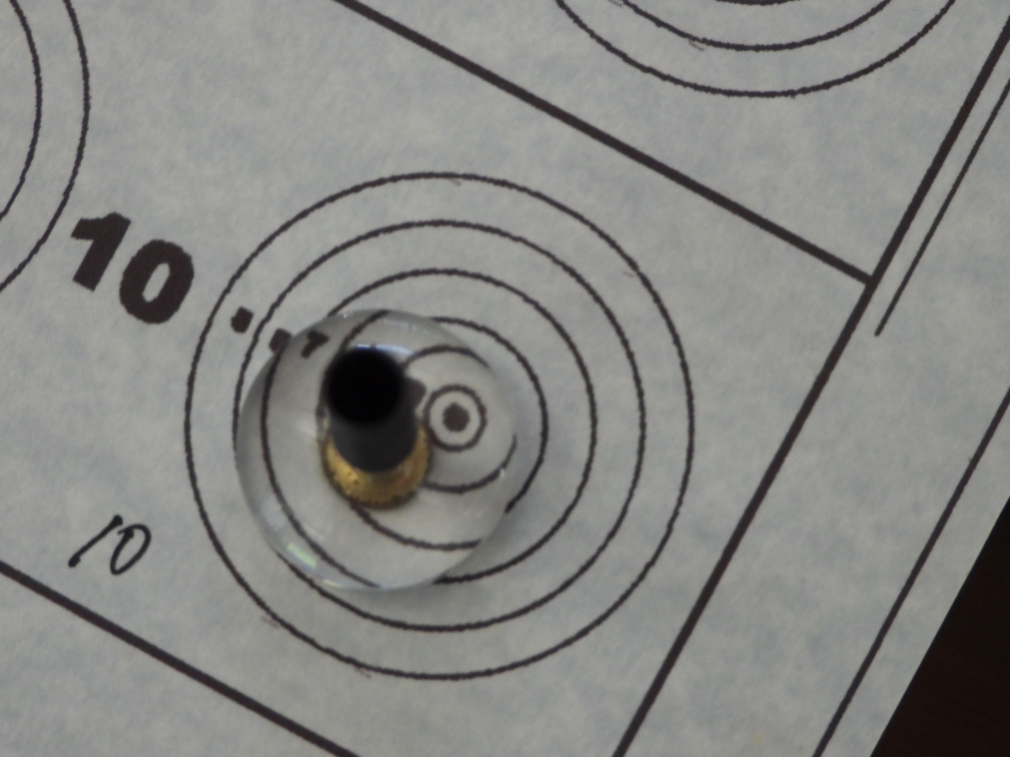

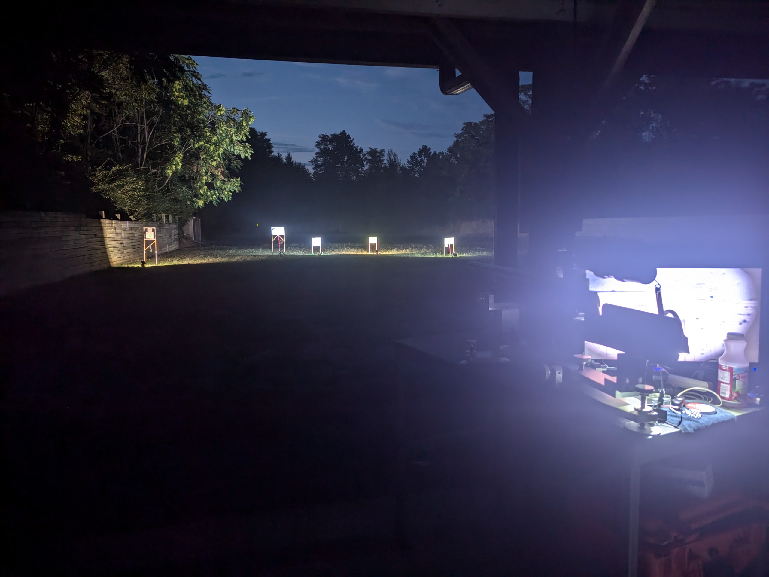

Had a chance to do some night shooting on our range tonight, I shot the 30-yard challenge target. The wind laid back and was almost nothing, but I think I had some thermal up drafts because the wind flag under my target was swinging back and forth like a pendulum, it made shooting quite interesting. I was shooting a RAW bench rest .177 cal with a Sightron 45 x ED scope JSB 10.34 pellets at 715 fps it is a 11.44-foot pound gun. I use a Bestsight scope cam hooked up to a 22" monitor makes it easier on the old eyes;) I plugged the targets with a .177 cal shank plug with a .223 rim, looking thru a 30-x magnifying glass I know that target 12 looks way out but the plug did cut into the 10 ring.

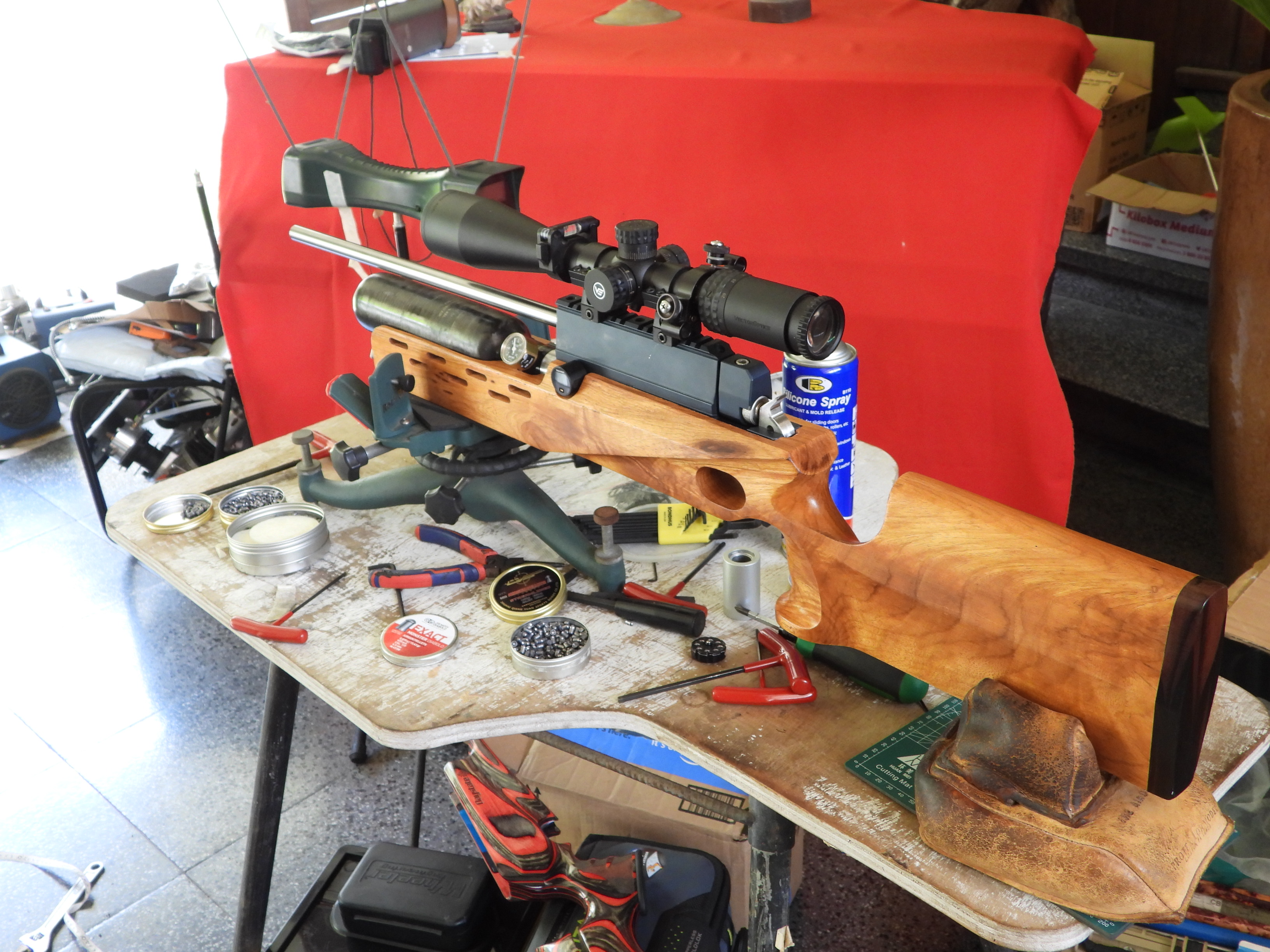

Rifle: WS Airguntech made in the Philippines 🇵🇭
Barrel: Lothar Walther 1:36 Polygonal Choked Chromoly

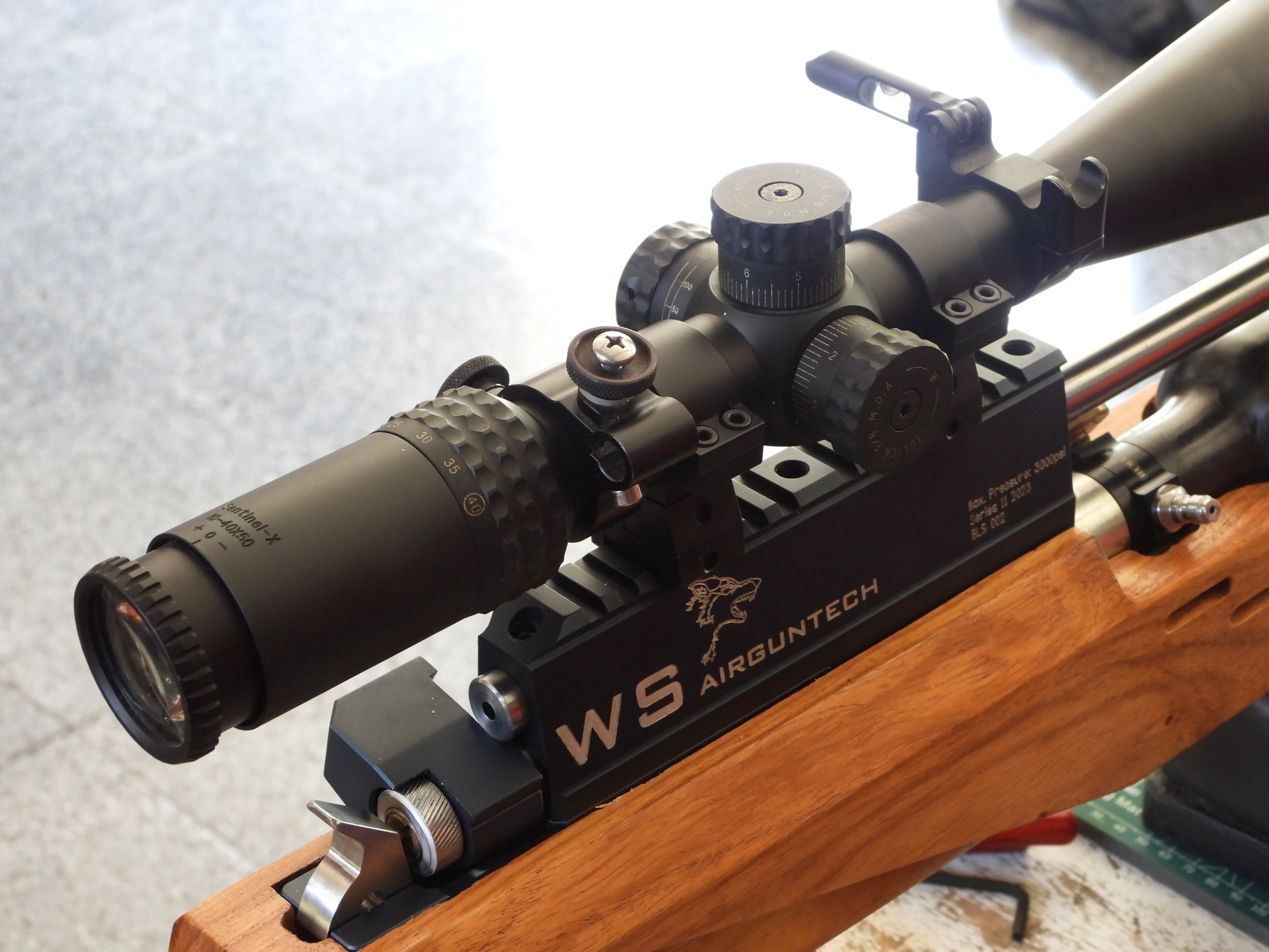

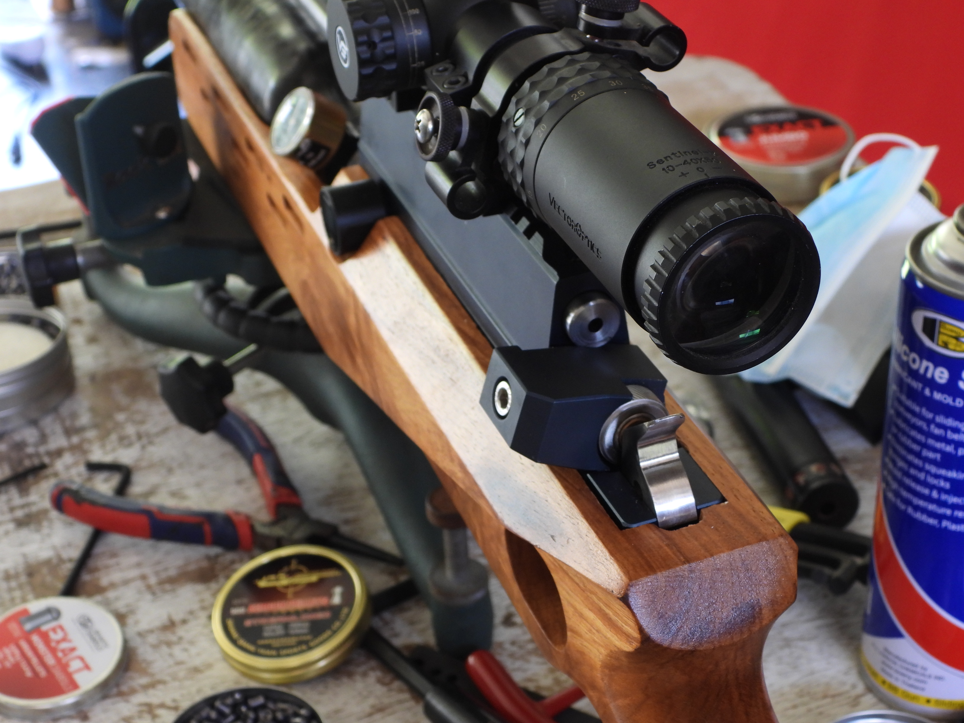

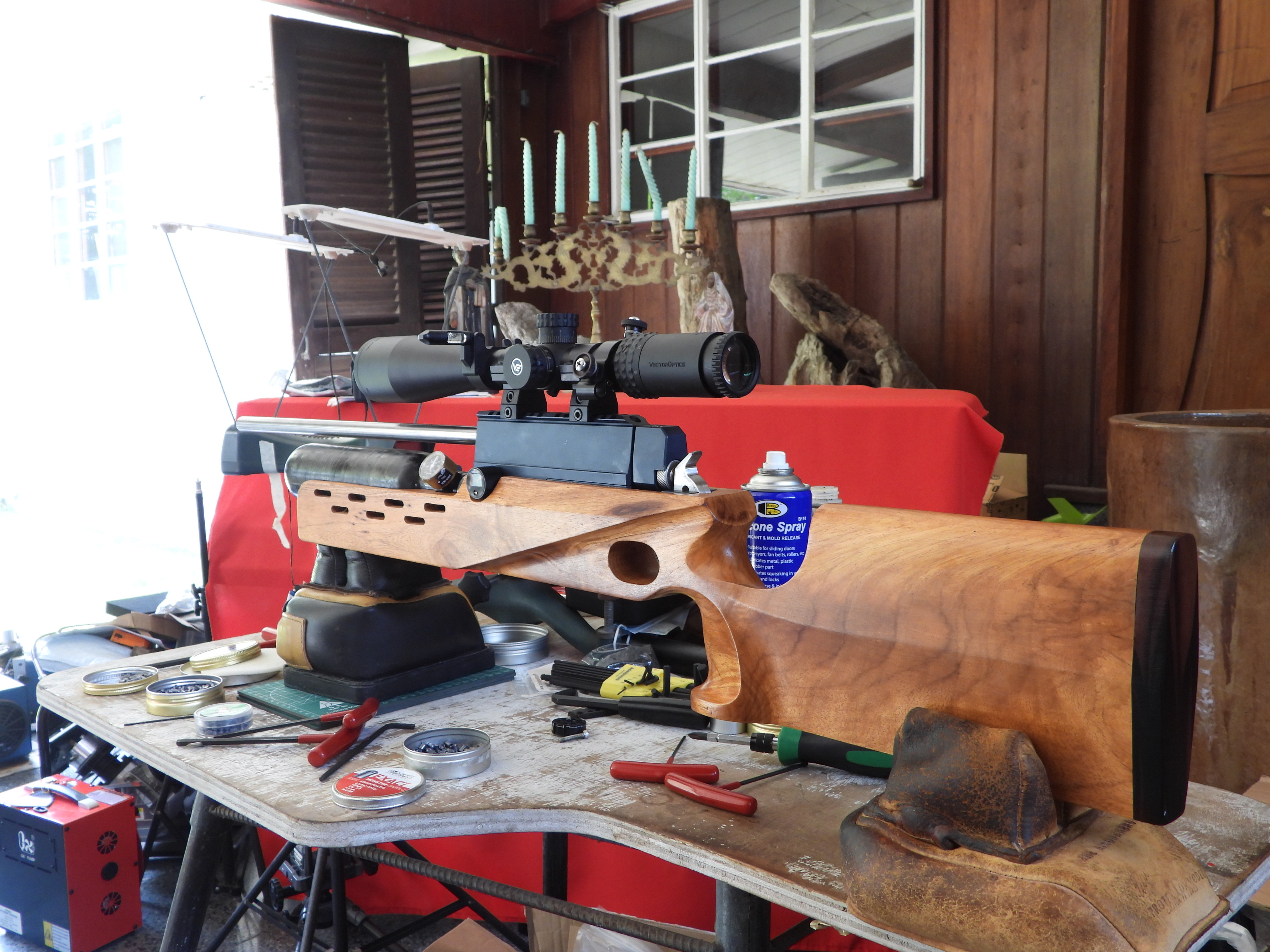

Where did you get the rifle, it looks like a USFT MAC 1 and a RAW had a baby??:)
Nice shooting
Tim McMurray incorporated the swing type and hammer design that has been existing in my country since the 90's. You can ask Todd Banks because he is more familiar and also goes here to compete.
Hi Ricky,
Do you have a short video of how you actually cock, load and shoot the rifle?
It looks like you cock it via your thumb - on what looks like a hammer from a revolver pistol.
Do you feel there any advantages to this design - accuracy-wise?
I haven’t seen anything like it before on a PCP in the USA.

Hi Ricky,
Hi Ed, here’s the video you requested.
The design is so simple and its only disadvantage compared to side levers/bolt action is loading speed.
-Ricky

Ricky,
That is an awesome design. Perfect for me as I have 15 PCPs with dozens of magazines… which I almost never use as I single shot load with my thumb into the barrel.
I’d imagine that the cocking is reasonable with a .177 hammer spring, but could get uncomfortable with a stiff hammer spring for larger calibers.
Thanks for making the video and showing us something new (to us).
-Ed

Exactly like my Mac 1 , just a square shape .

You’re very welcome Ed.
The hammer spring is good for .177 - .25 since the hammer is quite heavy (mass) and I had to reduce its weight by drilling a hole. I have a new one incoming from a different PCP maker (GCMAG) and this one has external hammer spring as well as transfer port adjustments.
It will look similar to the picture but mine will come with a 700cc bottle and a different BR stock…
