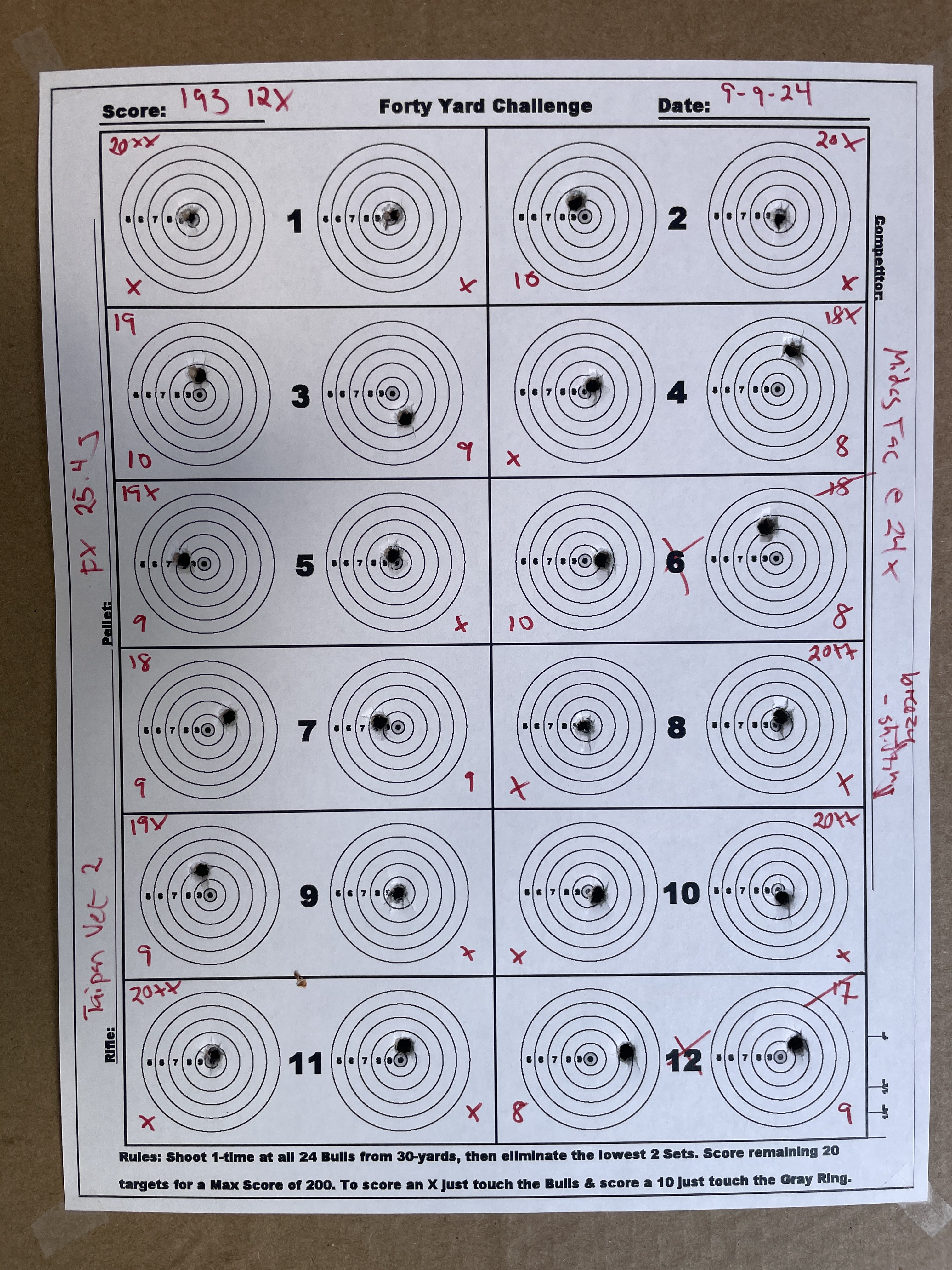

Here is a card I shot yesterday with Crown. Its not really a 193 - as you can see I reshot 8a and 8b after completing the card.
On pair 8, the wind shifted BEFORE my flags indicated - or the breeze was up closer to me (40 yards and I had 4 flags up) and I didn’t notice the close flag as I was focused downrange.
At first I thought “bad pellet) but as you can see, two consecutive shots landed in exactly the same shifted spot.
Its the wind conditions that shift vertical PoI that are really tough for me to read. Many a great card has been lowered by these types of breezes.
However, I shot consecutive 195+ cards a while back in winds approaching 14mph! Because that day, it was consistent R to L and a pretty steady wind speed. I was amazed and thought I was becoming a “great wind shooter”, lol. I was quickly humbled the next time I faced a switching breeze.
I need to start to using sighters and learn when to use them.

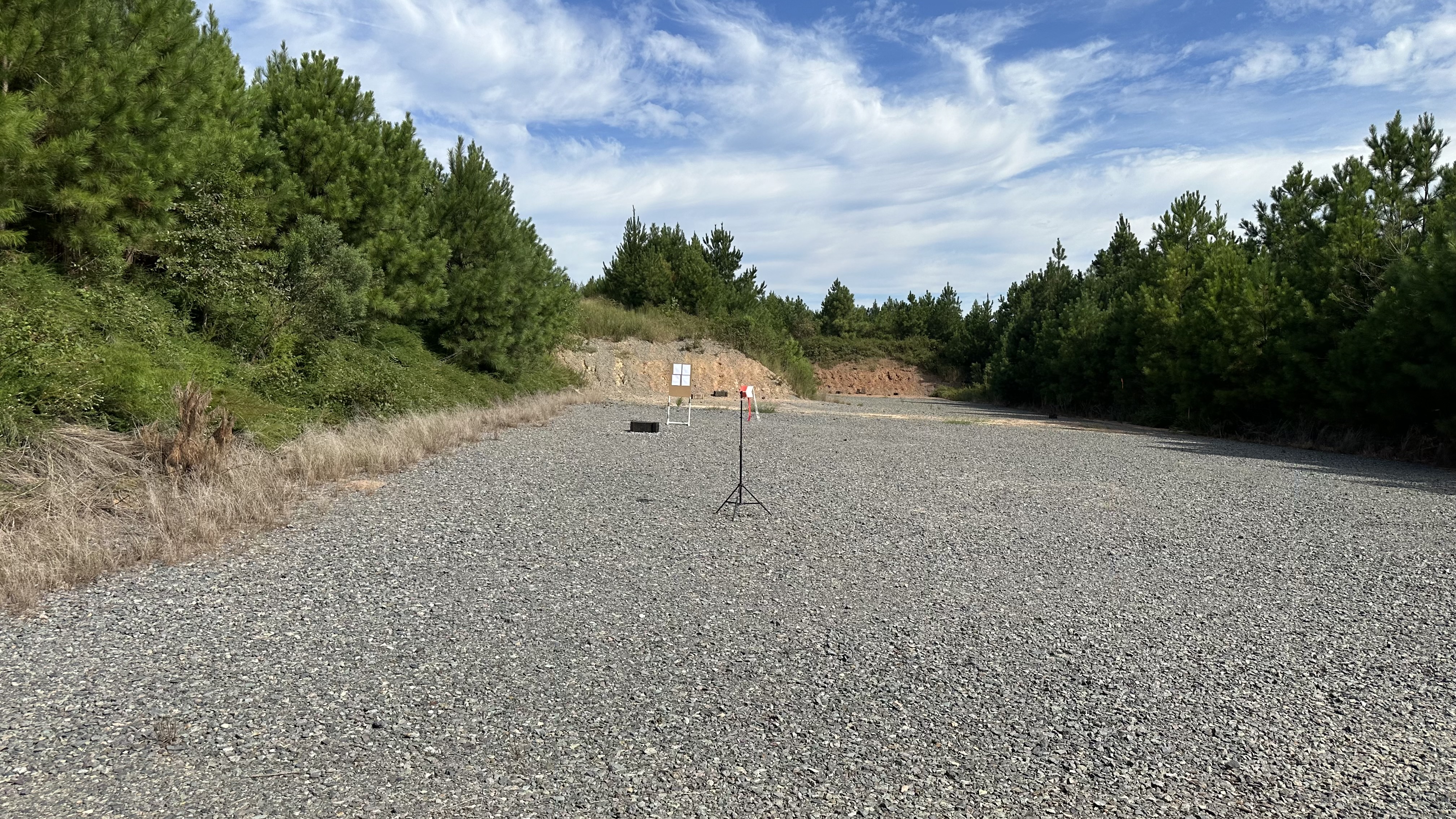

As you can tell from pics, I always shoot the Challenge Targets at my local outdoor range. It is pretty wide open, but there are two 20’ BERMs on each side of the 50-60 yard width of the field. I also shoot under a roof, which A well known /respected competition BR shooter has mentioned to me, can also have some tricky characteristics.
The 2nd part of your question is tricky. The average wind speed on a typical day can vary from light ( Zero to two mph); to three-seven mph. Most of the time, I like to have a light tail wind at 180 degrees heading down range. I also like a slight head wind. The cross winds are harder to judge for me, although I have had some good success holding on 8-9 am and 3-4 pm crosswinds holding on the 7 or 8 ring.
Candidly, if the wind blows more than 3 -4 mph, I normally just shoot groups or maybe practice wind reading at 30Y max. These light pellets get affected by even the slightest winds, so it’s almost a waste of time for me to tryfor mid to upper 190’s scores with high wind conditions.

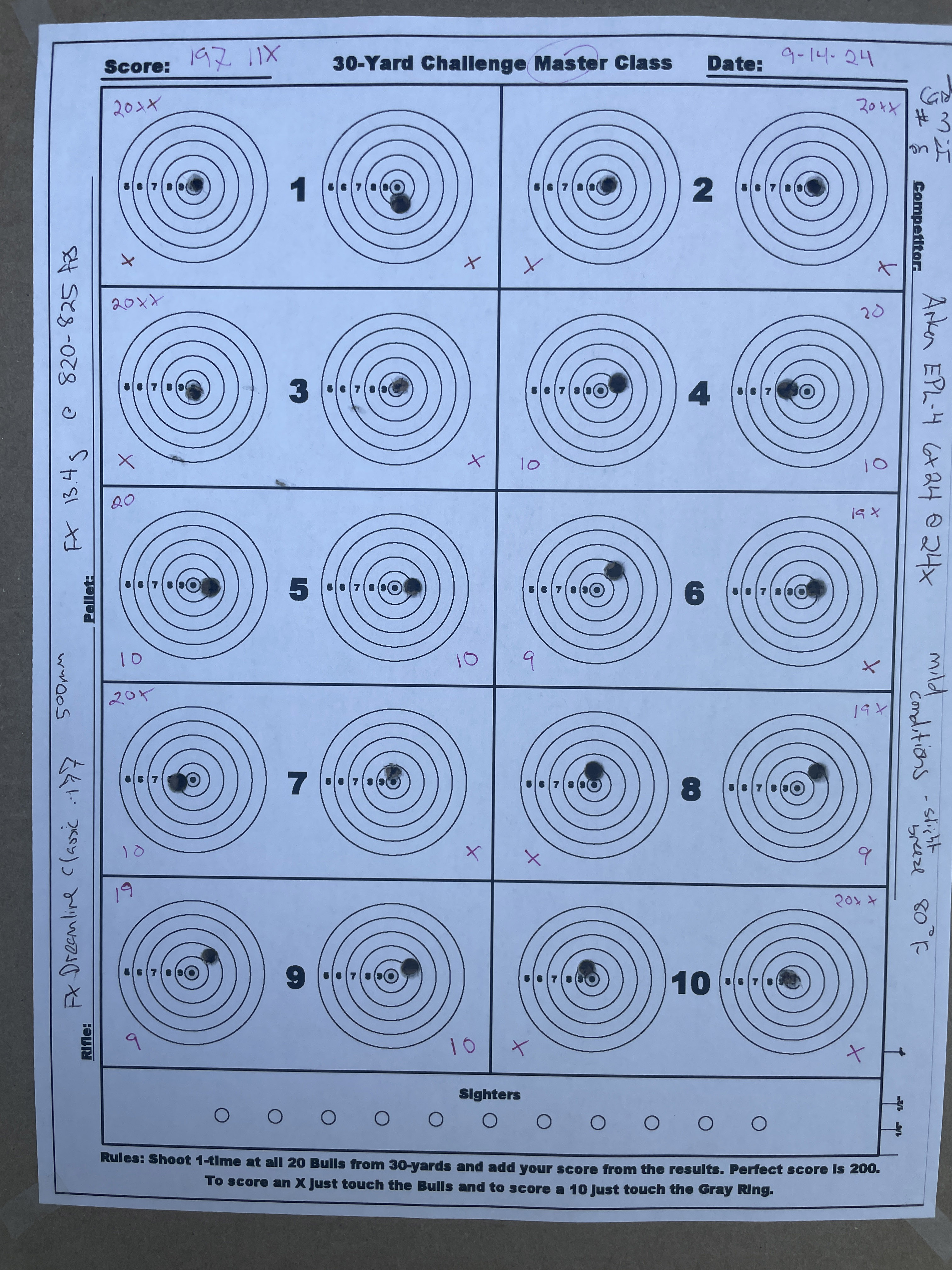

Wind was mild today. I tried to break 190 with Wolverine R HP .22 at 40-Masters… I shot 188. I think shooting the 18.13s at 1,025fps works well at 30 yards, but they may destabilize a bit by 40 yards. Groups are always 1/2” edge to edge at 40 yards, so maybe its just me with the Wolverine.
Then I shot some .177 with Dreamline Classic. Used the 13.4g at 820-825fps (instead of the usual 10.3g with Dreamline).

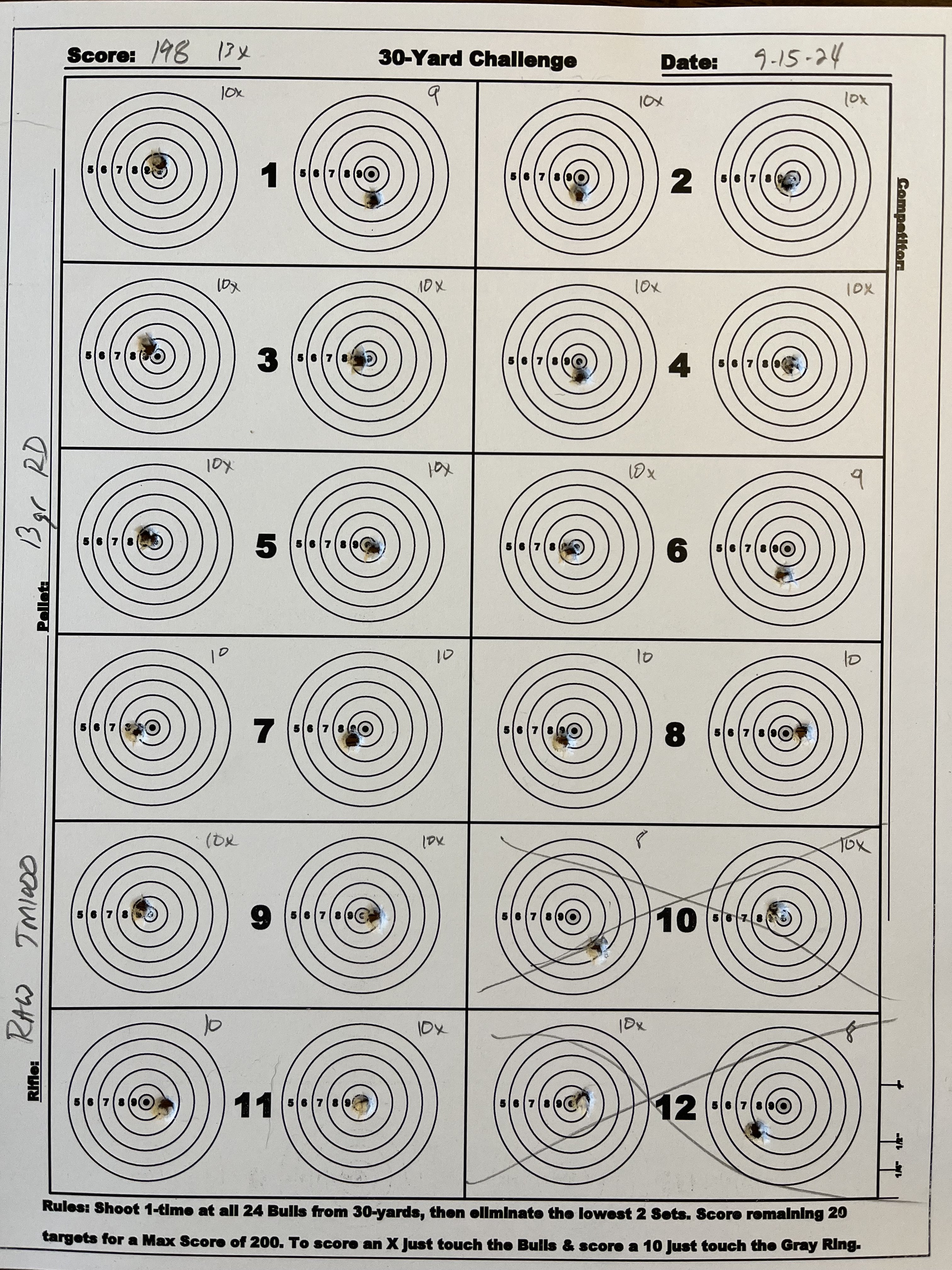

Shot three 30-Masters. First card was 195, then a 198 - last card was 197. Wow, that’s about as good as I’ve ever shot .177.
Figured out a new hold for Dreamline that seems to work well. No leaderboard submissions but I’m happy!
Great target beerthief. Great looking gun too. I think that is a 198 18X the way we score these. Unfortunately your 4 9s are in four cells and you only get to throw out 2. But a 198 is better than I've done this year except for one gun which gave me a 200 (after many, many attempts and I had only 15Xs on that target).

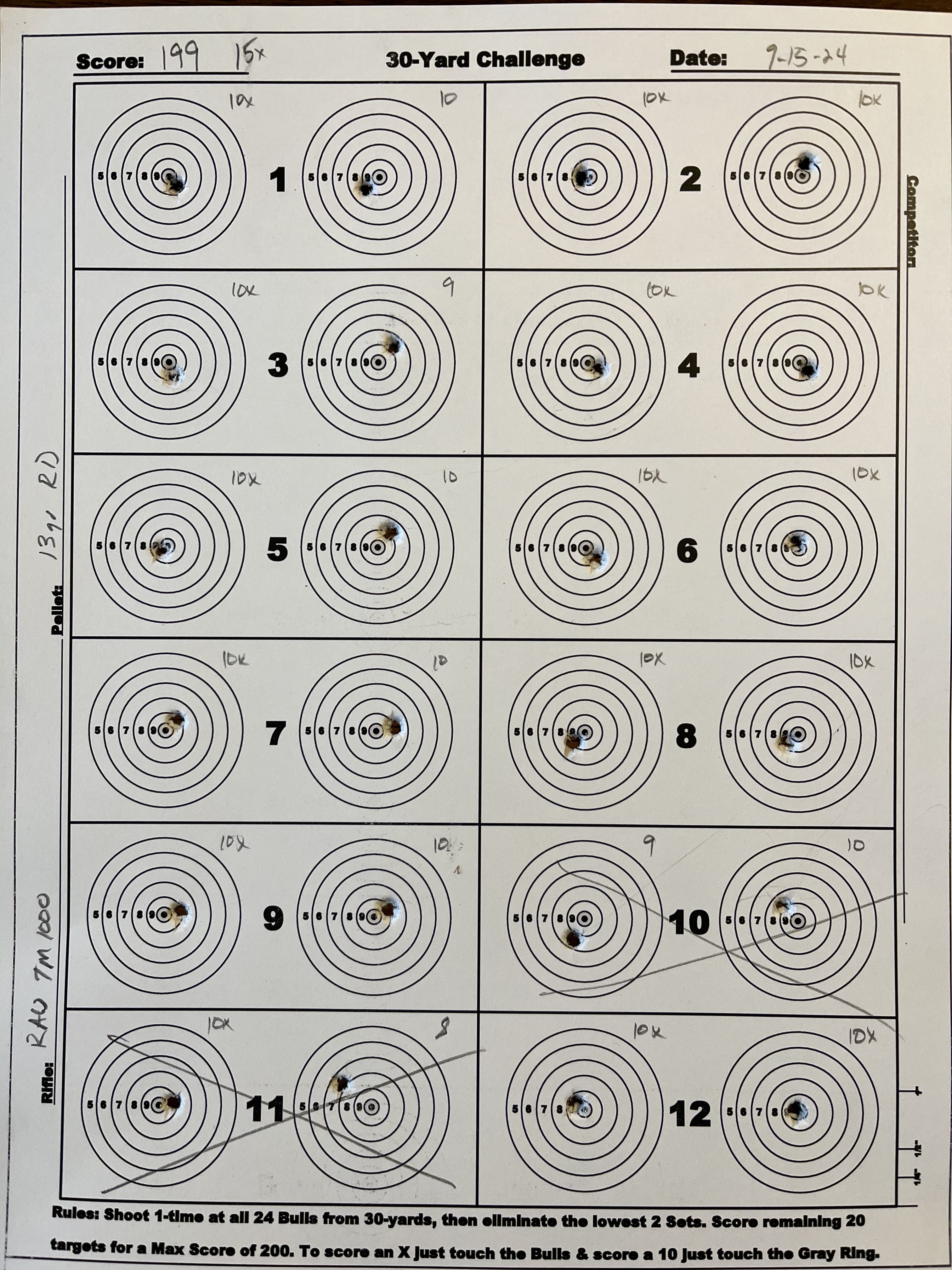

Not sure how this thread really works, but I thought I would give the 30yd target a try for the first time.

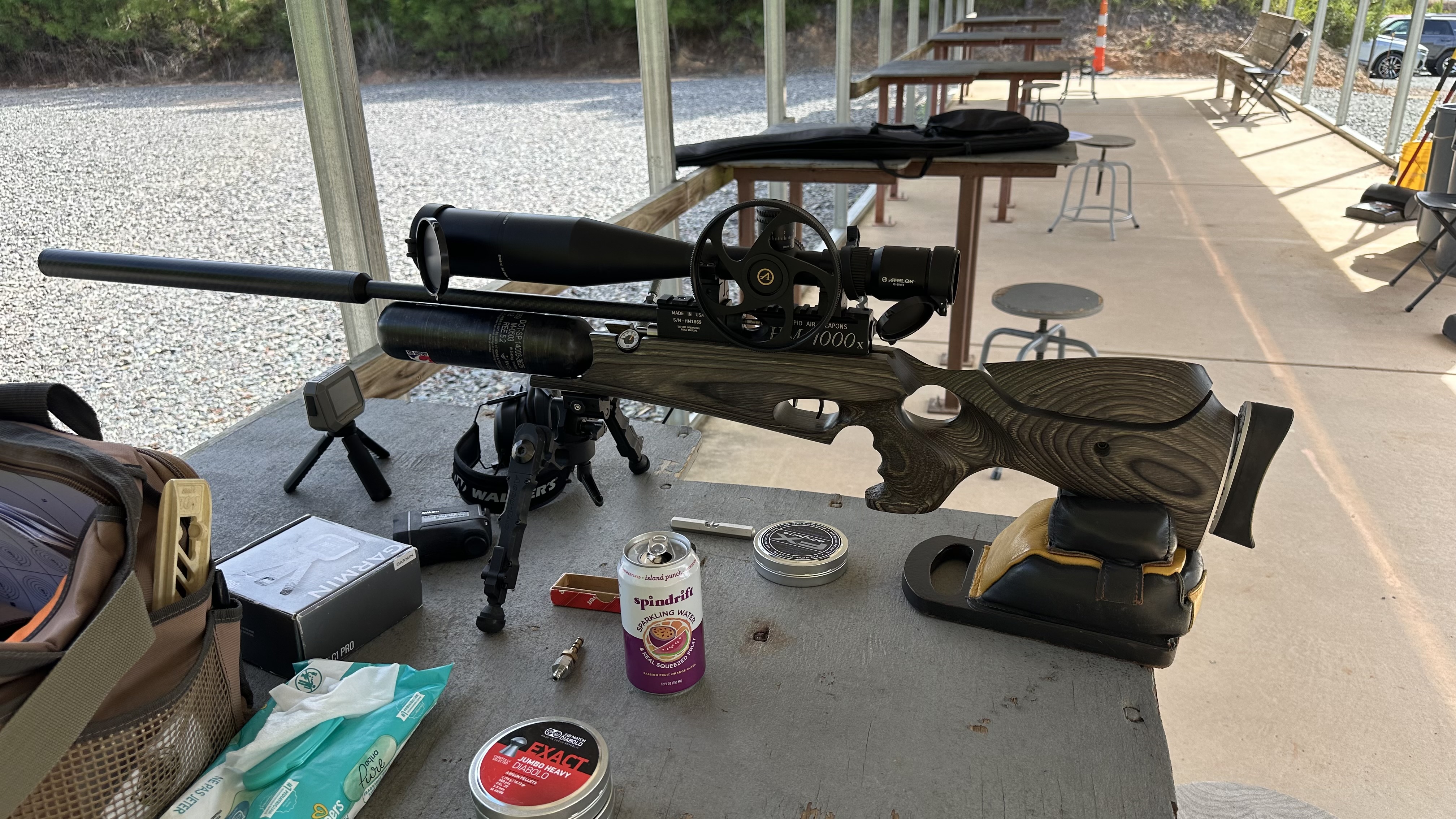

I finally have a 177 to shoot again. Just got my RAW TM1000 back from Motorhead and having him tune it up for me. I only shot some 10s, 13s, 13RDs a couple days ago to see what it likes now and decided to give the 13RDs a real try for the first time today.
Shot 3 cards. Trying to judge these 177s with 22 is really hard when it starts getting close to being an X. Wasn’t sure how you guys did that, and I didn’t want to shove the pellet all the way through.
199, 198, 196.

Awesome scores and shooting - that 199 will be on our next Leaderboard Update - coming soon.
What speed were you shooting the 13.4s? What scope and magnification were you using?
-Ed
