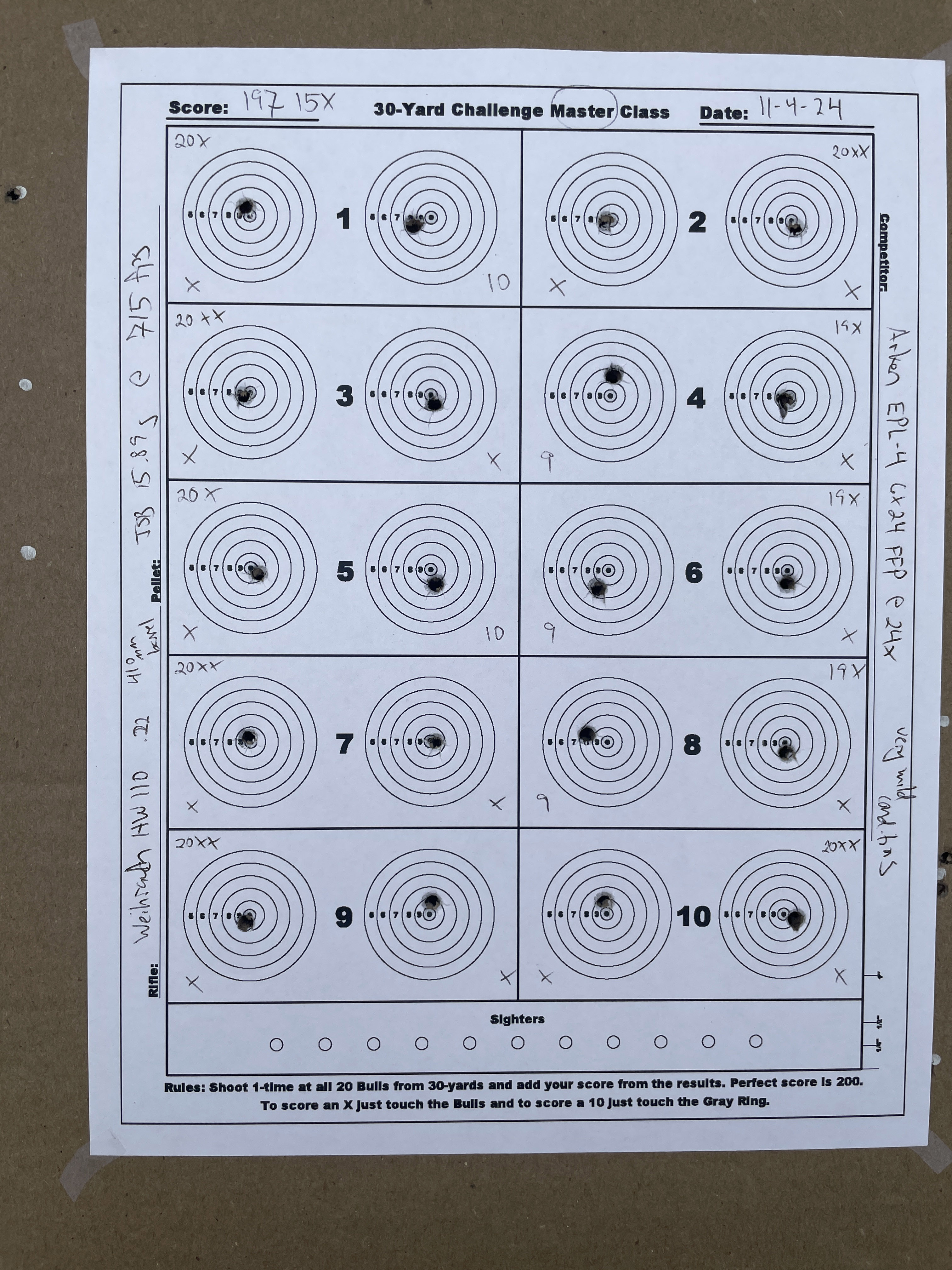

Leaderboard submission - Weihrauch HW110.
It doesn’t beat my 198 30-Masters score with the HW110, but it beats my 30-Challenge score of 196. So, I’ll submit it for the 30-Challenge:
30-Challenge: 197 15X (!)
Rifle: Weihrauch HW110 .22
Pellet: JSB 15.89g @ 712fps
Scope: Arken EPL-4 6x24 FFP @ 24x
Wind conditions were mild. I then did some plinking at 40 yards with the HW110. It did really well. It took what seemed a long time for the little 15.89g to hit the target at 40 yards when traveling only 710fps. The rifle is so quiet with this mild tune - fun to shoot.

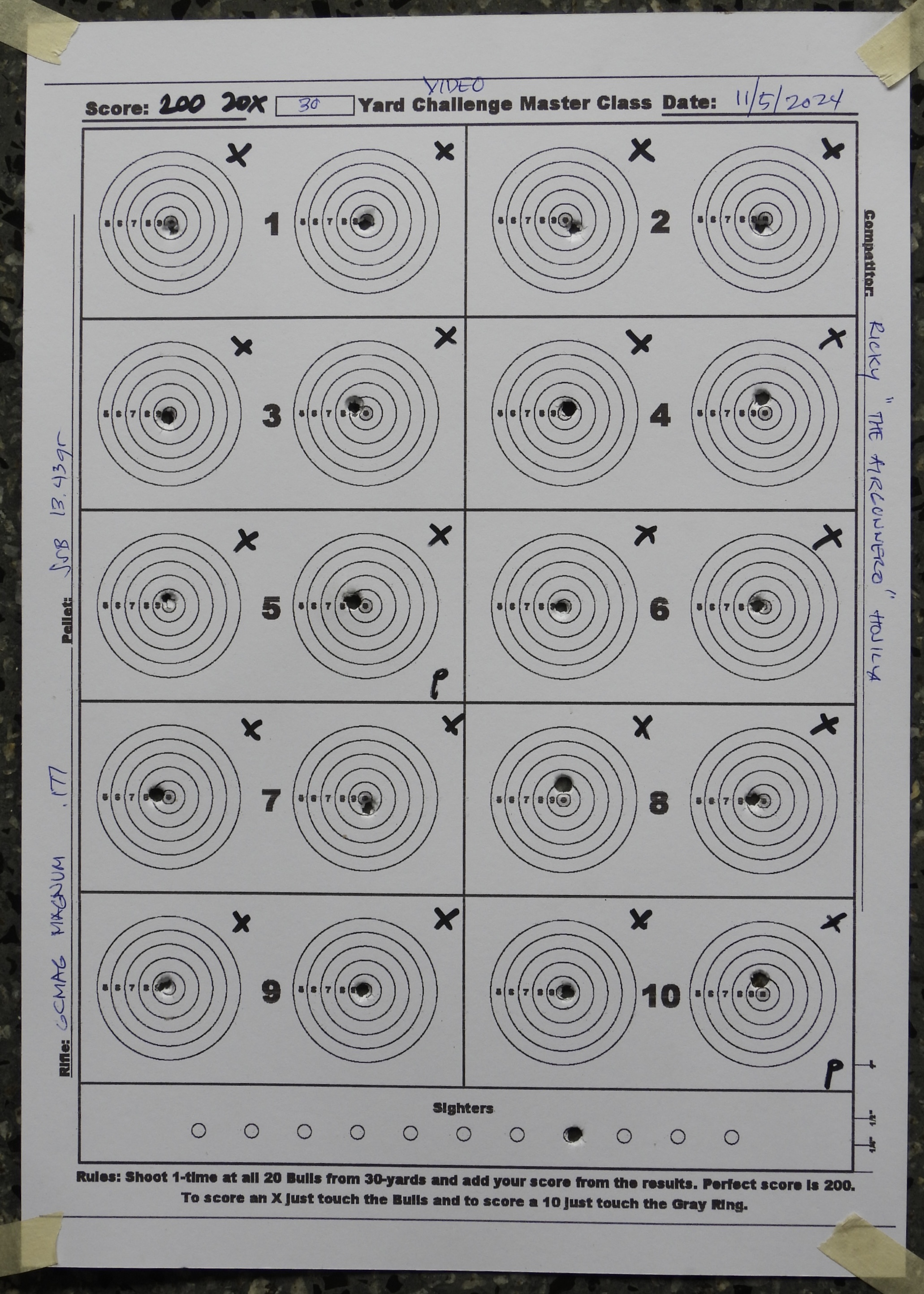

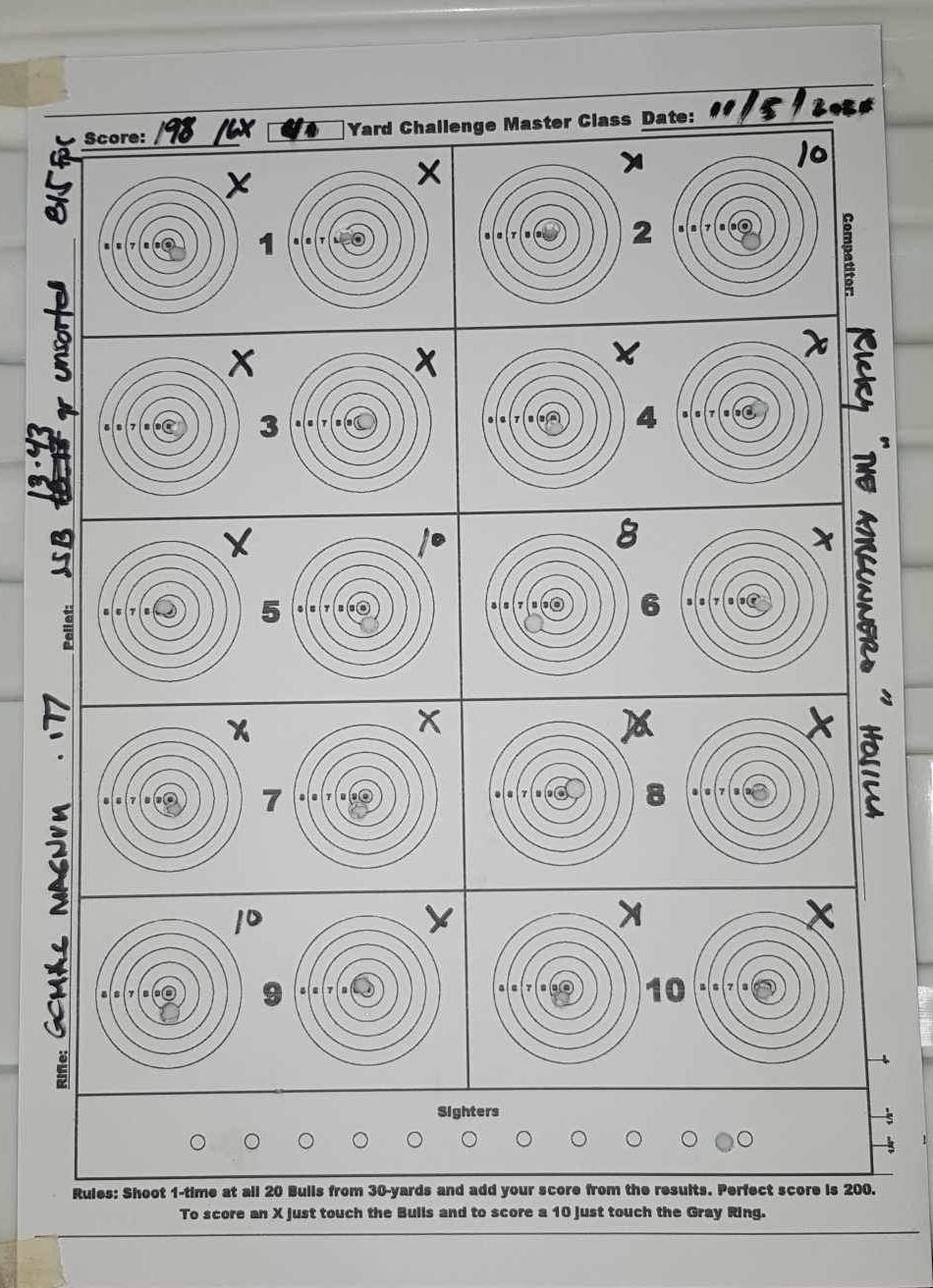

Here’s my leaderboard submission for November:
🇵🇭 GCMAG Magnum Gen 2 .177 cal setup using JSB 13.43gr unsorted pellets @815 fps, Vector Optics Sentinel X @30X magnification, Protektor Model Deluxe BB rear bag as front rest and Protektor rabbit ear rear bag.
Score: 200 20X

That 110 is shooting great at 18 FPE. That’s almost 100 FPS less than my HW100 .22 that you set up for me. Looks like slower is better for these German Weihrauch air rifles, at least for 30Y Challenge accuracy. As many have observed and commented on, faster doesn’t always translate to better accuracy.

Here’s my 2nd leaderboard submission for November:
Score: 198 16X
Incredible shooting Ricky!
Did you do any customization of your GCMAG? Is it regulated? If yes, Factory reg or Huma?
Perhaps sometime you can post a video of your hold and trigger pull?
Also, what happened with the 8 on the 198 40-Masters card… it must have been a bad pellet…?
-Ed

My HW110 came with a 600mm barrel. I swapped in the 410mm and a UK spec hammer spring shuttle. Dropped the reg pressure from 150 to 90bar.
Now its the ultimate backyard rifle - quieter than my .177s ! Super accurate too.

Hi and thanks Ed.
My GCMAG has a stock regulator which has a different design from all other regs but functions the same.
My hold is very simple… I just place my rifles on top of the front and rear bag, pinch the rear bag so that the butt will not move and then I slowly pull the trigger. I don’t shoulder my rifles since the recoil is very minimal.
The 8 was caused by a pellet with a bent skirt since the pellets I used are my “rejects”.
-Ricky

Thanks Ricky…
But you are a successful competition shooter, so I’m hoping that you will let us “dig deeper” into your shooting technique…
On many of my rifles, I’m putting pressure on the trigger from the 2 o’clock position with my index finger - with counter pressure from my thumb from the 8o’clock position. This offsetting pressures keeps the crosshairs from moving - both horizontally and vertically.
How do you feel regarding trigger pressure - what is your technique - hoping that you will share some insights.
I agree that with PCP “recoilless” rifles - definitely try to minimize touch/pressure points on the rifle… I only touch the triger when shooting - nothing else.
-Ed

You’re very much welcome Ed.
My triggers are light. Only 2 ounces to 3 oz. depending on what rifle I use. I have severe CTS (Carpal Tunnel Syndrome) and I can’t feel my trigger finger. It is only my muscle memory that makes me shoot well but sometimes I do encounter the dreaded “misfires” during competitions causing my scores to go low. 🤣
Regular practice on a daily basis is essentia. If you fail to meet your goal (high score), rinse and repeat. Also try different holds until you discover what’s perfect for your particular rifle because not all rifles have the same hold.
All my practice videos are found here… https://m.facebook.com/groups/254960076057457/?ref=share
I also video record all my practice sessions which adds “pressure”, that’s why I never post pictures of scorecards without any video backup.
-Ricky

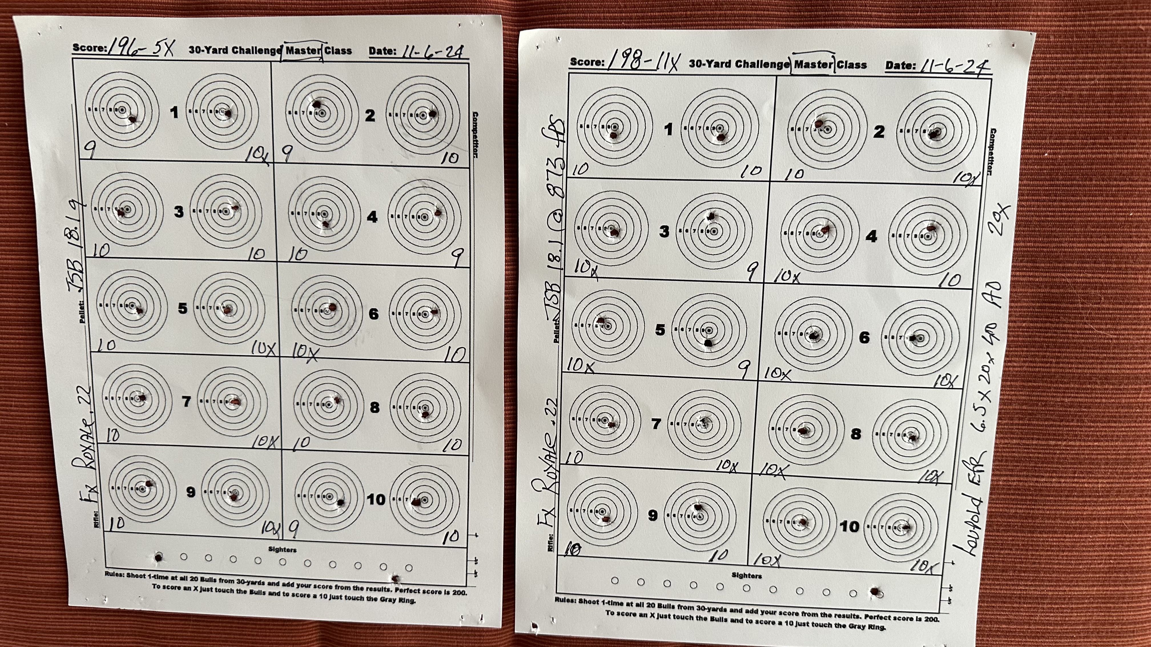

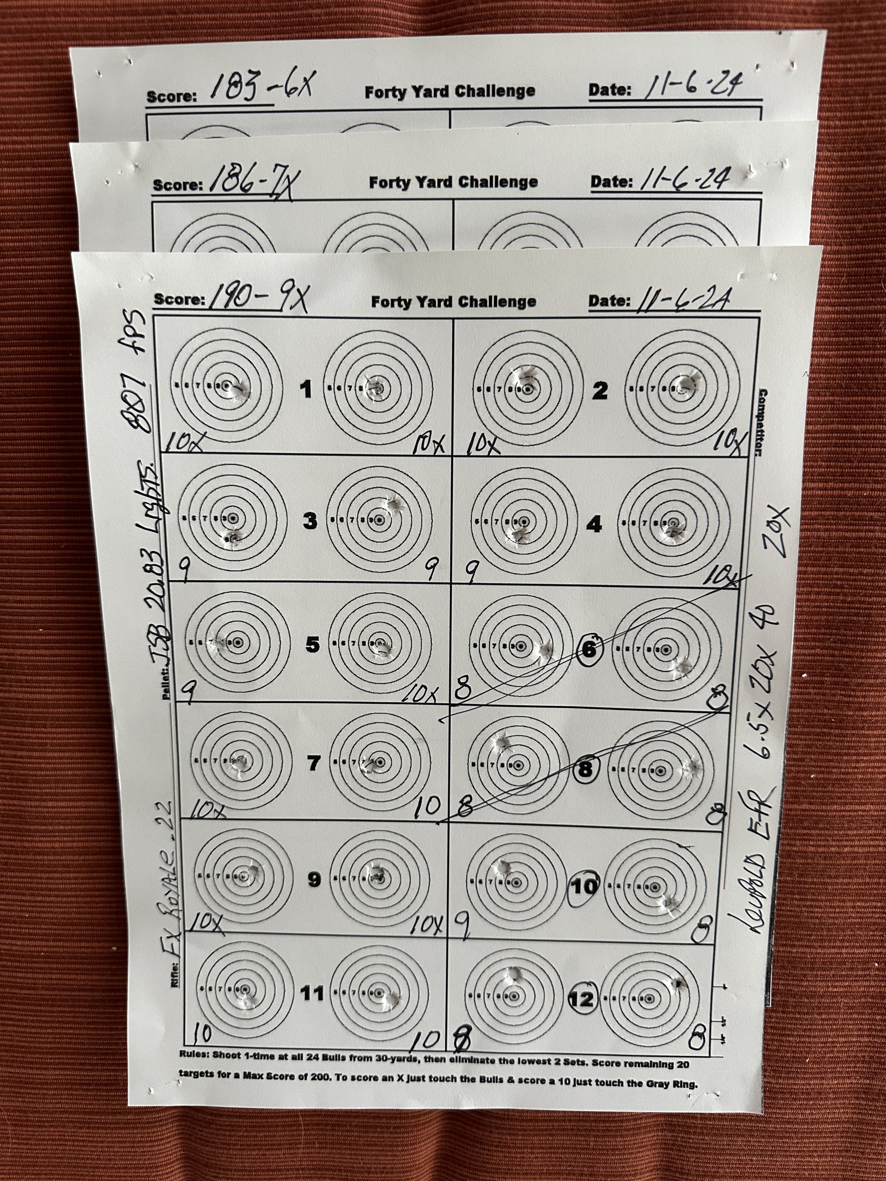

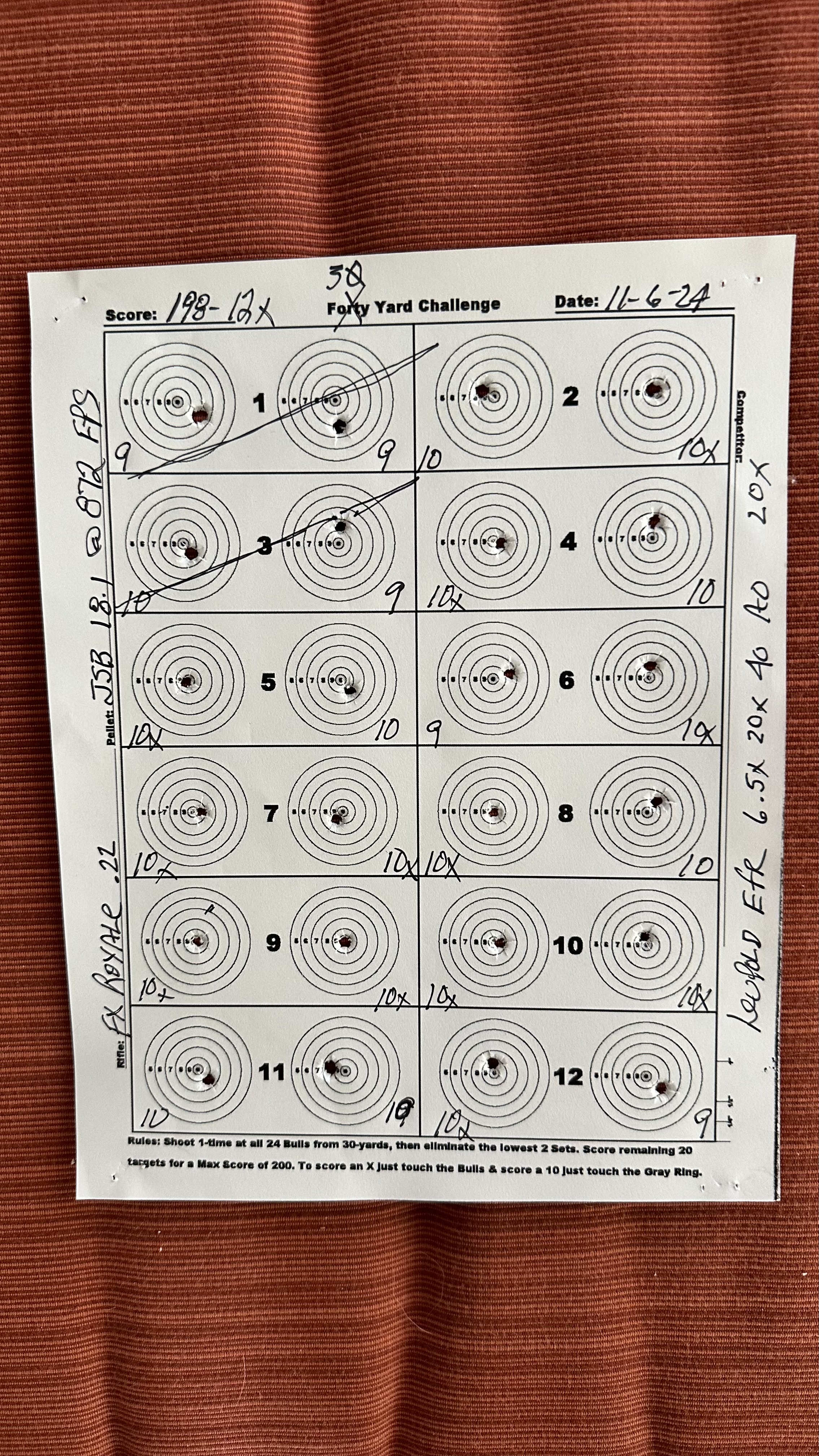

Shot some 30 and 40y cards today. Very light wind and range was not crowded.
I shot four 40Y Challenge cards and best I could do was a 191.
Shot three or four 30Y cards and will submit one Masters for leaderboard. I missed quite a few 10 rings with some misreads on slight wind.
Leaderboard submission for November
FX Royale 400 .22
Leupold EFR 6.5 X 20X 40 AO 2FP
30Y Masters
JSB 18.1 at 873 FPS
198-11X
Reactions: TheAirgunnero

Try shooting the 18’s at around 890 to 940fps
Reactions: tommyb
Thanks Ricky
I can try it, but I’m curious as to why you think 890-920 FPS increase in velocity, may be more accurate? Do you have any insight here? The Royale has a Smooth Twist barrel, and has a reputation for great accuracy. Would that be too fast?
As an example, I switched to the 20.83 JSB lights and with my same tune, the velocity is in the 815-830 range depending on outside temp. Very accurate at that velocity.
Thanks Ricky

Hi Ricky

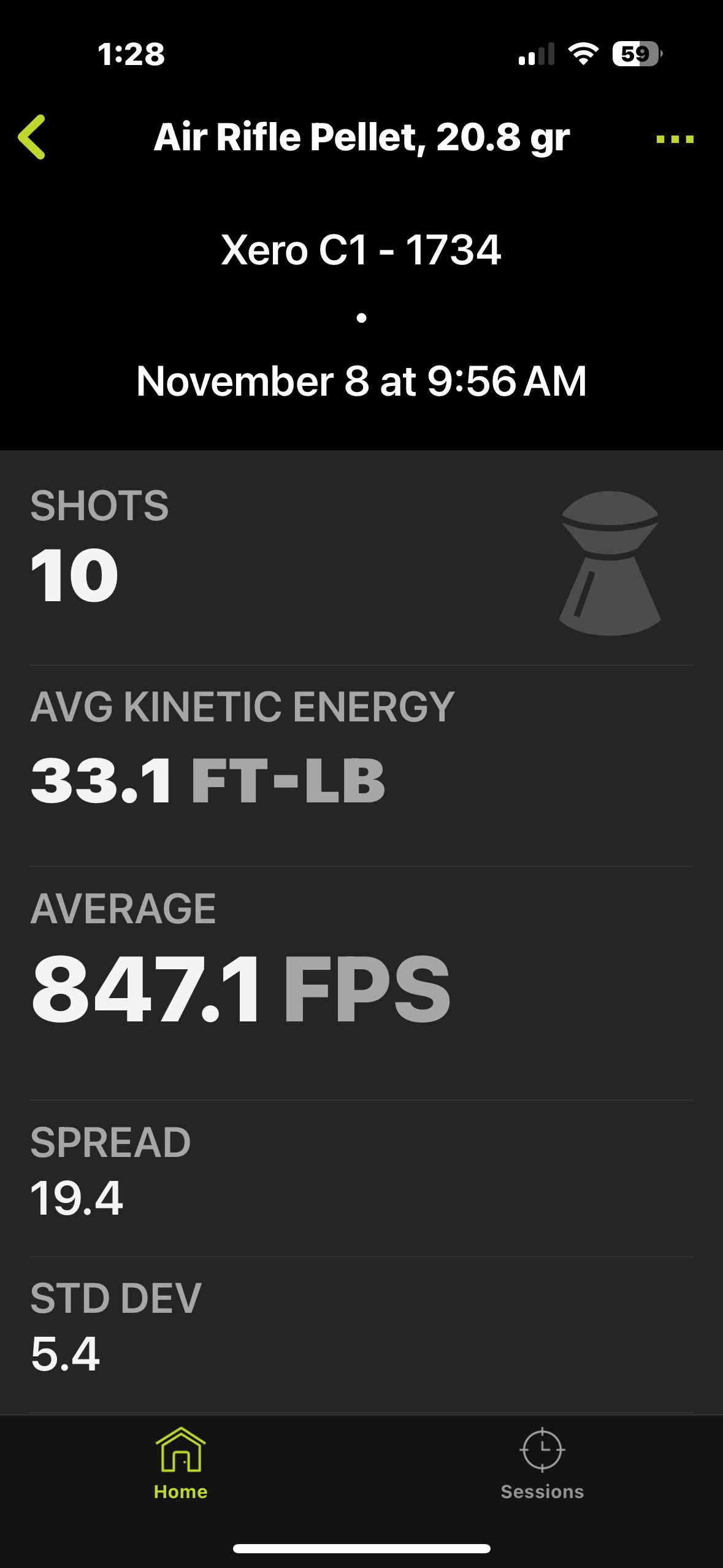

Ok, turned up HS today on Royale. I accidentally forgot my JSB 18.13 pellets, but I did bring the JSB 20.83g “lights.”
Shot a 196-14X 30 Y Challenge card at 848 FPS. Pretty sure the 18.1 g will get to 890-900 FPS at this tune. Edit - I inadvertently wrote the RAW on the card, but it actually was the FX Royale .22. Excuse the typo.

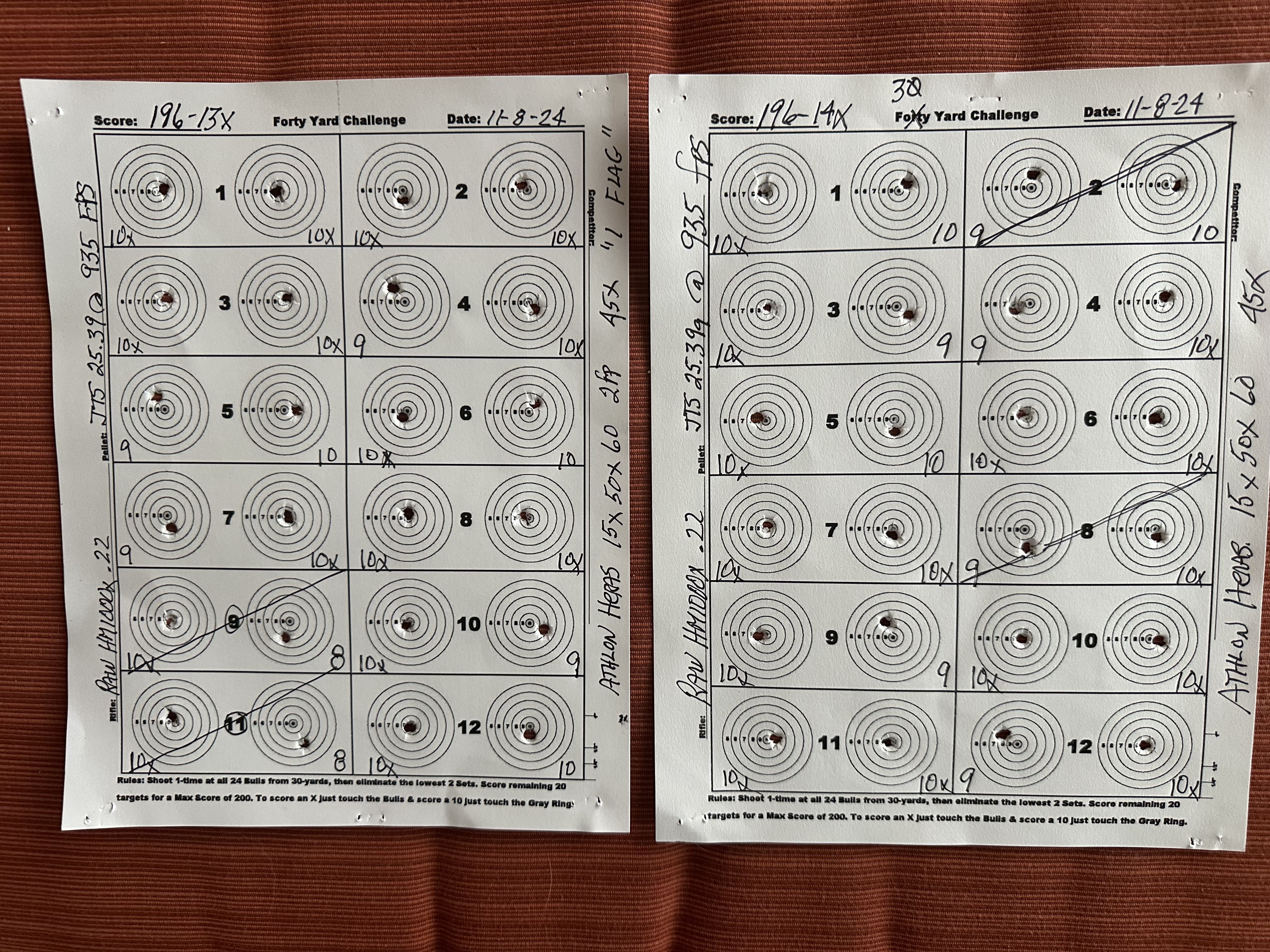

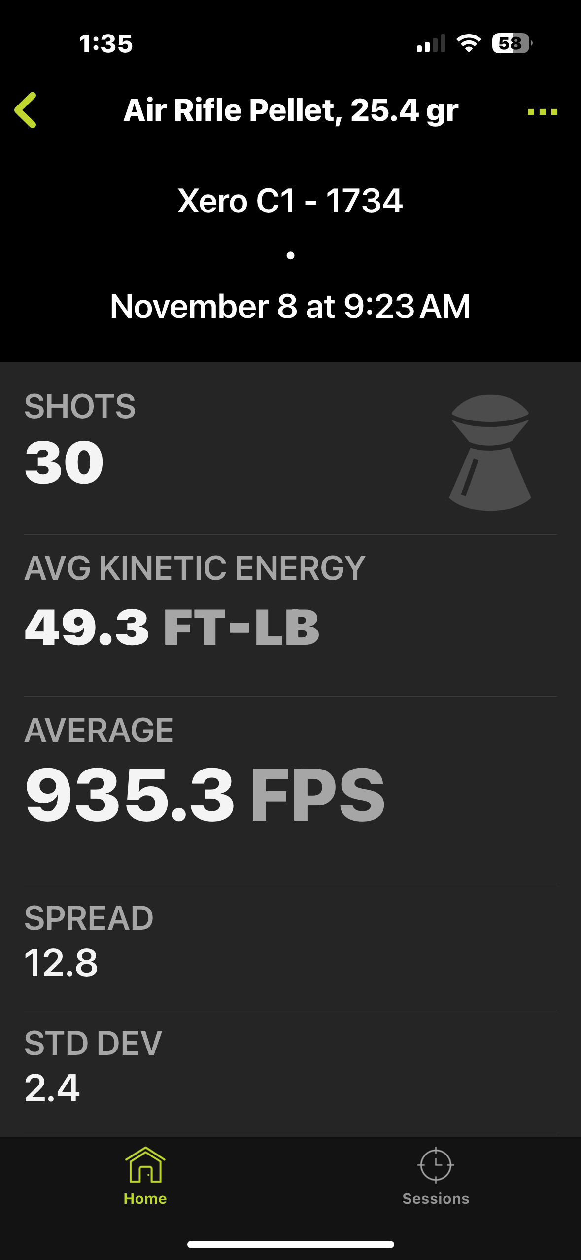

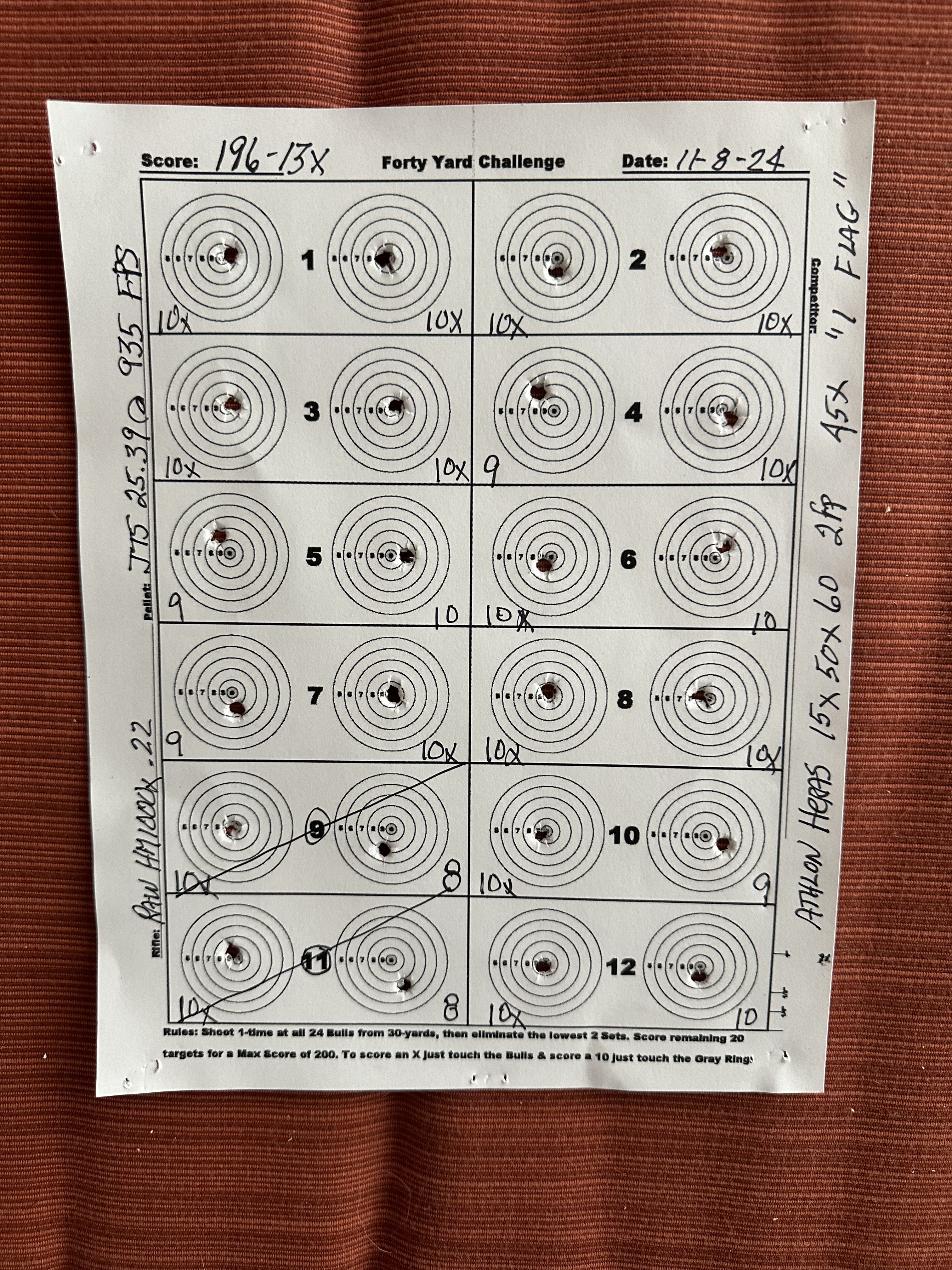

Shot a 40y Challenge card with the RAW HM1000x .22 today.
New Leaderboard update for this rifle. 196-13X with JTS 25.39g. I really want a 200 with this gun, and she deserves a better score. ‘She’ needs to tell the shooter/owner to slow down and read the wind. 😊
