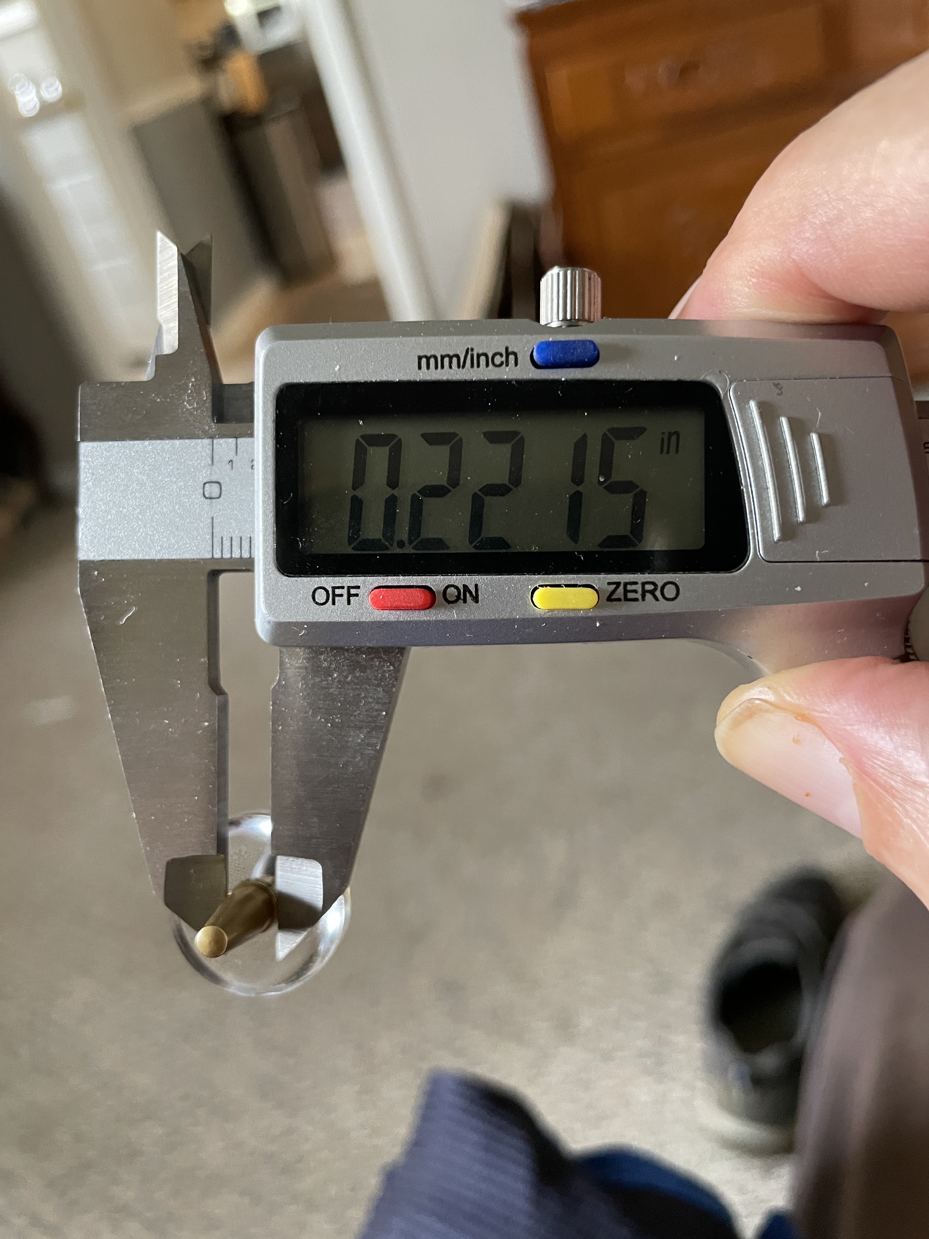

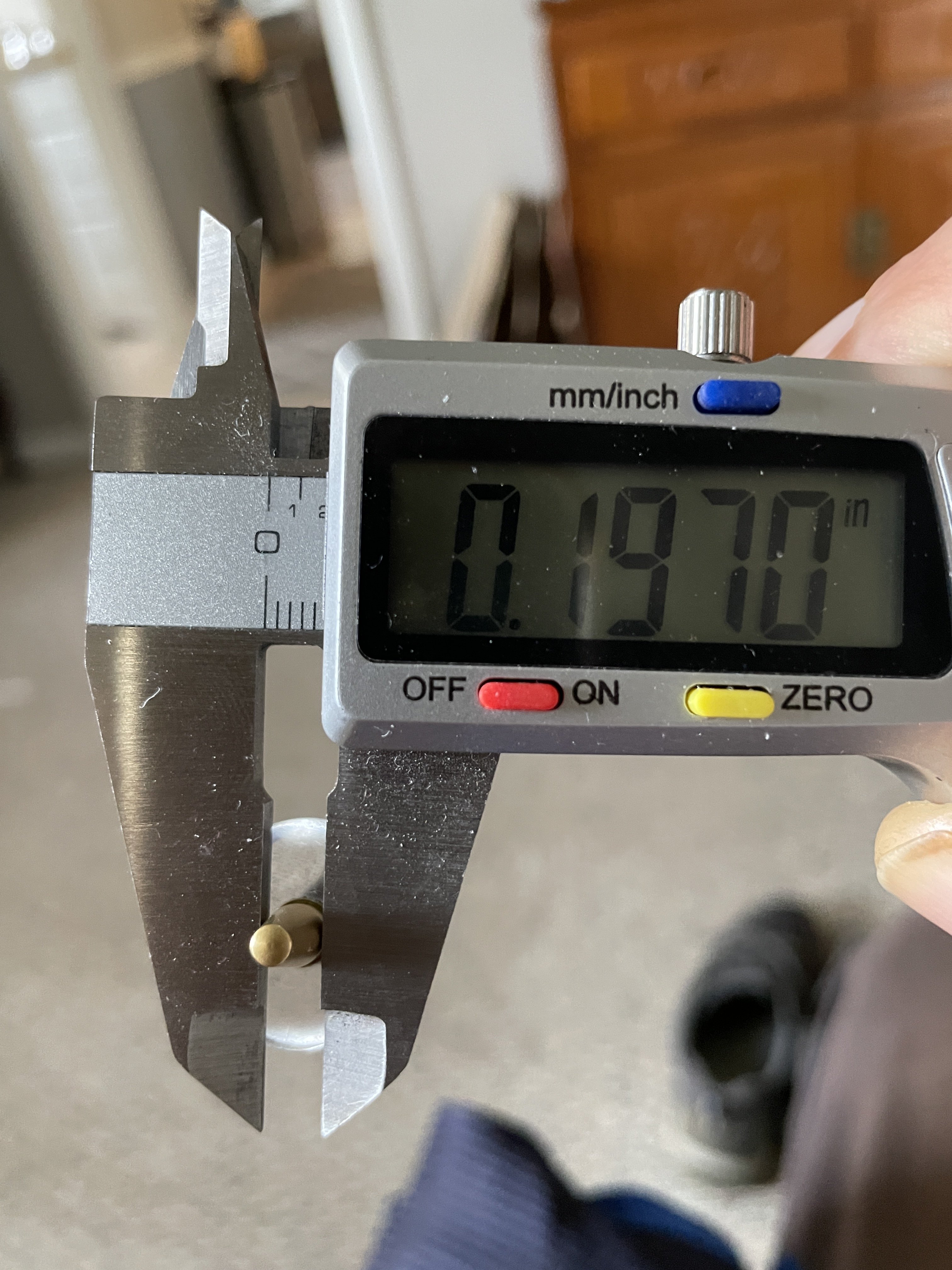

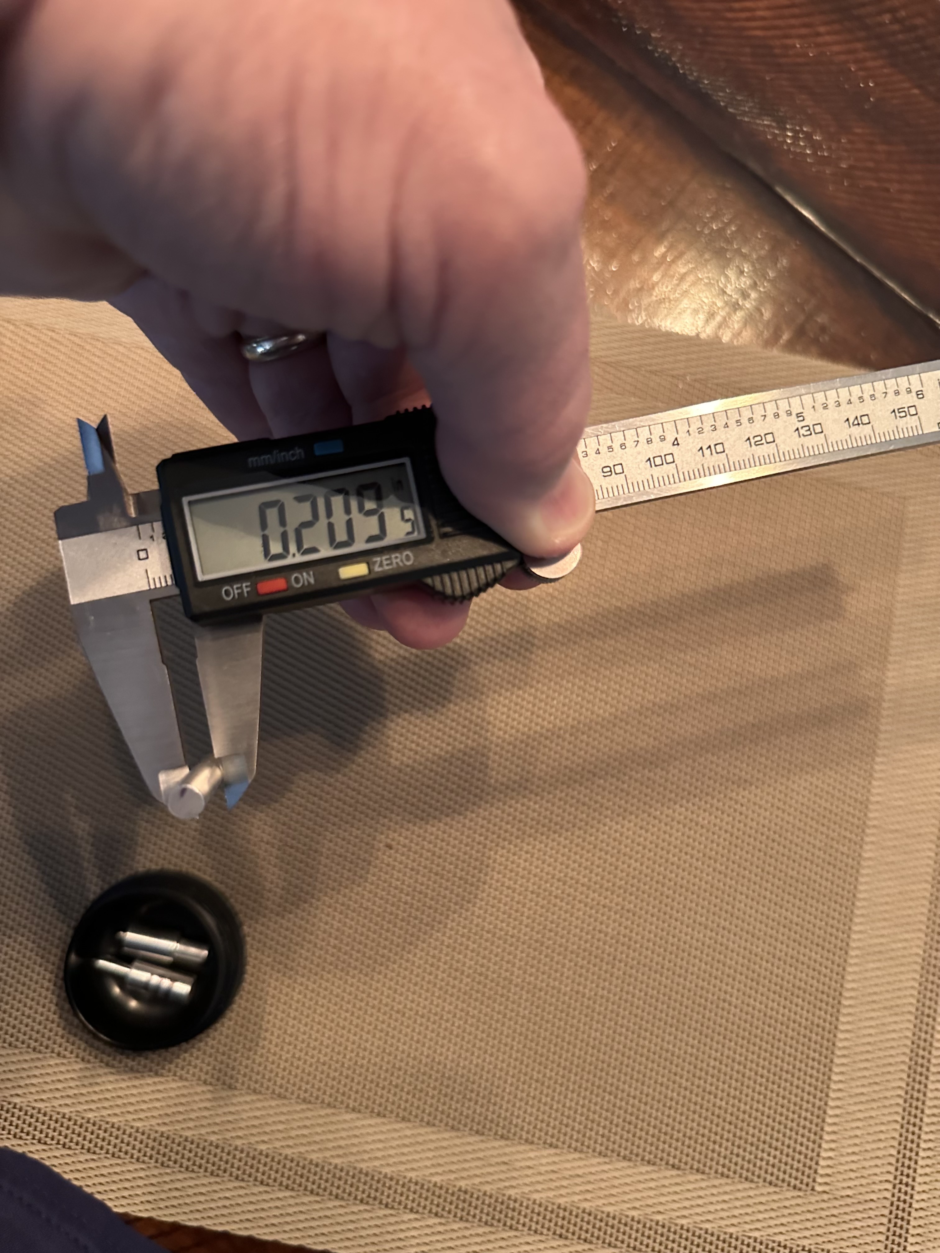

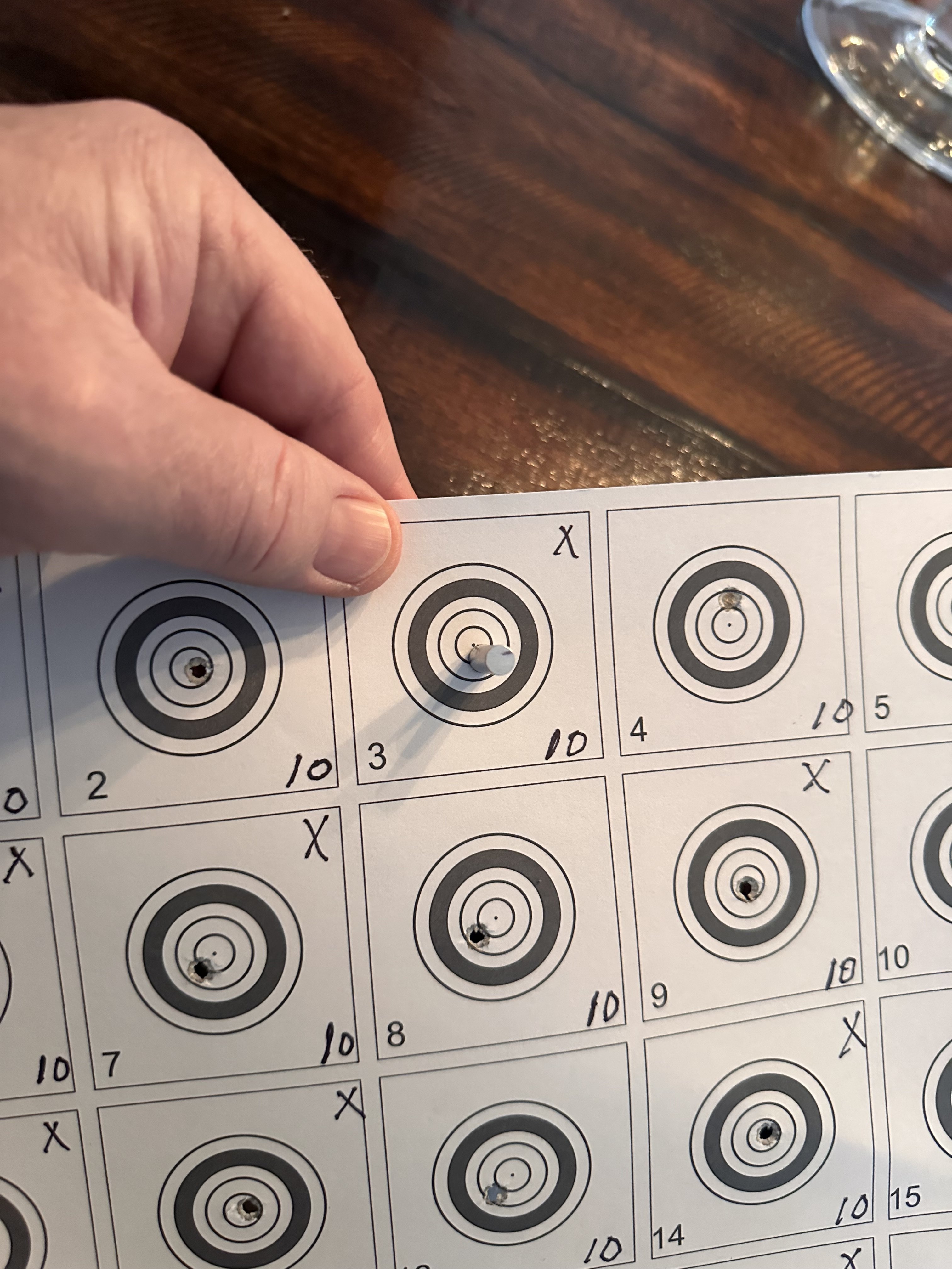

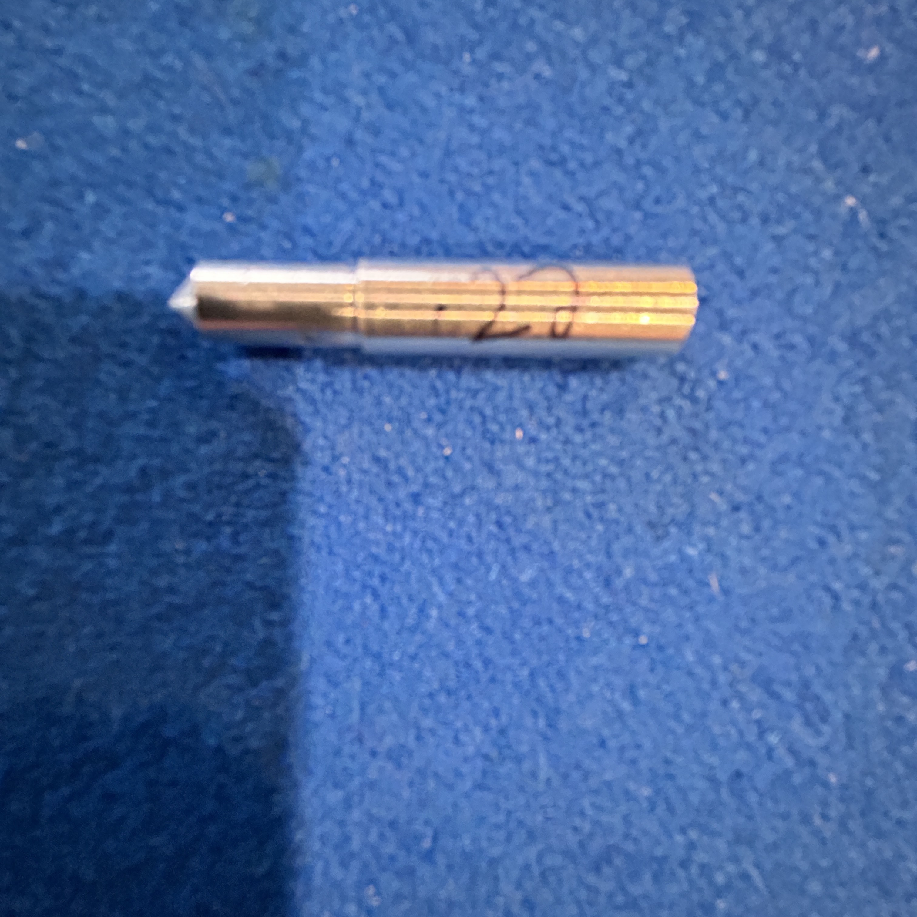

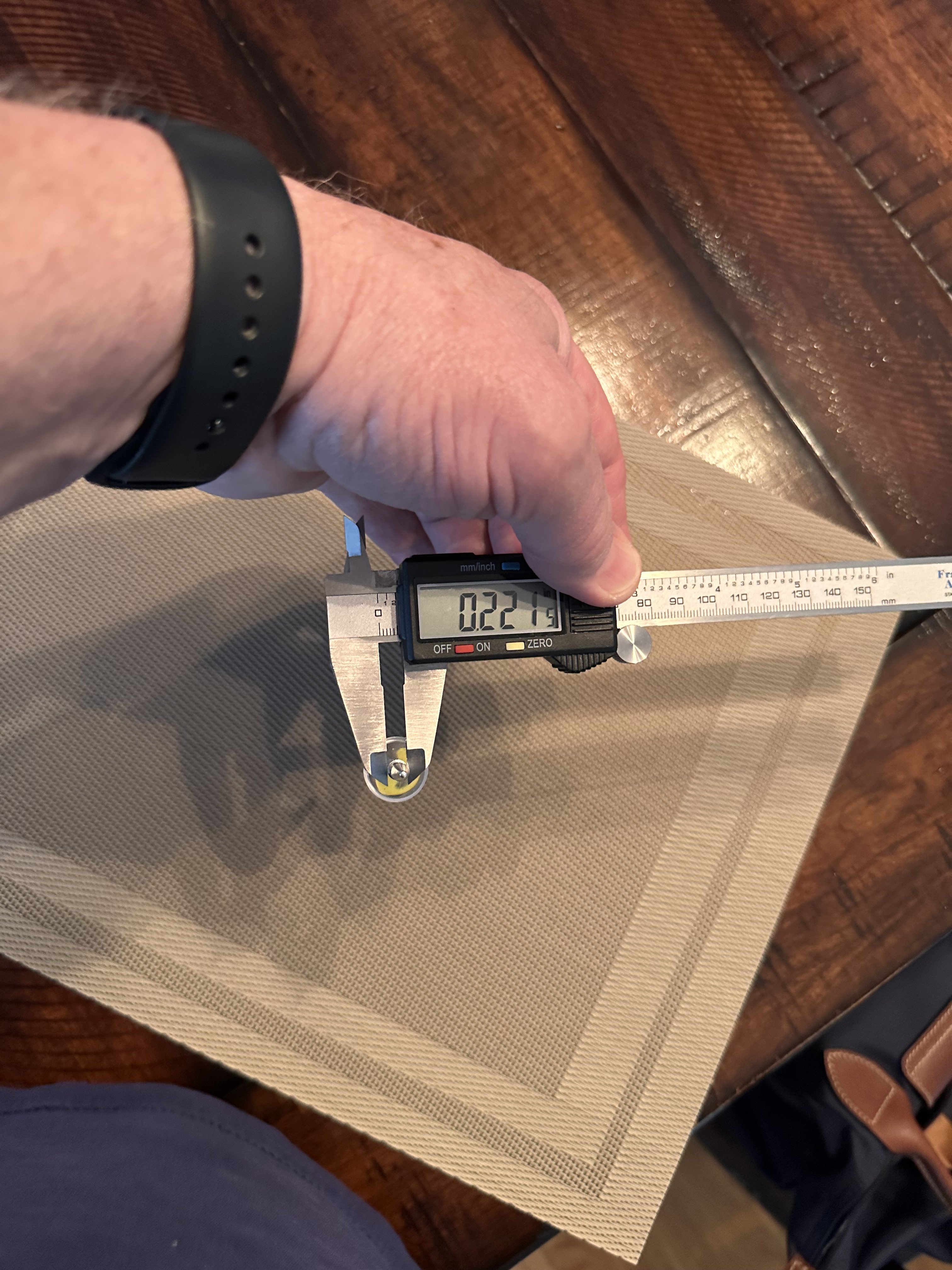

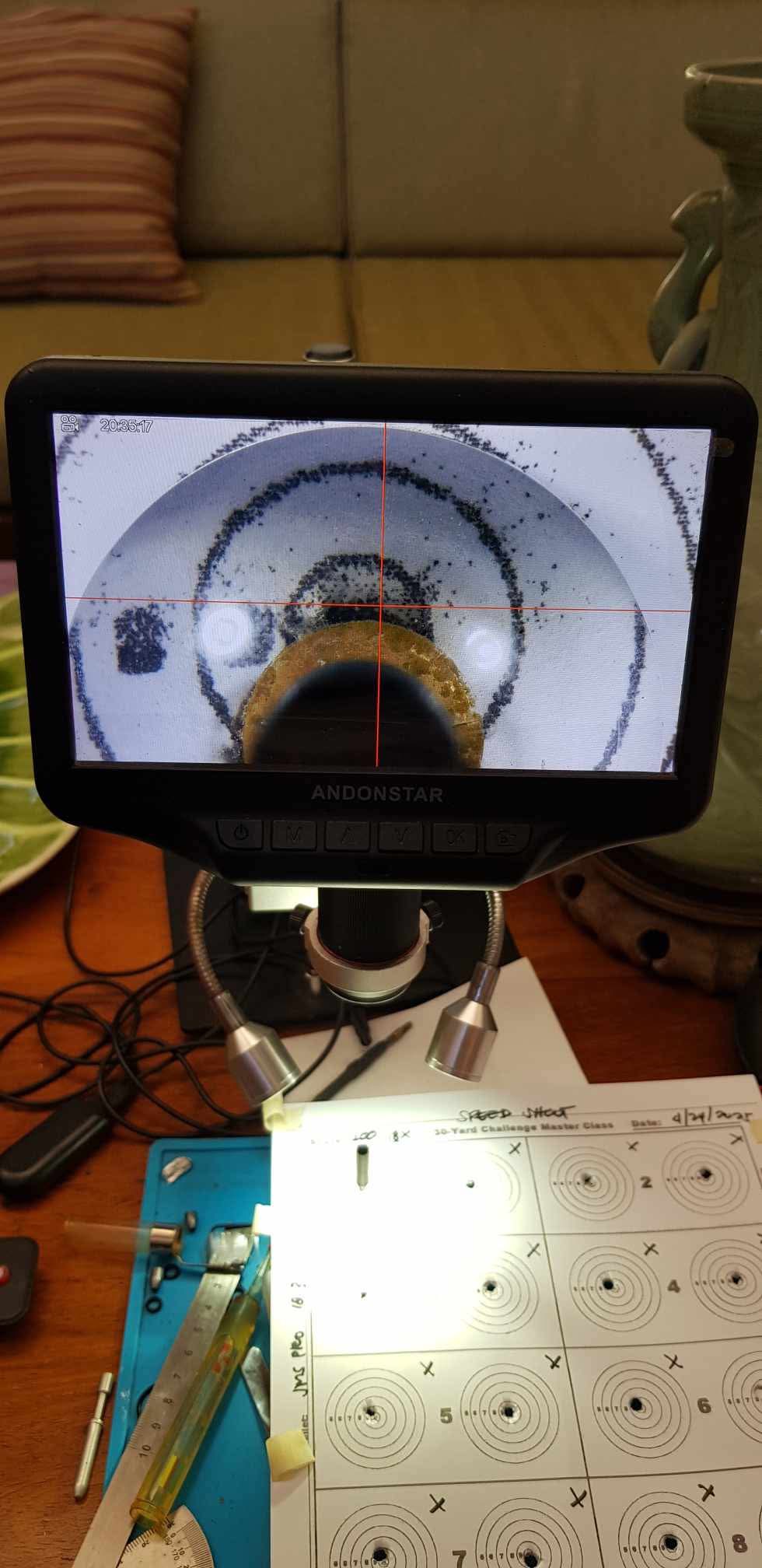

Ok, with the WRABF scoring Dia. I measured.2200? This is with out plastic magnifier because it gives me a more accurate reading. I also use the .177 plug for all my scoring. I will start using a .22 plug with the turned down scoring flange of .2160 Mike N. Plug I turned down to make sure I’m in compliance?
I need to start getting a better handle on what I’m doing because I’m shorting myself on close calls… I do have micrometers which I need to use instead of calipers for accuracy! I will remeasure.

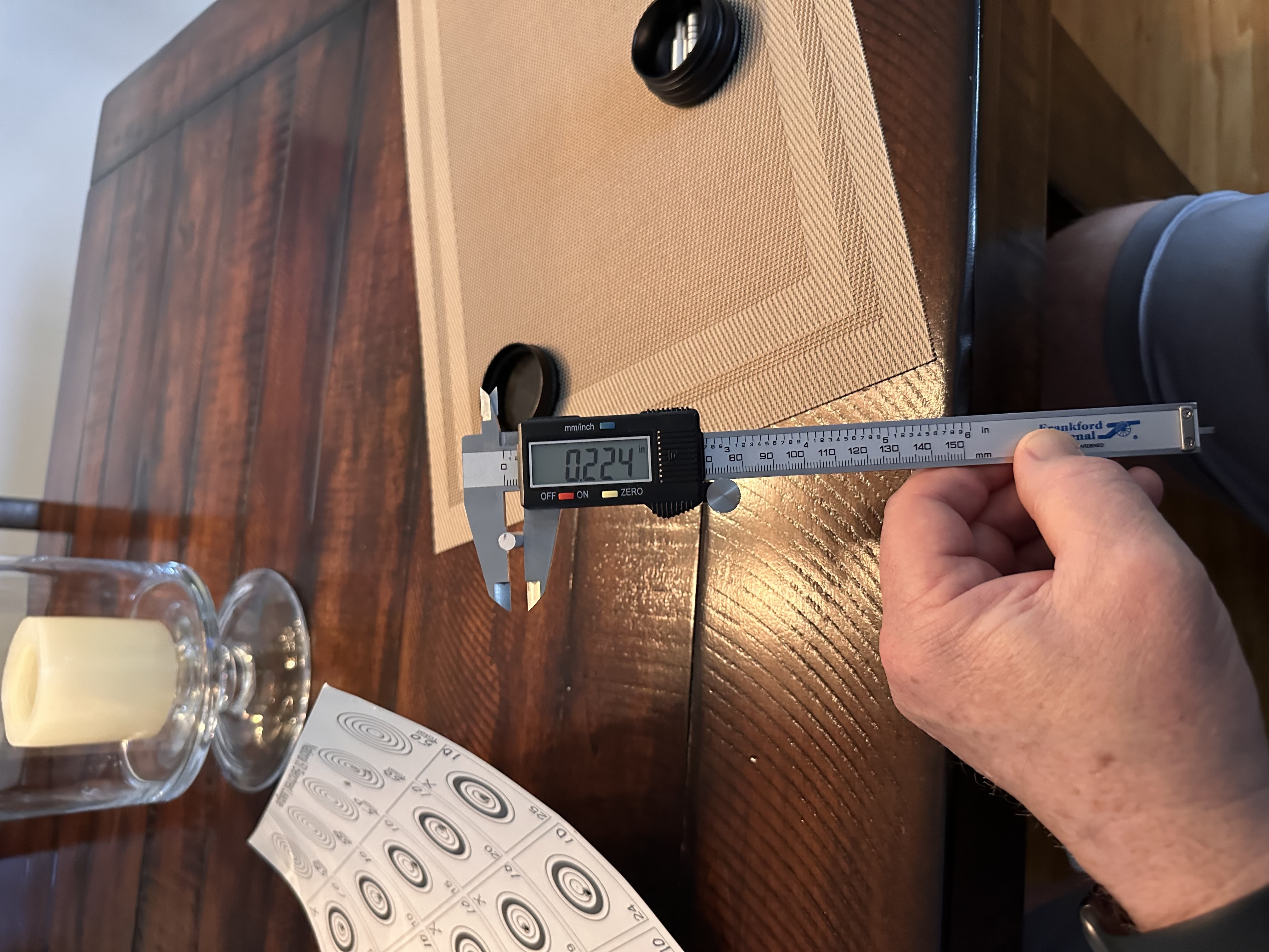

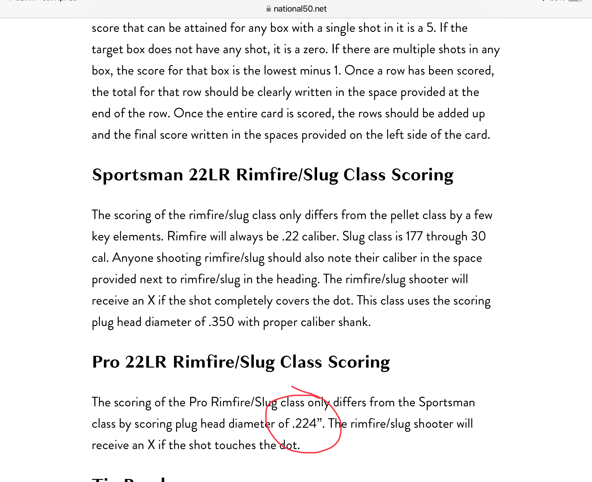

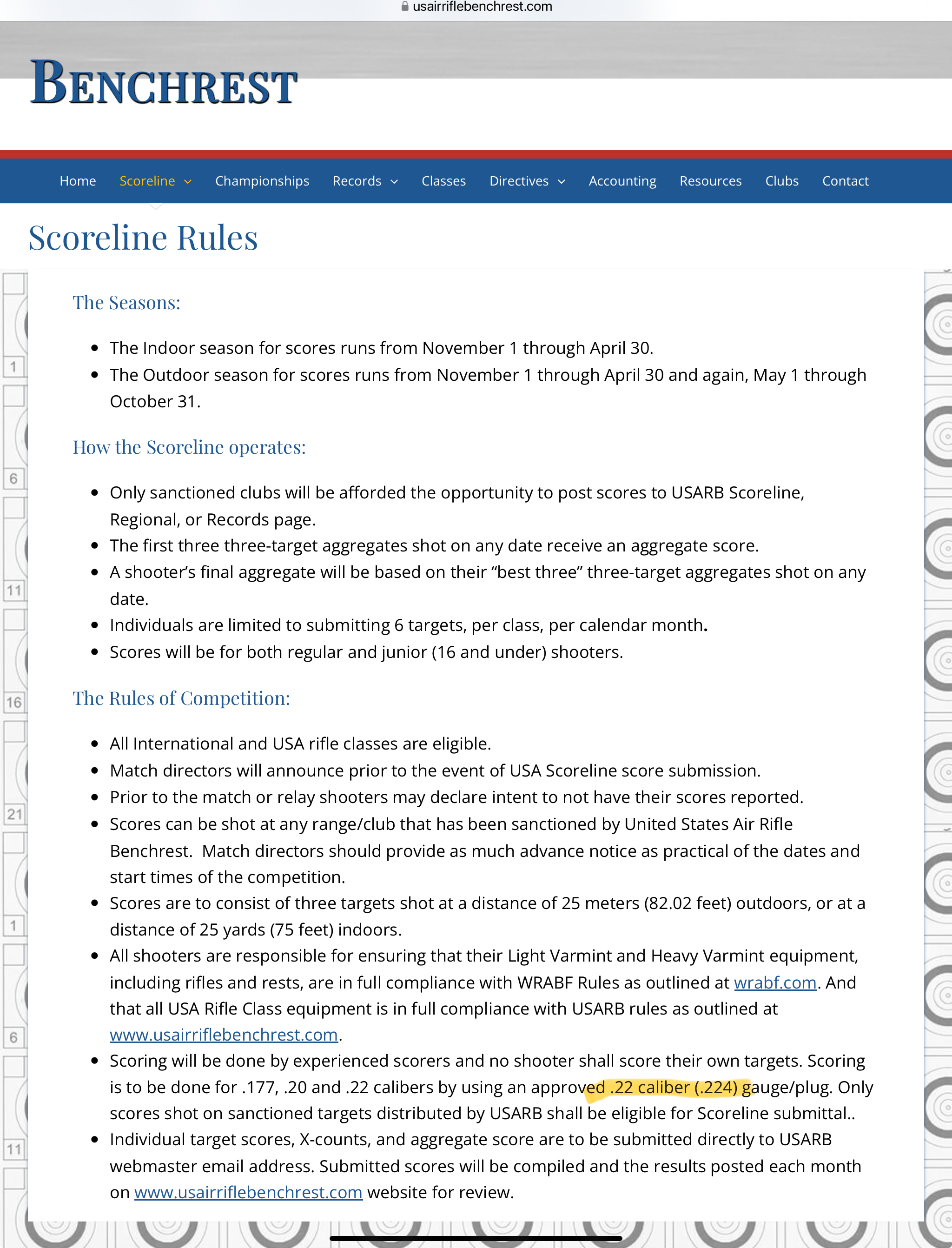

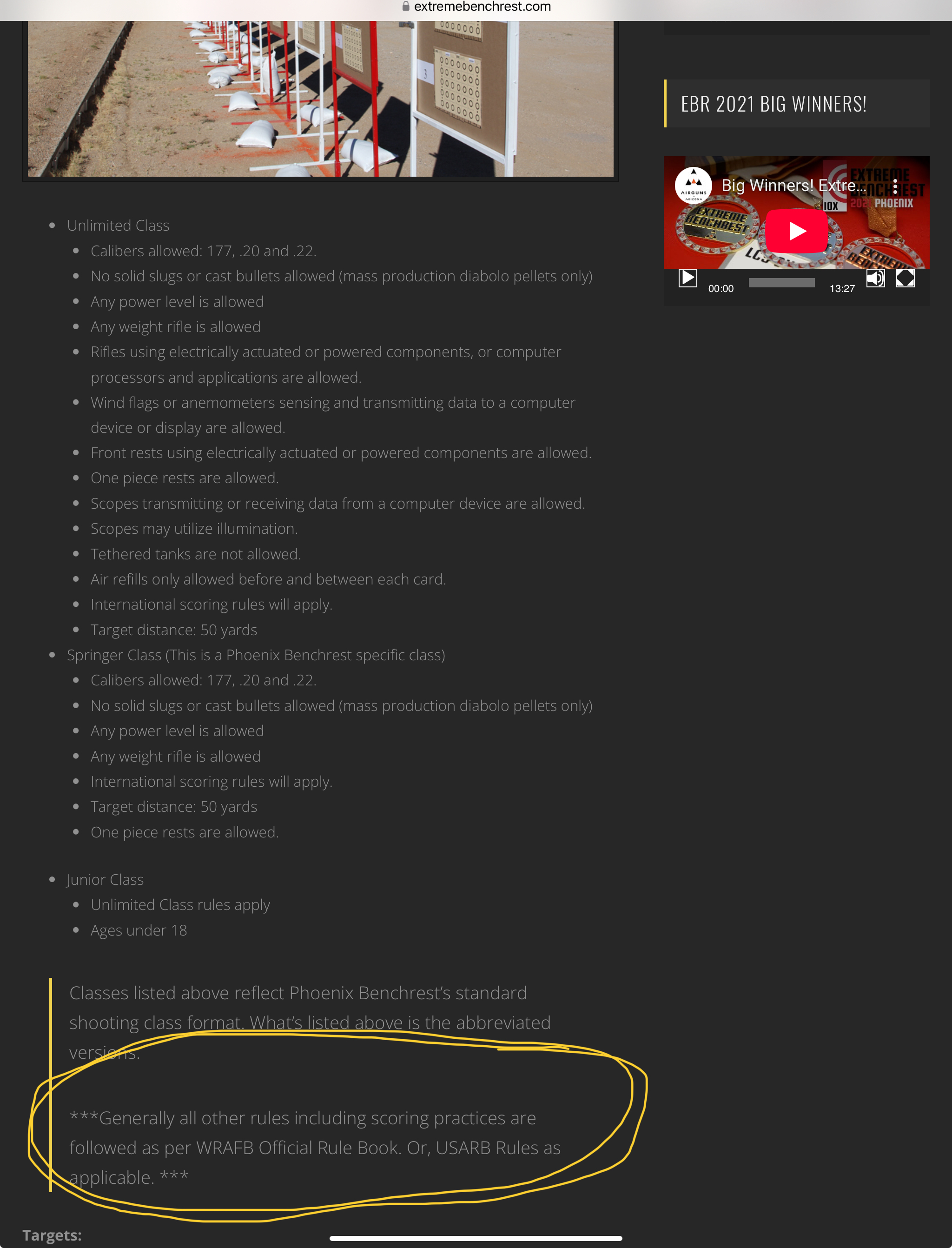

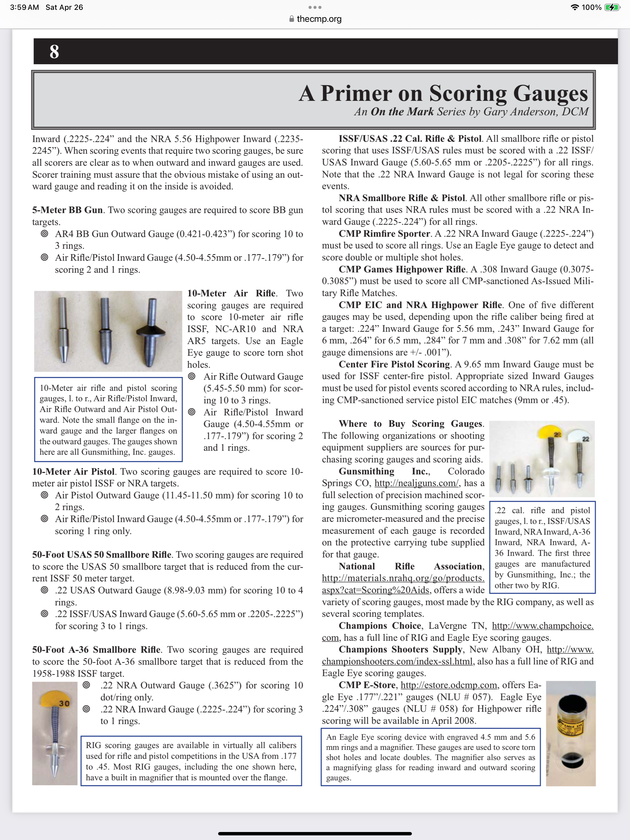

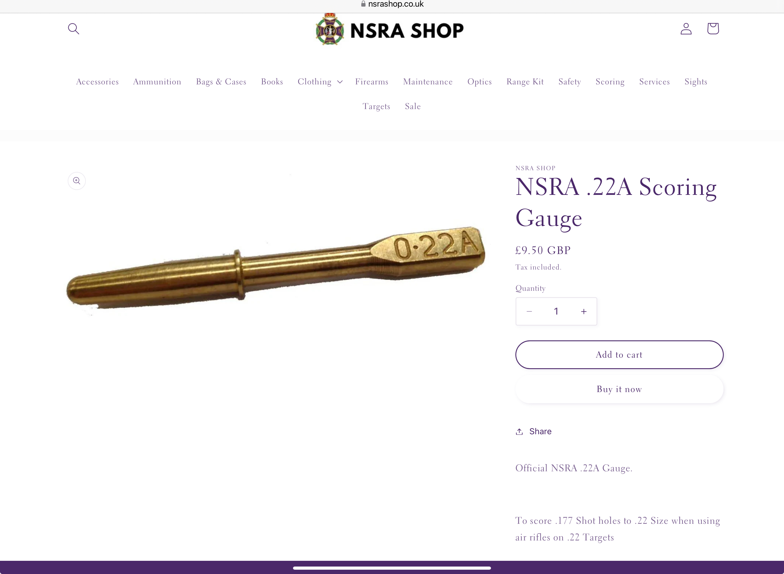

WRABF/ERABSF NSRA .22A scoring pulgs with a flange diameter of .224. As a “world standard”, we should all agree on one scoring plug diameter to make it “fair or equal” to all the shooters around the world when it comes to scoring. If your flange diameter is smaller than the normal/common E-Z plugs, then you are at a loss and at a disadvantage.
