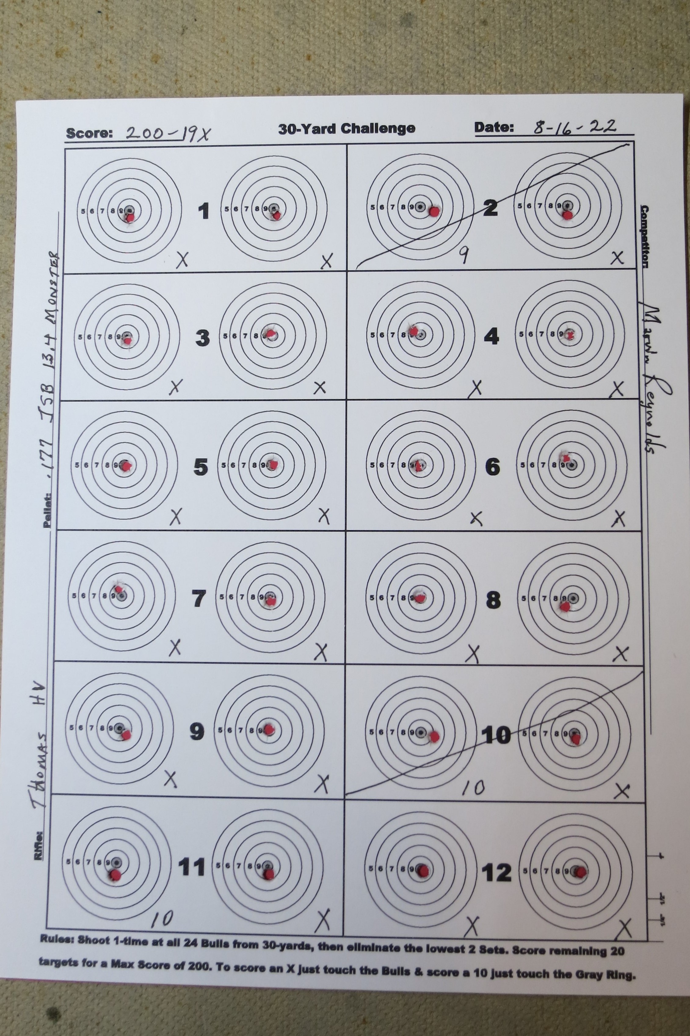

We finally received a reprieve from the intense heat and have enjoyed some very favorable shooting conditions which I was actually able to take advantage of.
The conditions for the target with the Thomas .177 shooting the 13.4 Monsters was approximately 3mph l to r and the temperature was 70 degrees.

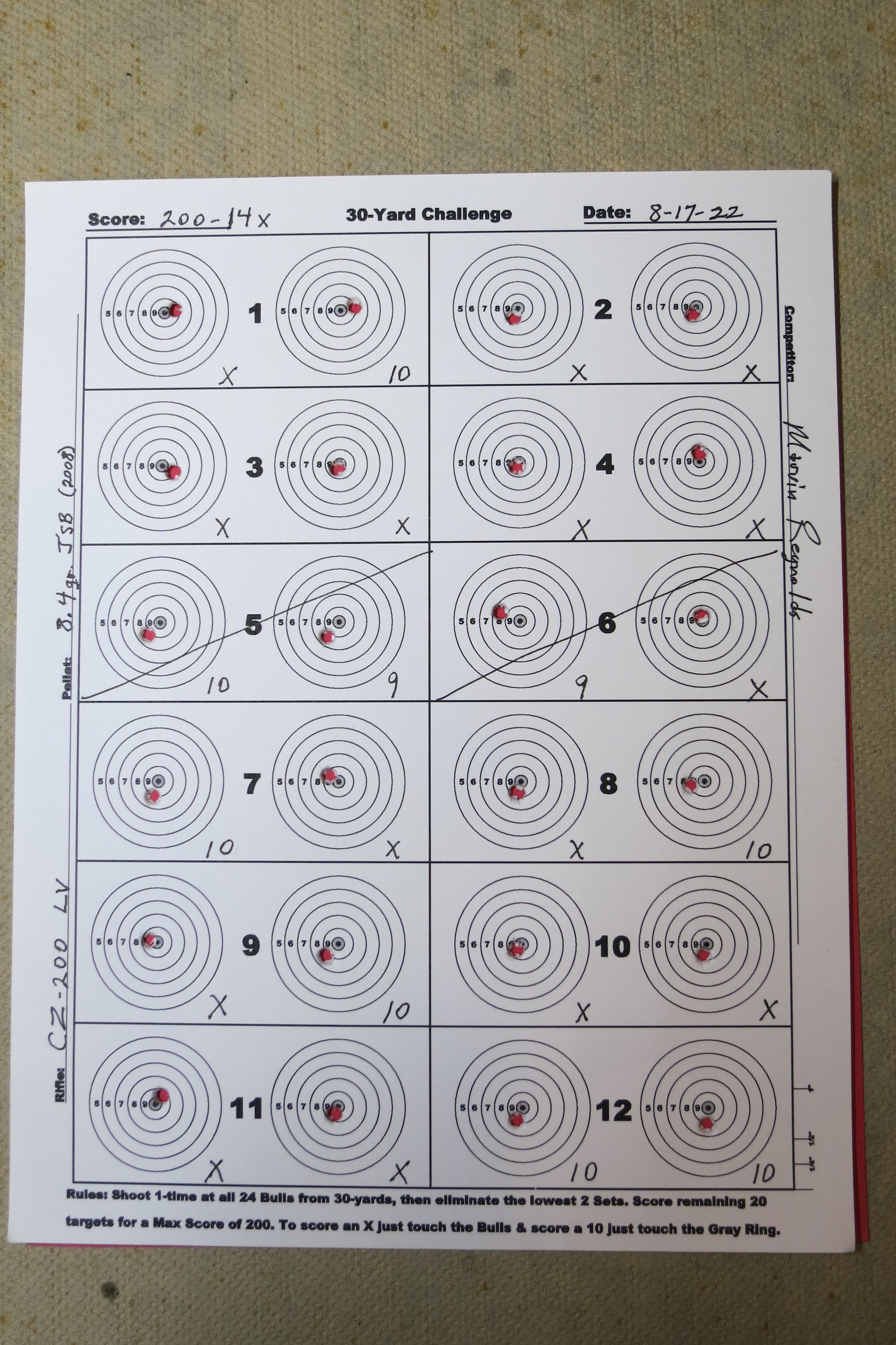

The second target is the very first target I have shot with the sub-$500.00 un-regulated .177 12 ft/lb CZ-200 using pellets from an unsorted tin of 2008 JSB's. I did have the gun tethered to a 30-minute tank with 1,800#'s in it. The tails on the wind flags were slightly moving from the very light left to right breeze. Shortly after retrieving and replacing the target my luck changed as the air literally stopped moving and my scores dropped two to eight points on the next four targets.

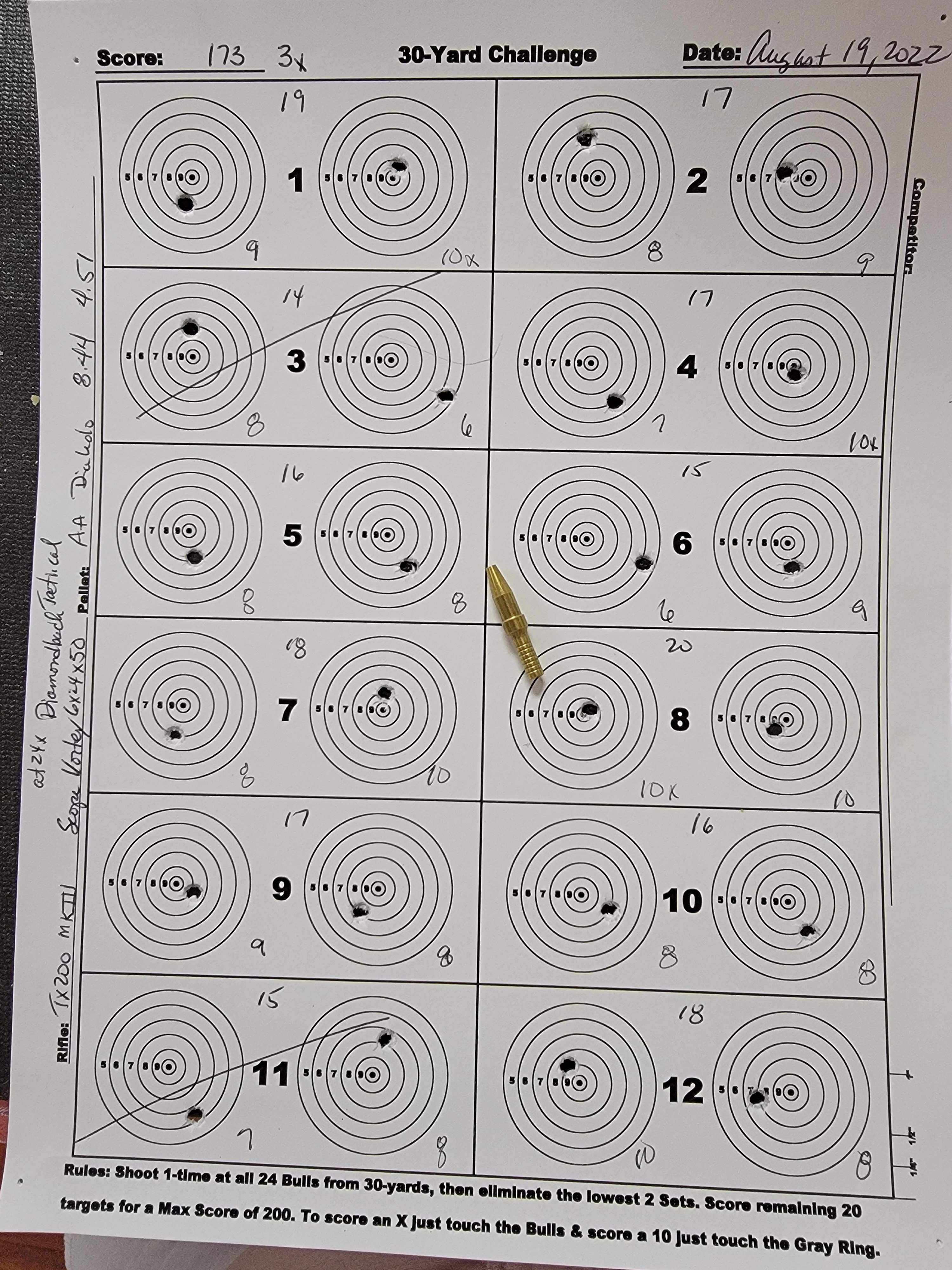

Ok. Shot a couple cards one was no better than previous using Zan. One is slightly better.
Score 173 with 3x. (Factory Springer)
TX 200 MkIII.
.177
AA Diabolo 8.4 with 4.51 head
Vortex Diamondback Tactical 6-24x50 set at x24
Temp 90F
Wind 0 to 5 intermittent from behind and left.
Front Rest Caldwell Rock BR with towels.
Rear Rest Protekor #13 on 1" board.
Wood Bench shaky and uncomfortable but not a hindering.
Scored using. 22 ARA plug.

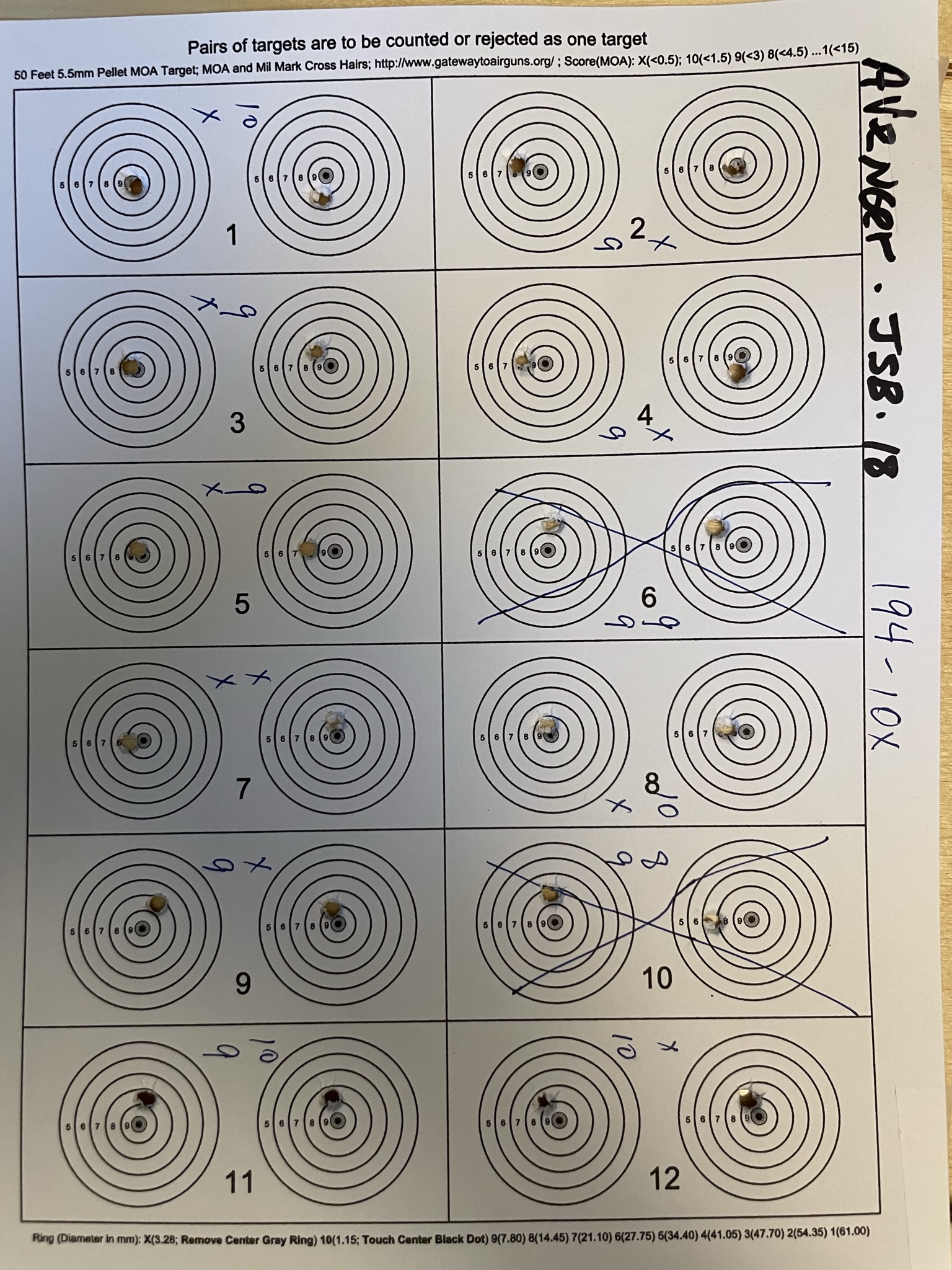

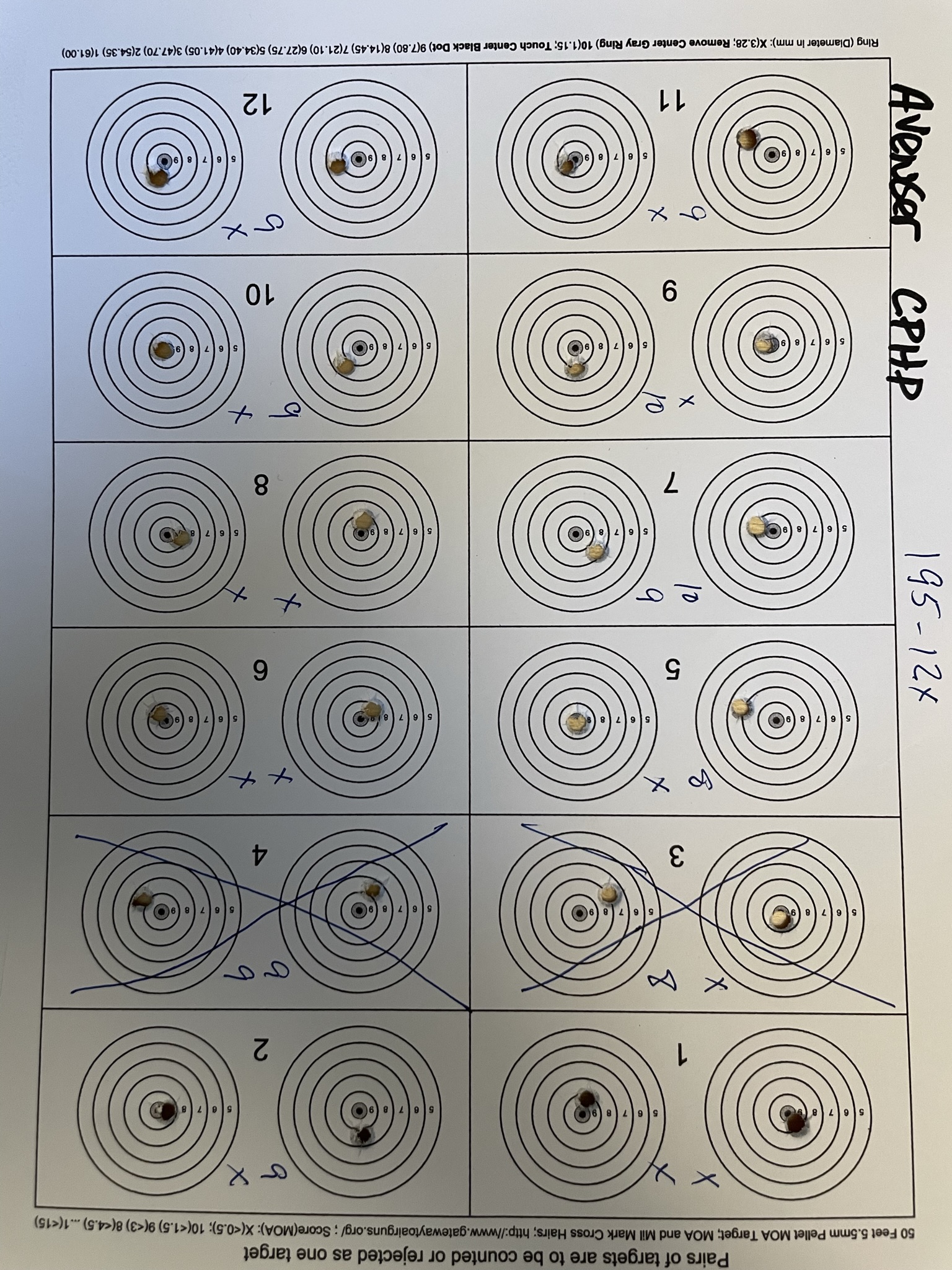

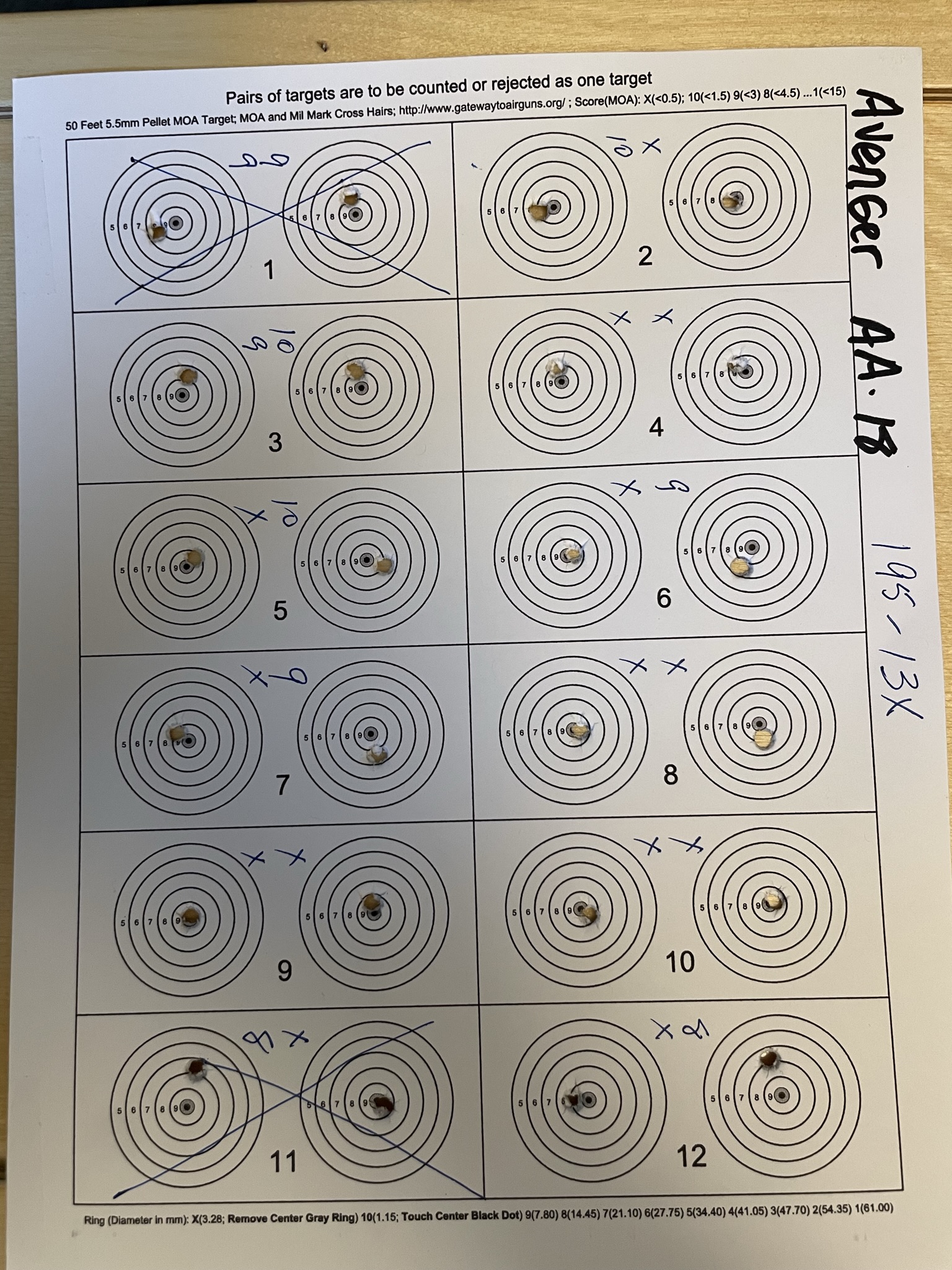

I was testing some pellets today in my .22 Air Venturi Avenger. Scope is an Athlon Talos SFP 6-24 on 20 power. First target with el cheapo Wally World Crosman’s Premier HP 14.3 pellets. Wind was 3-5 with gusts to 8 which was kicking my butt. The wind was especially unfriendly to the light weight CPHP pellets. This target is added wrong and it’s only 193.
next is JSB 18’s
Finally Air Arms 18’s.
All targets were shot off a $20 eBay bipod and Dollar Store / home made rear scrunch bag. This is my budget friendly rifle that continues to surprise me and bring smiles to my wrinkly face for the money invested.

You folks probably already thought this through. I am slow. Note this is based on my running my calipers so error is present.
A score of 200 indicates an average shot score of 10. This on average means best edge on all shots on average hit a .130" spot or smaller.
A score of 190 means an average shot score of 9. This on average means best edge of all shots hit a .303" spot.
A score of 170 has an average shot score of 8.5. This means all shots on average for best edge hit a .439" spot.
A score of 160 has an average shot score of 8. This means on average all shots had a best edge hit on a .575" spot.
A score of 150 has and average shot score of 7.5. This means on average the best edge hit a .705" spot.
Etc.
This put my poor old 173 with hitting a roughly .439" spot at 30 yards over 20 shots. I will take that for sure.
